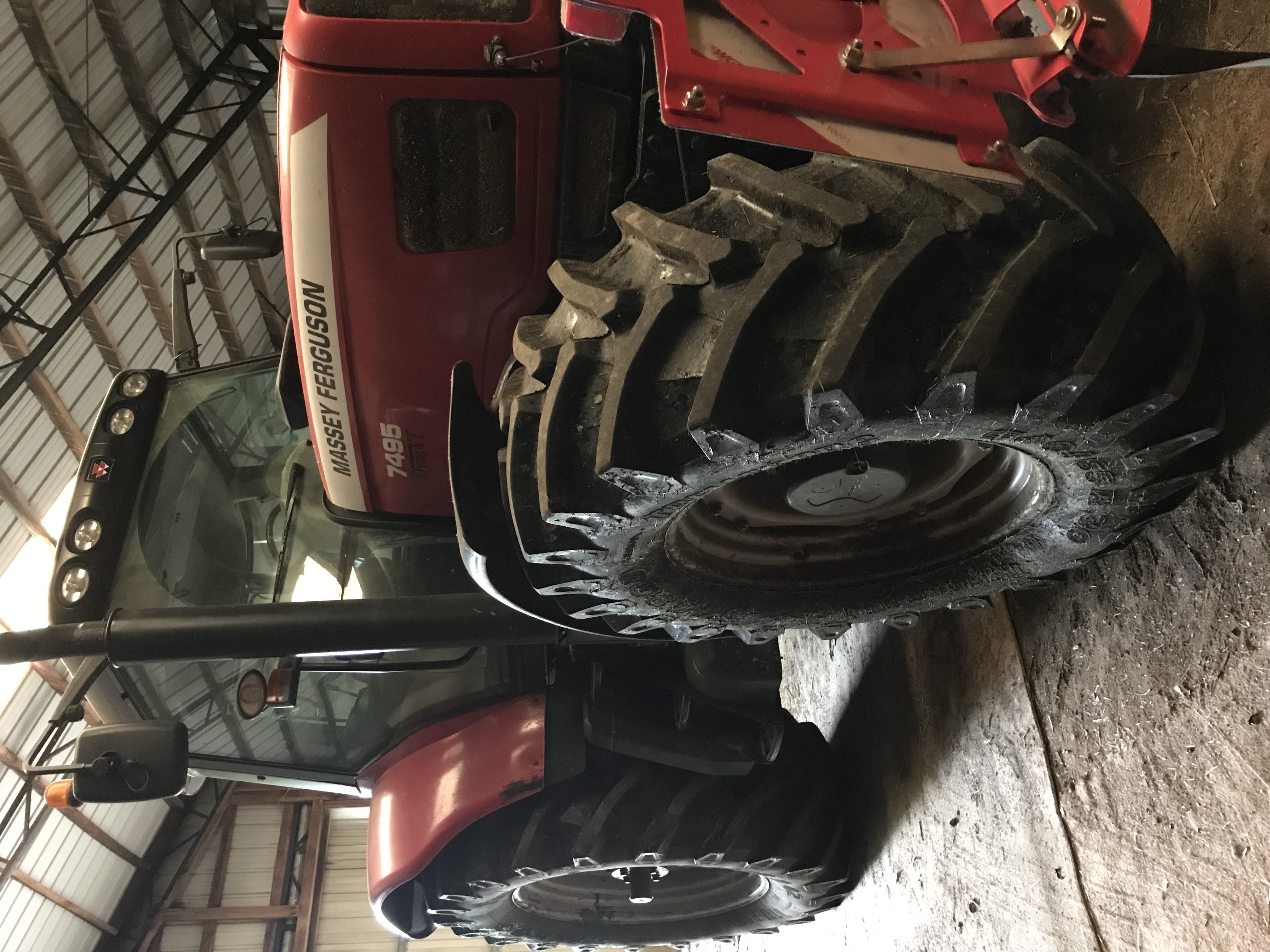

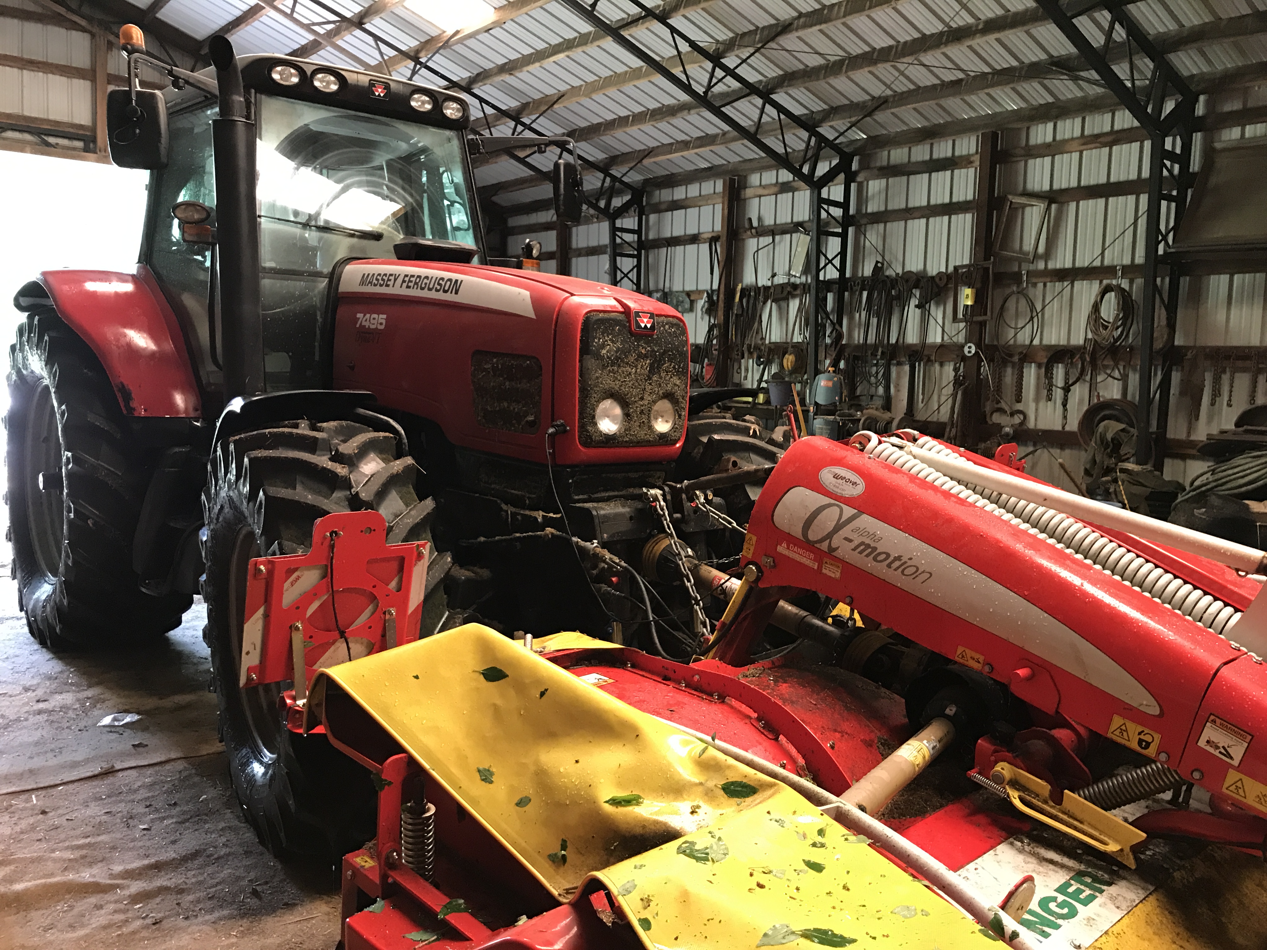

Well I just finally figured out a fuel filter mystery on my big Massey thats been driving me nuts for 2 years. I could never get the primary fuel filter cartridge to fit quite right. Never seemed to push on correctly and the lock ring wouldnt tighten. I was always lightly seeping a little Diesel fuel.
Well today, its solved. Previous owner lost the OE fuel pump. He replaced it with fuel pump from a newer version of mine and it takes a different fuel filter. When you buy a fuel pump, you get pump and new filter housing.
One more mystery solved on the Massey 7495. Shes ready to cut hay now. :thumbsup:
