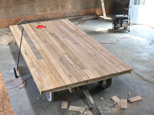

IMG_2423.jpg I put new beams and cross members on this Oliver 5003 3 ton running gear. I stretched it out 1 foot as well. The one front zerk would not take grease and the front end was really stiff. I tried one of those gadgets you fill with oil and then drive the oil into the zerk but it wouldnt work. So I ground the head off of a spare zerk i had and brazed it on a short tube that was threaded inside on the other end. I packed grease into this and started a bolt into the threads and then screwed the zerk end into where the zerk would go on the spindle assembly. By tightening that bolt it forced the grease into area that I couldnt grease before. I had to repack this a few times but got it freed up. It is planked out with rough sawn ash that I paid $6 a board for 1x6x16. I also greased all the bearings on my JD 963. This is a 5 ton gear - both good old wagons that will keep going for awhile yet.

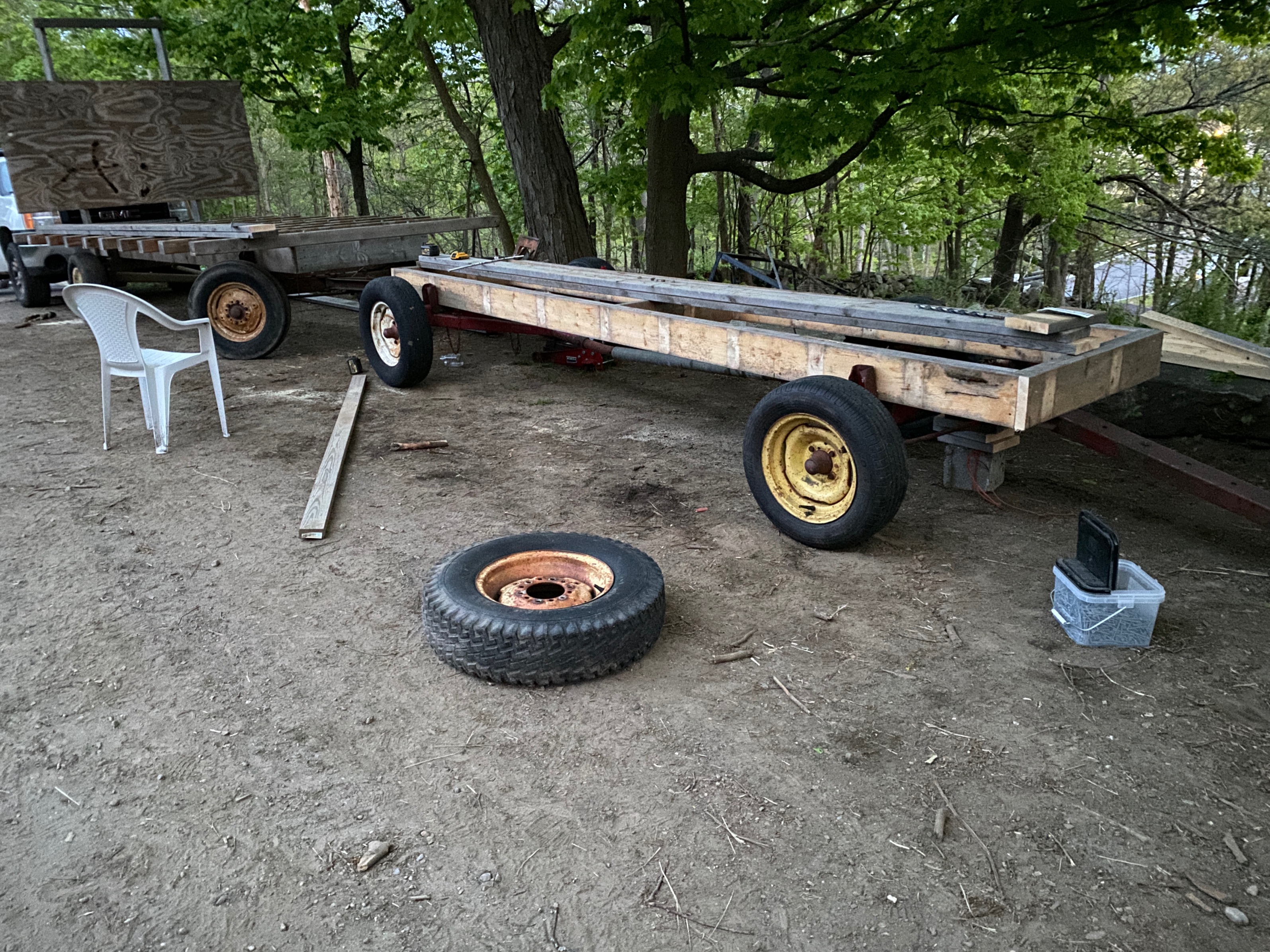

We’ve been working on some wagons and a Tedder. I’m going to need to pull out the baler and haybine soon to check that out IMG_0550.jpg
