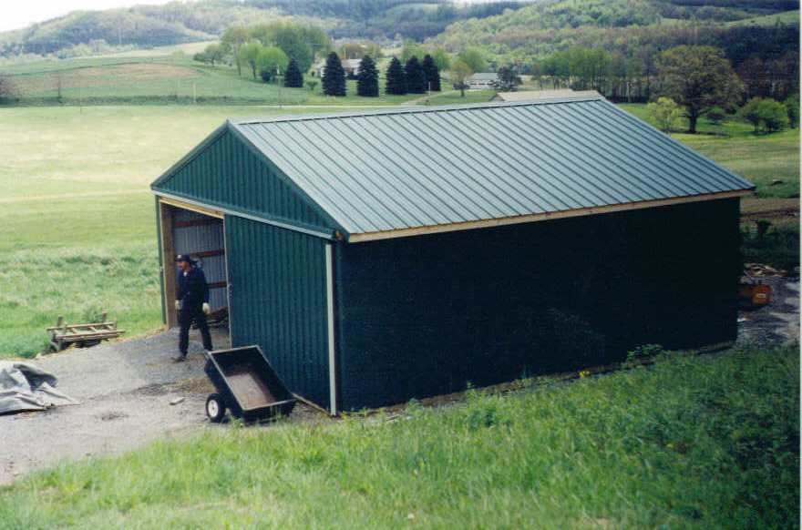

bryk,
I put up this pole barn last year, 24'x24',with a 2a limestone gravel floor for around $3500 total.(storage only)
The door is sliding 12' wide x 8' high(works very well and the tractor goes in without folding the ROPS).
If you can go bigger do it,I quickly ran out of room.

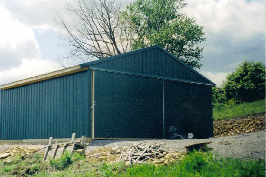

One more.

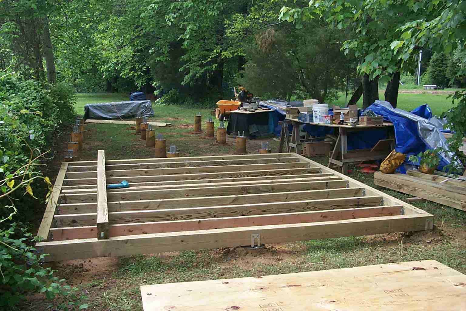

Sorry! My terminology wasn't precise. I should not have said
"beams" as I am simply talking floor joists. 4X4 floor joists and
rims are what I used on three sheds I built a couple summers
ago, for storing stuff. Picture of foundations attached. In this
picture, I am standing on one foundation (which has 3/4"
plywood down), the next shed has the joists in place, and the
third shed just has footers.
