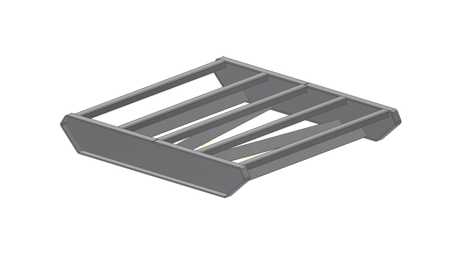

I was wondering, has anyone made or seen a land plane that mounts to the FEL forks instead of the 3 point? I ask because I'm looking at making one so I can use it on my tractor and my father can use it on his skid steer. it should be alot cheaper than store bought, you can change pressure (front to back) and simpler as it really only has the sides and blades.
Thoughts?

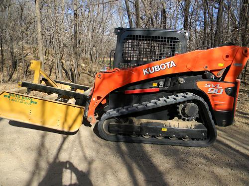

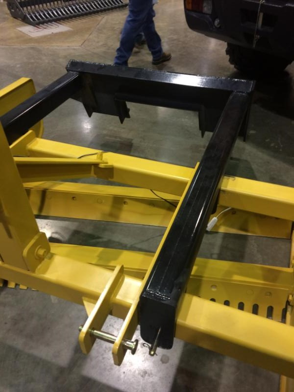

I guess you could put fork pockets on the land plane, similar to the way this one attaches:
View attachment 708984View attachment 708985
I have the John Deere style quick attach on the FEL which I actually like better than the skid steer attach (less moving parts)
They are standard forks (50" +/-) built the mask myself.
I was thinking just some bent straps along the top supports of the plane but I could just use wide rectangular tubing and weld it along the horizontal supports. I figured a chain with binder would hold the plane onto the forks for back dragging.
