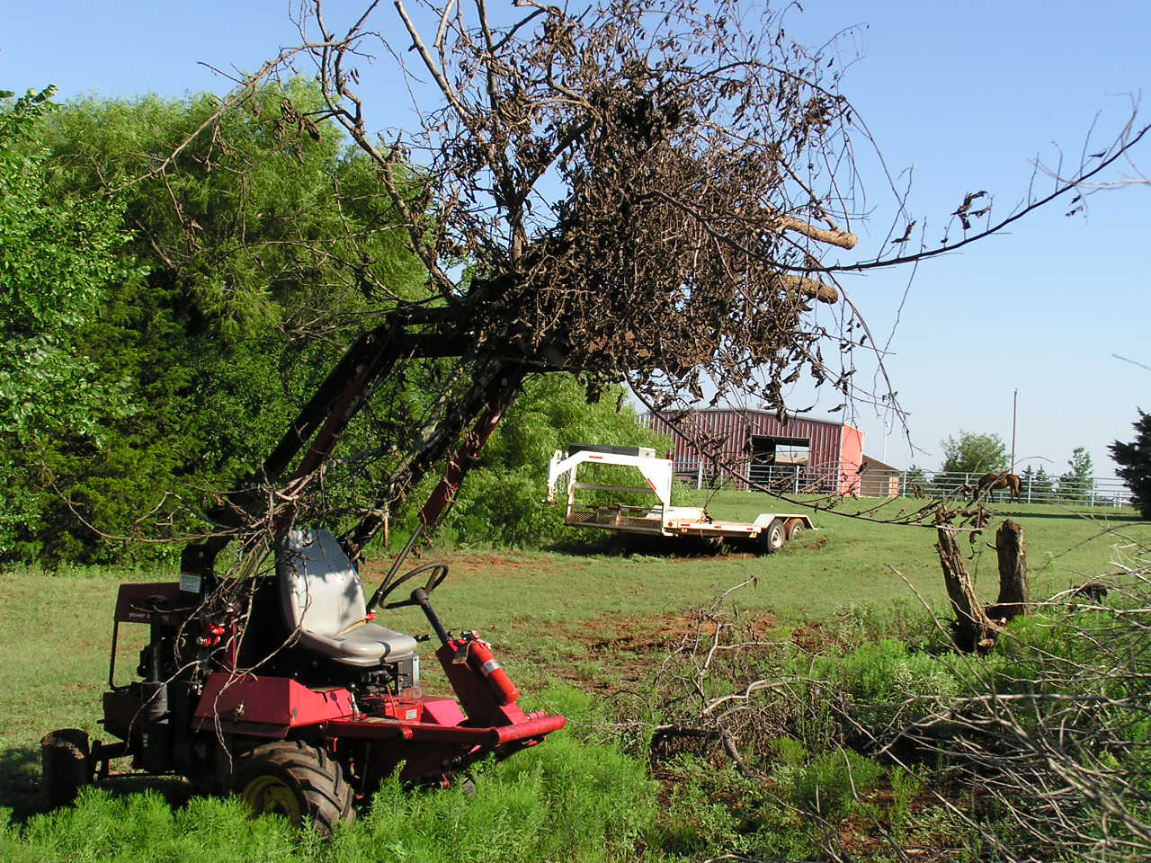

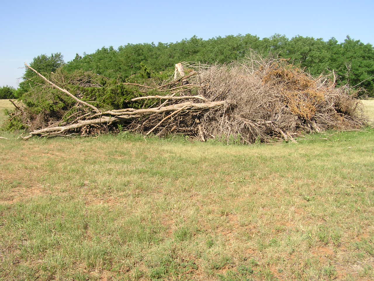

I have not done this but I'll bet you could move a huge pile of brush by just spearing into the lower part of it. Probably improved results if the pile has sat for a while.
It couldn't move this huge pile of brush, but it did make the huge pile of brush with the forks:

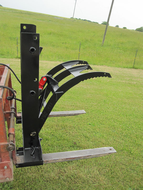

I just lift it out of the way when I need the forks alone.View attachment 612605
Do you have any more pictures of how the grapple is attached. I have often thought about building a grapple for my forks but they too have tall frame like yours and really couldn't see how I could make it work.

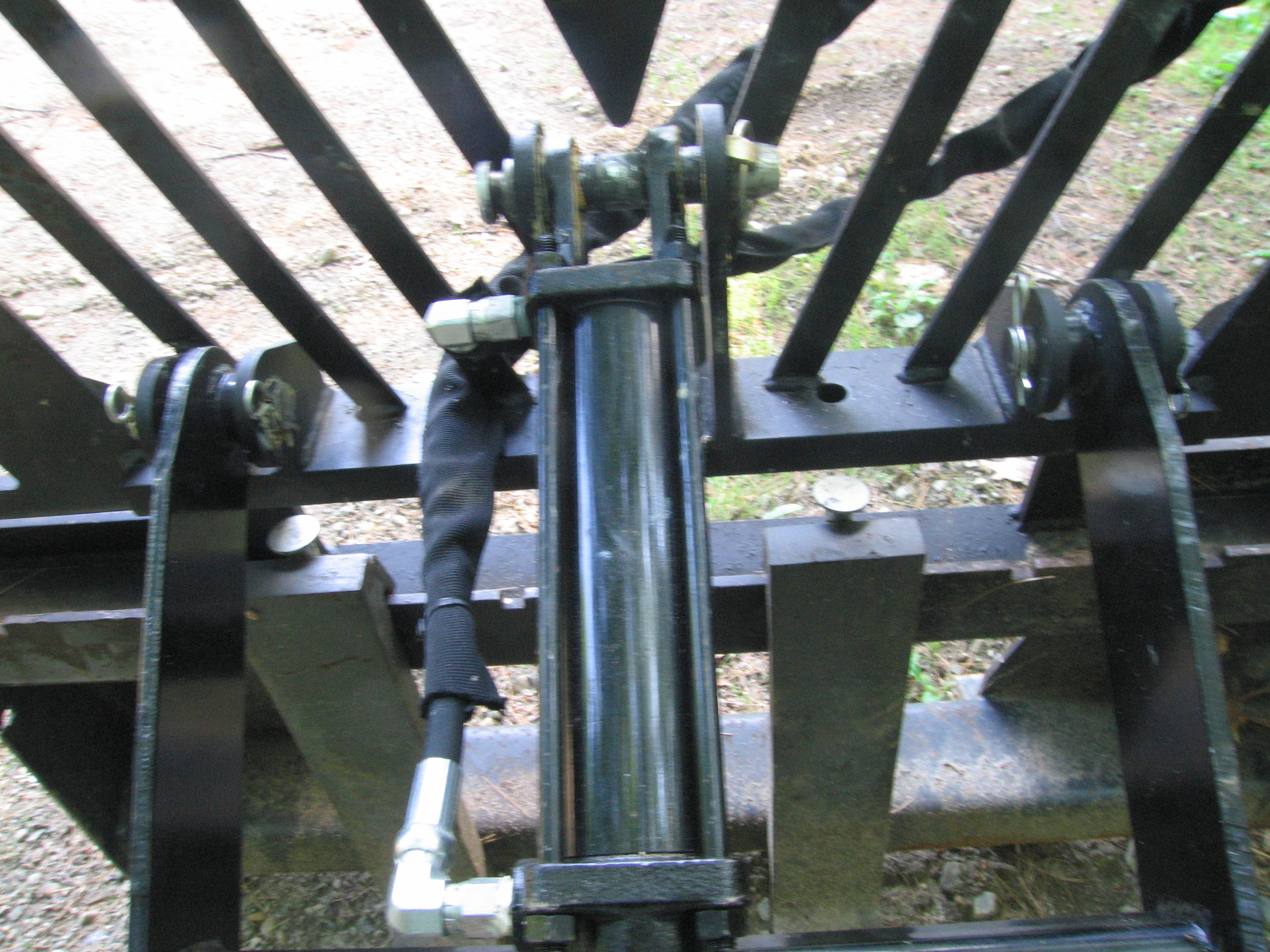

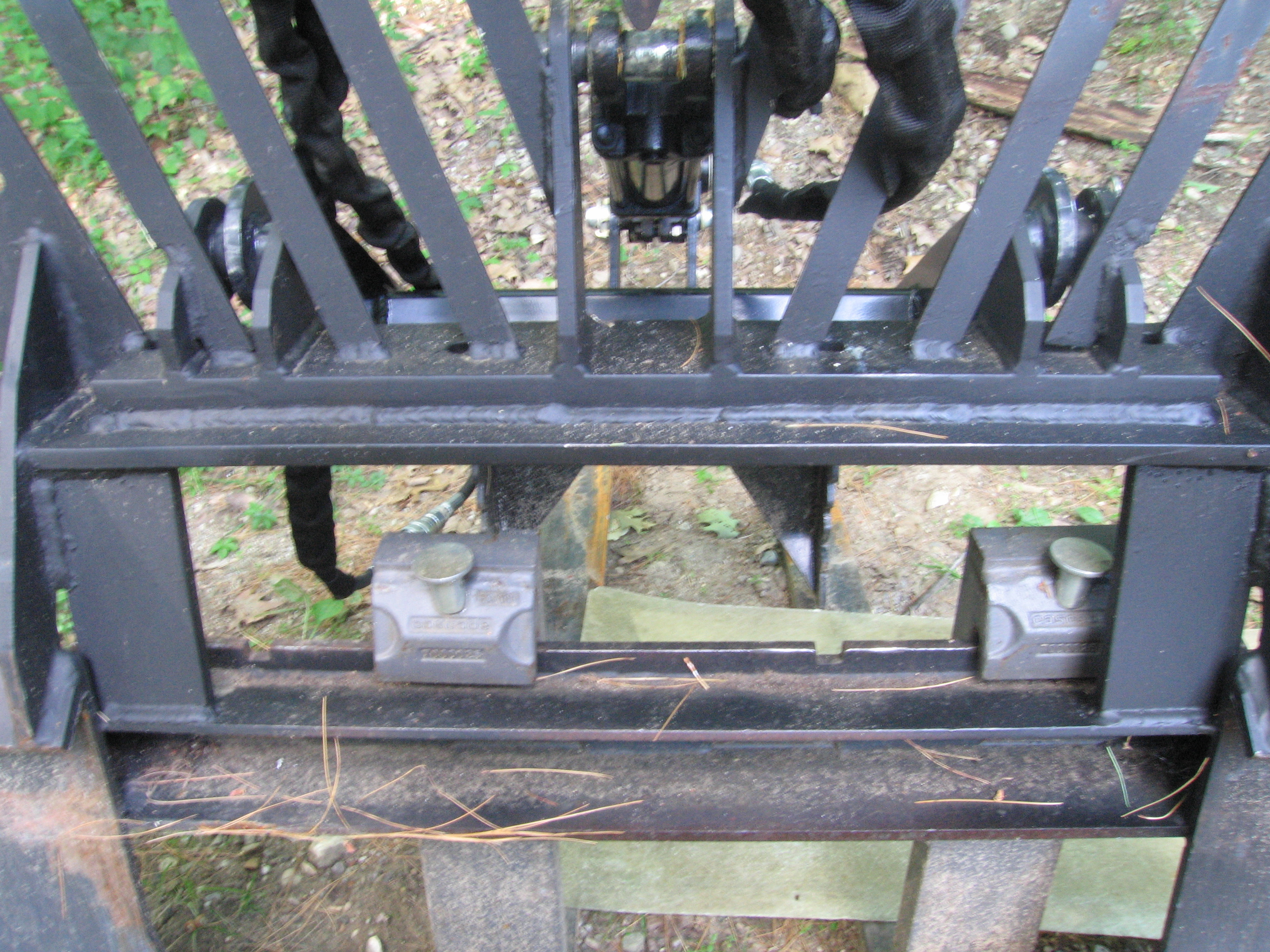

The mounting bar, supplied by the Thumb company, is welded into the backstop straps; my welder friend is an artist.
He also reinforced the top of the forks where he attached the mount.
That bar is available separately from the company so you can use one thumb on multiple attachments.f2.jpgf1.jpg
