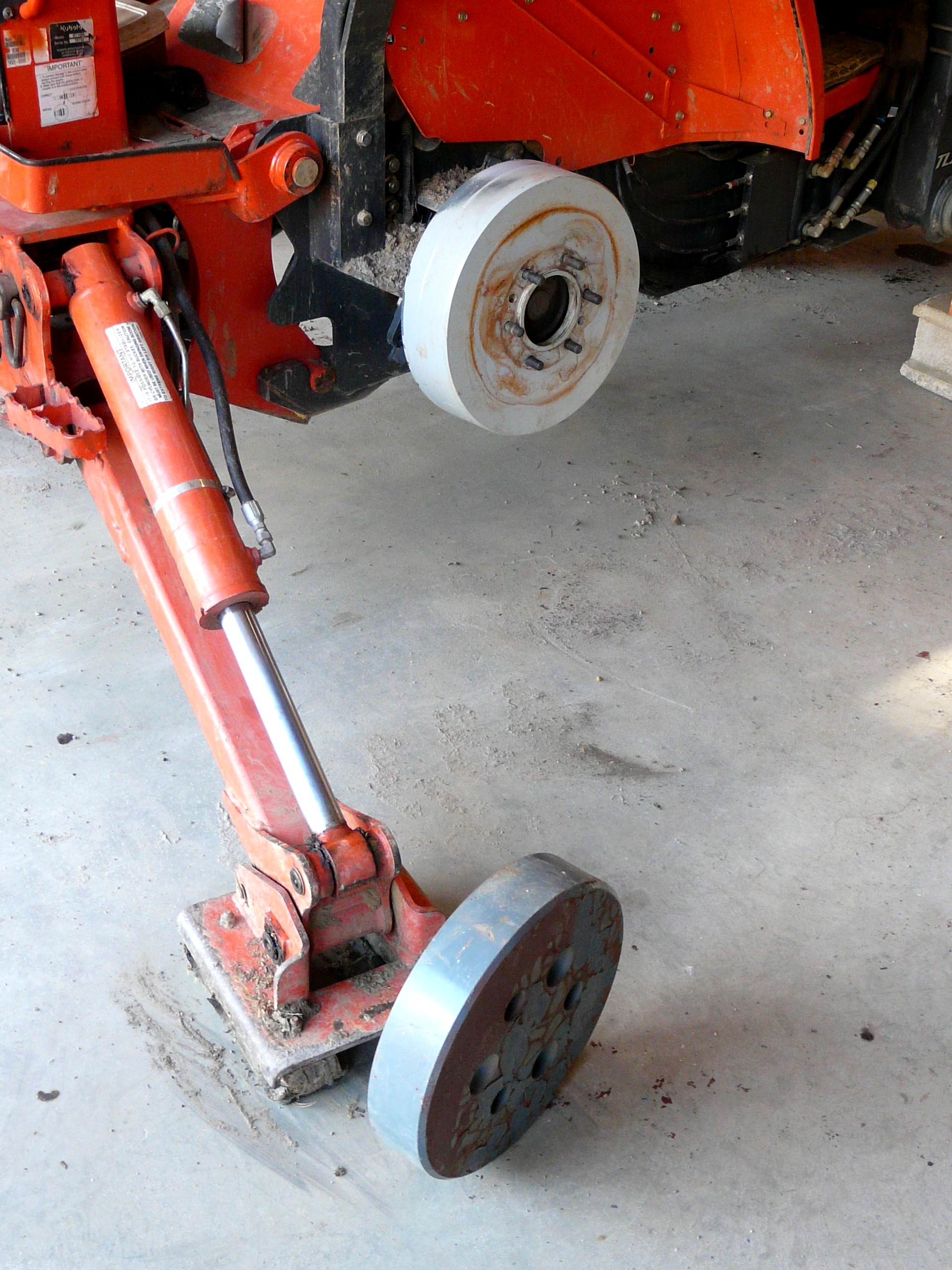

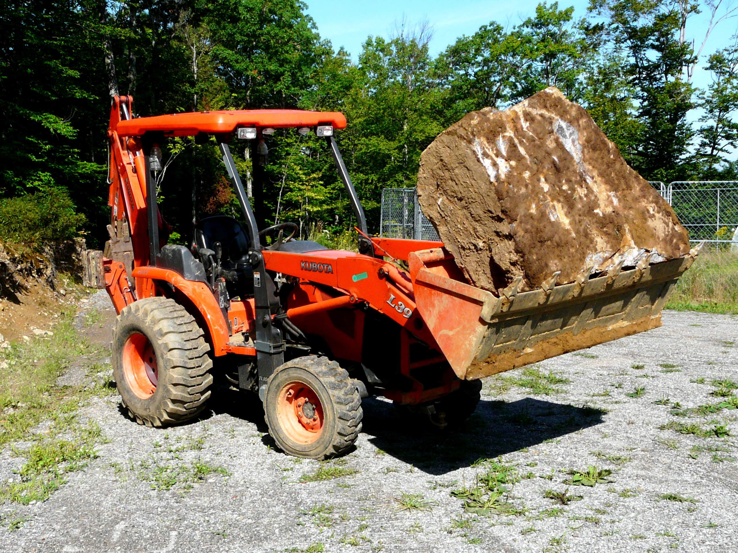

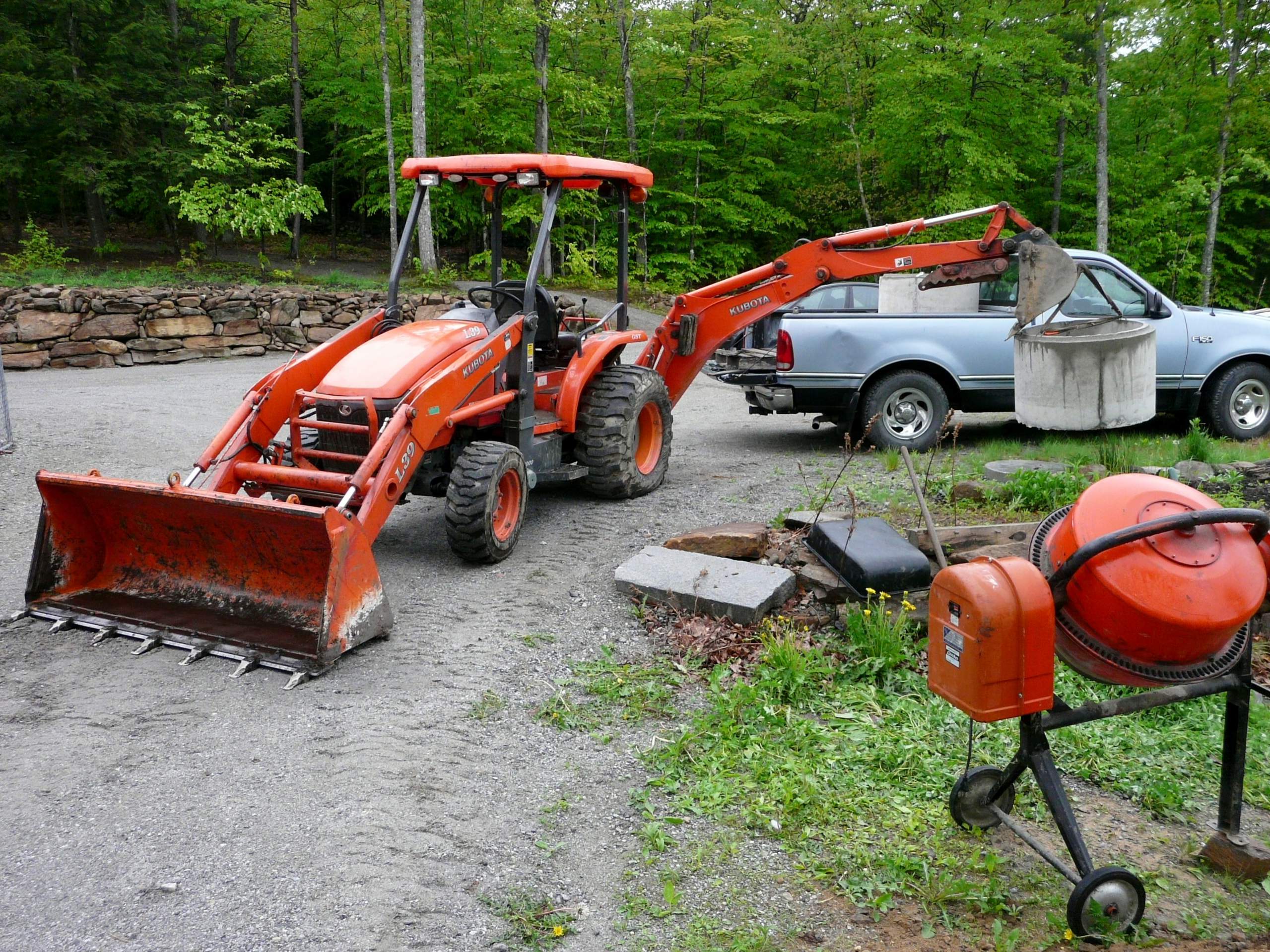

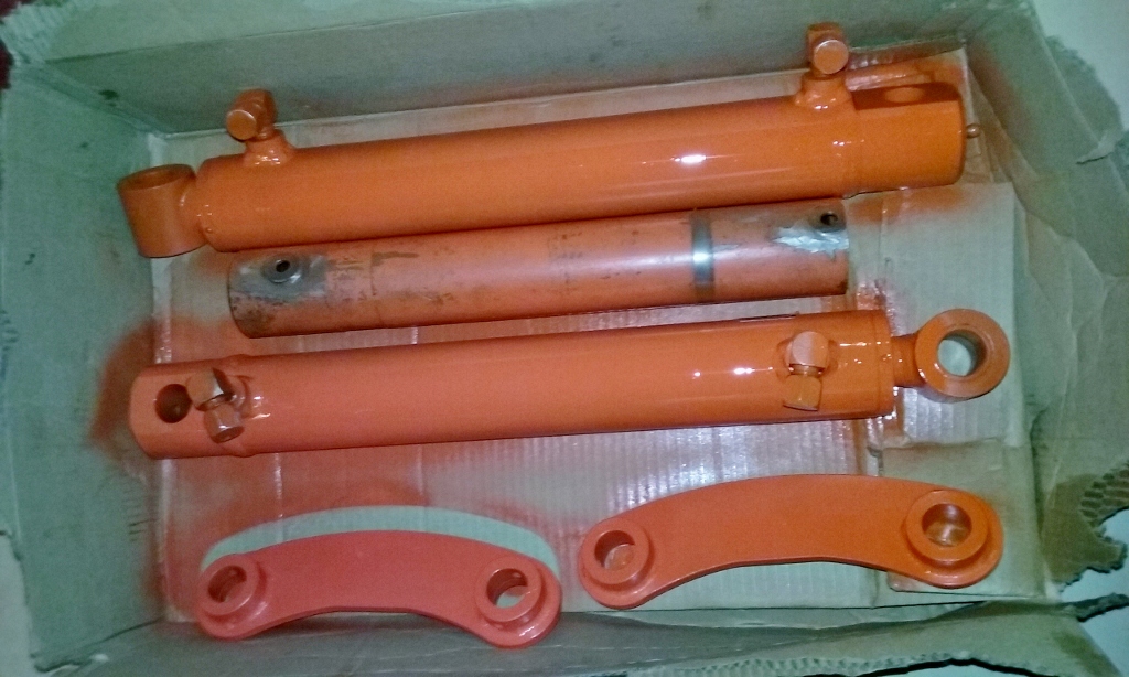

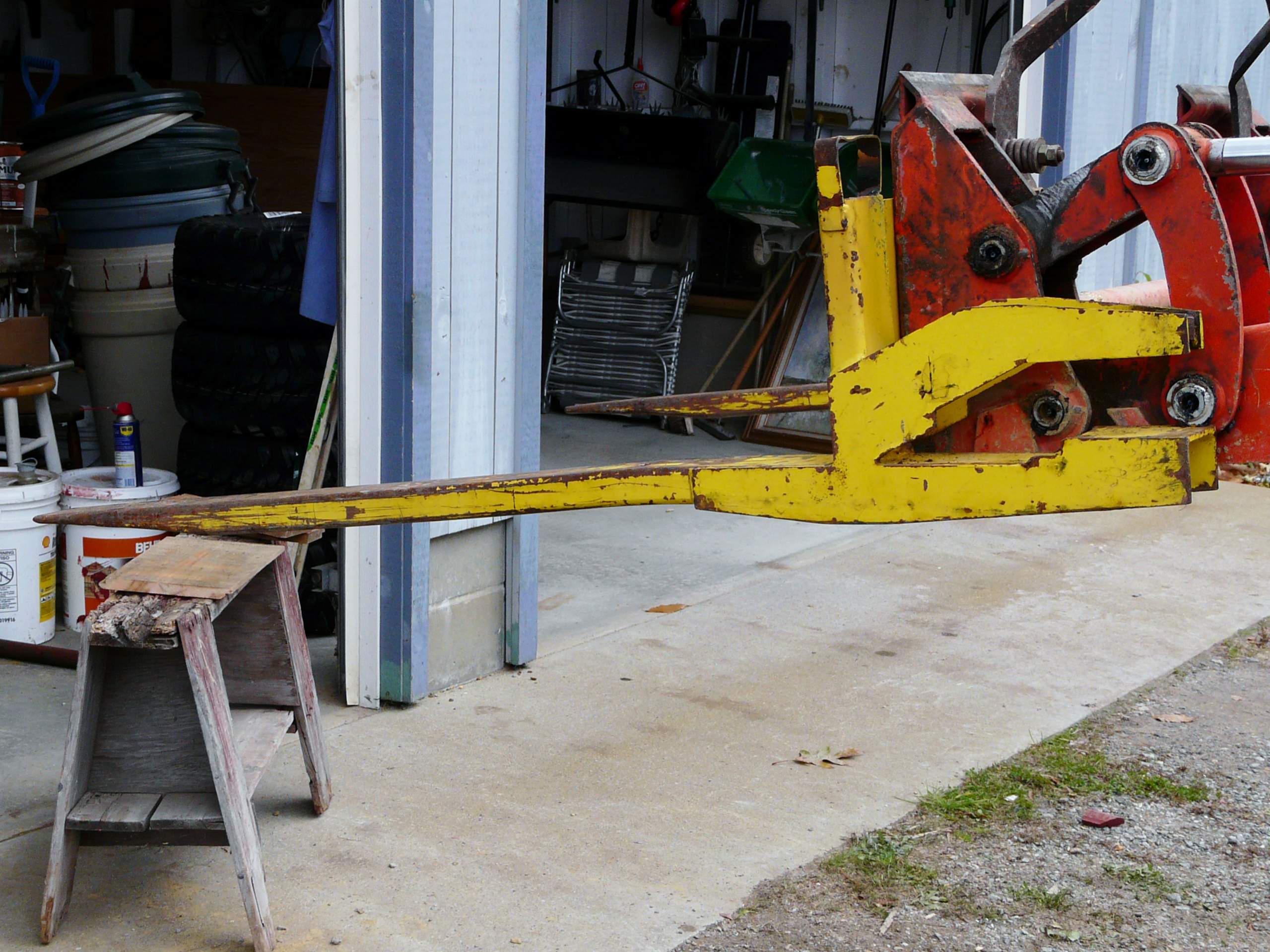

The Shed is around 1500 lbs, I tend to build them heavy using PT lumber, plus asphalt roof. I have 60mm Lift Cylinders and 65 mm curl Cylinders at more or less the L39 Max Rated Pressure of just under 3,000 Psi. Back when I lifted the larger heavier red metal roofed shed, it was with the OEM 55mm lift & 60mm curl cylinders, but pressures were set up !0% over the max of spec. I ended up bending the forks! I now actually get a bit more lift with the larger cylinders with pressures set per Kubota spec. than the original Kubota cylinders with the pump over spec, while being kinder to the hydraulic pumps. Kubota TLBs have a lot of hydraulic pump volume, so speed has not been effected greatly.
I need the wheel weights plus the BH for stability. Small tractor. but weighs 8,000 lbs with ballast.
B26/L39/L45/L47/L48/M59 & M62 are a different Breed of Kubota.
