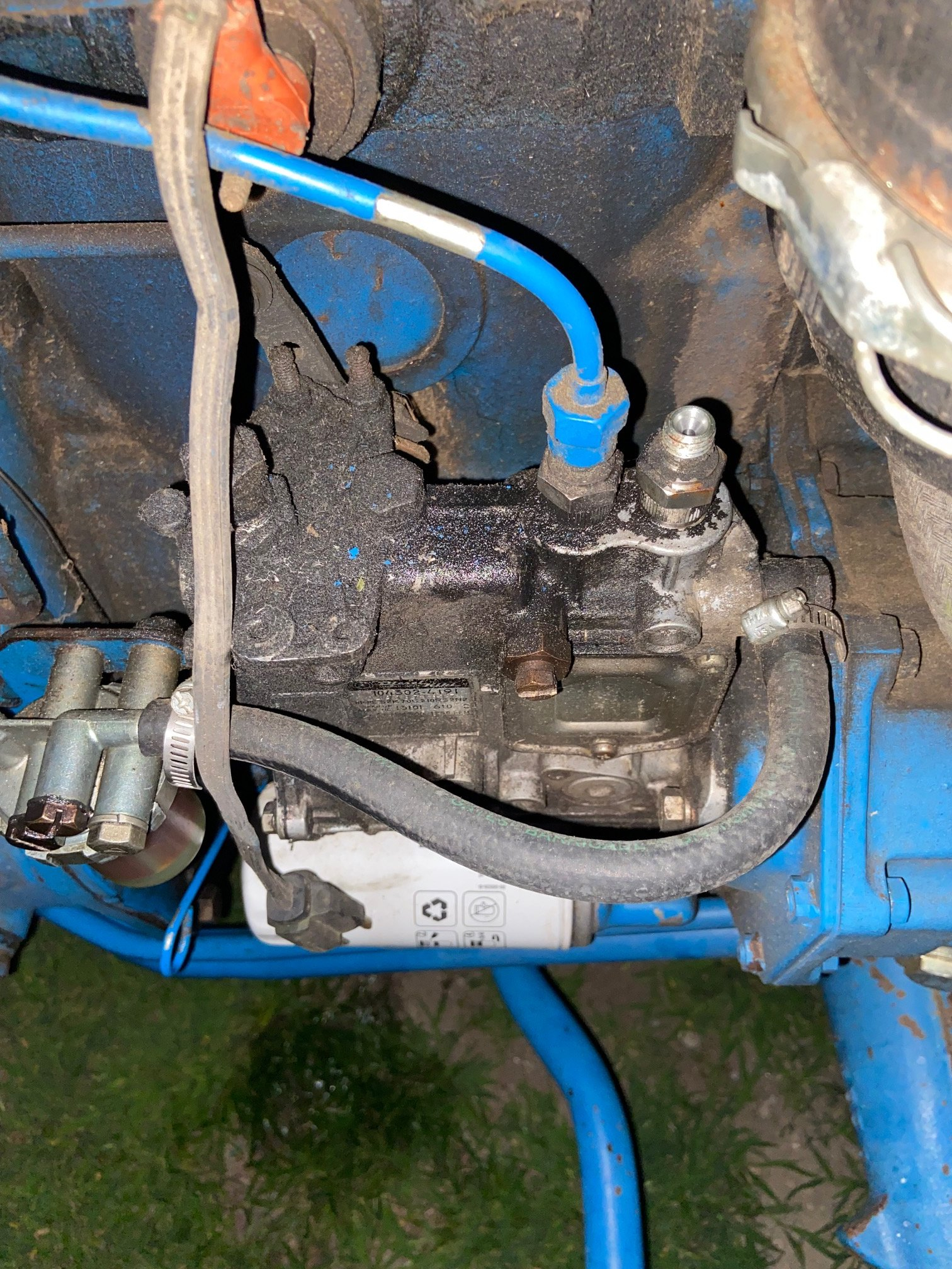

I do not believe I have changed this oil, in the injector pump. But, I do think I may be onto the issue with my 1700: I checked the fuel filter, even though I just put a new one in about 15 hours ago, the plastic cup around it was cloudy and when I took it off, there was a fair amount of crap at the bottom. Enough dirt to fill a penny if it was empty, if that makes sense. So I cleaned the cup, got a new filter and swapped. Didn't want to start, so I bled the air out of the screws. Still no start, so I bled at the injector inlets to the cylinder - and (as a faced the engine) the fuel line on the left seeped a little fuel out, but, the cylinder/fuel line on the right did not. I tightened the left one and then removed the ~12" fuel line on the right. I blew threw it and, while it took a hefty exhale (which I think makes sense because of the small diameter of that fuel line, I believe it's clear. When I hit the key to try and start/pump fuel, no fuel came up from where I just removed that `12" fuel line - so it must be gummed up between bleed screws and fuel line (see pic - is this the governor??).

it is passed my bed time but watching Barcelona-Real Madrid Now. but, quickly here, Governor is internal to the injector, you cannot see it from outside. if you take the back plat eof the injector then you can see if.it is directly attache to a can shaft that rotates. the lobes on the cam shaft reciprocate two small piston and with right valving it suck fuel and then injects it causing a lot of pressure and very little flow (fuel flow). if you have a air trapped there in the line it keeps compresses the air without pumping fuel. just remember air is compressible but not liquid fuel. The injector need to be bled as close as you can to actual injector. It would take a while for the fuel to fill and empty pipe as voulume of flow is low. I am not sure if yiu completely bled the air out. I had to do it several times in the last 20 years due to running out of diesel and I know the voulume of fuel is very small and is fuel pump is pulsating and sending very little fuel next to the injector anytime I bled air out of my 1700.

Has happened with my Dodge, 1992 Cummins D250. I simply loosen the six fuel connectors at the injectors (with a 17mm crow-foot) and bleed by cranking until fuel squirts all over the engine compartment. Then I tighten the connectors and it starts right up.
   / What does "oil - low pressure" light mean when it just barely starts coming on? #30
for sure and the key is right at the injector and long enough to get all the air out. Now here with 1700, you got only two injectors to deal with.
