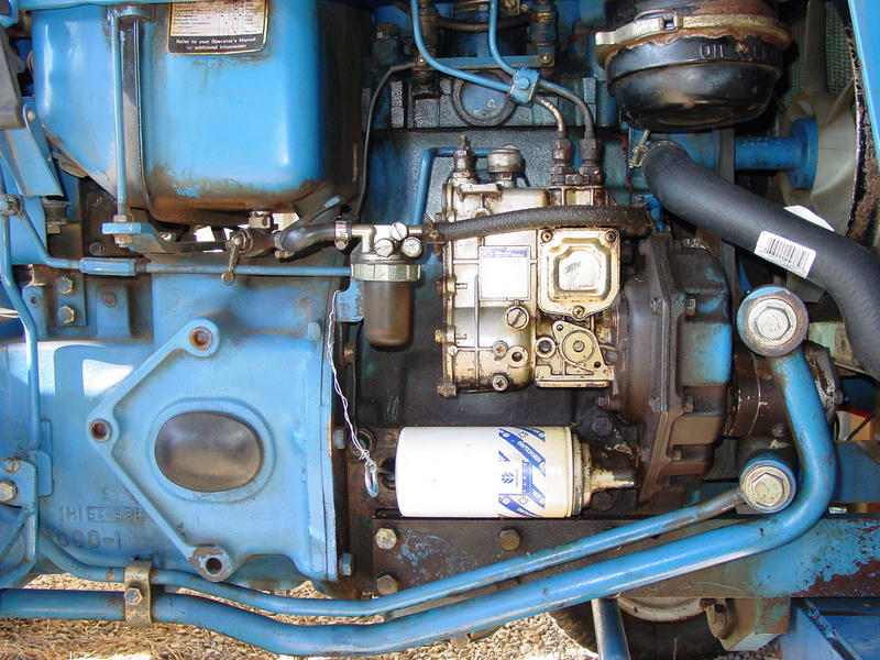

Sorry to have to ask but where is the Sending Unit on my ol' 1700?
   / What does "oil - low pressure" light mean when it just barely starts coming on? #62
Here ya go.

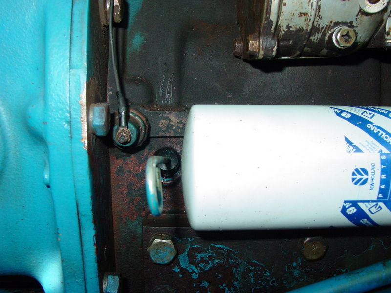

Oil pressure sender unit is on the right side next to the oil dip stick.
a close up.

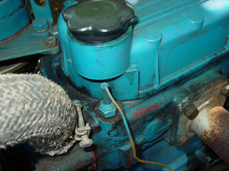

Temp sending unit is on the left side on top left corner below the oil filler cap. That's just for your future reference.
