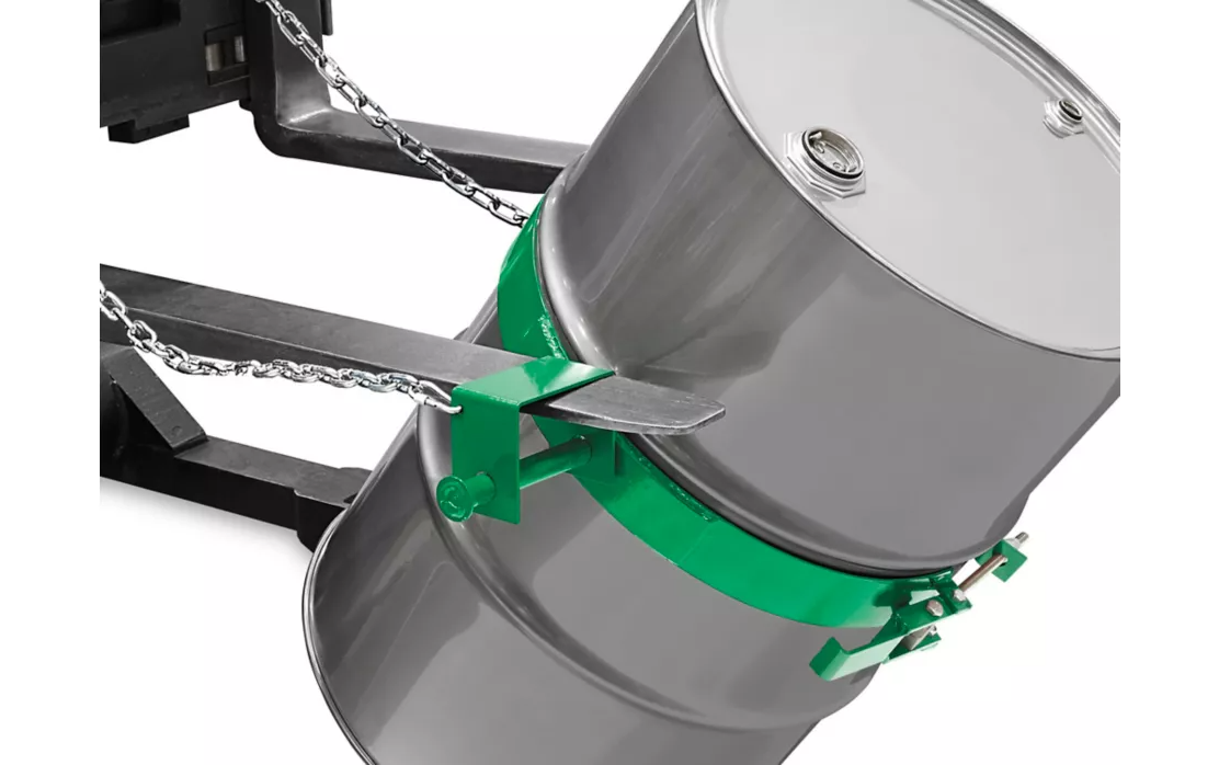

If I go back to burning coal, I'll likely pic up one of these pivoting drum slings:
That way, I can dump the cans into the spreader with the forks.
