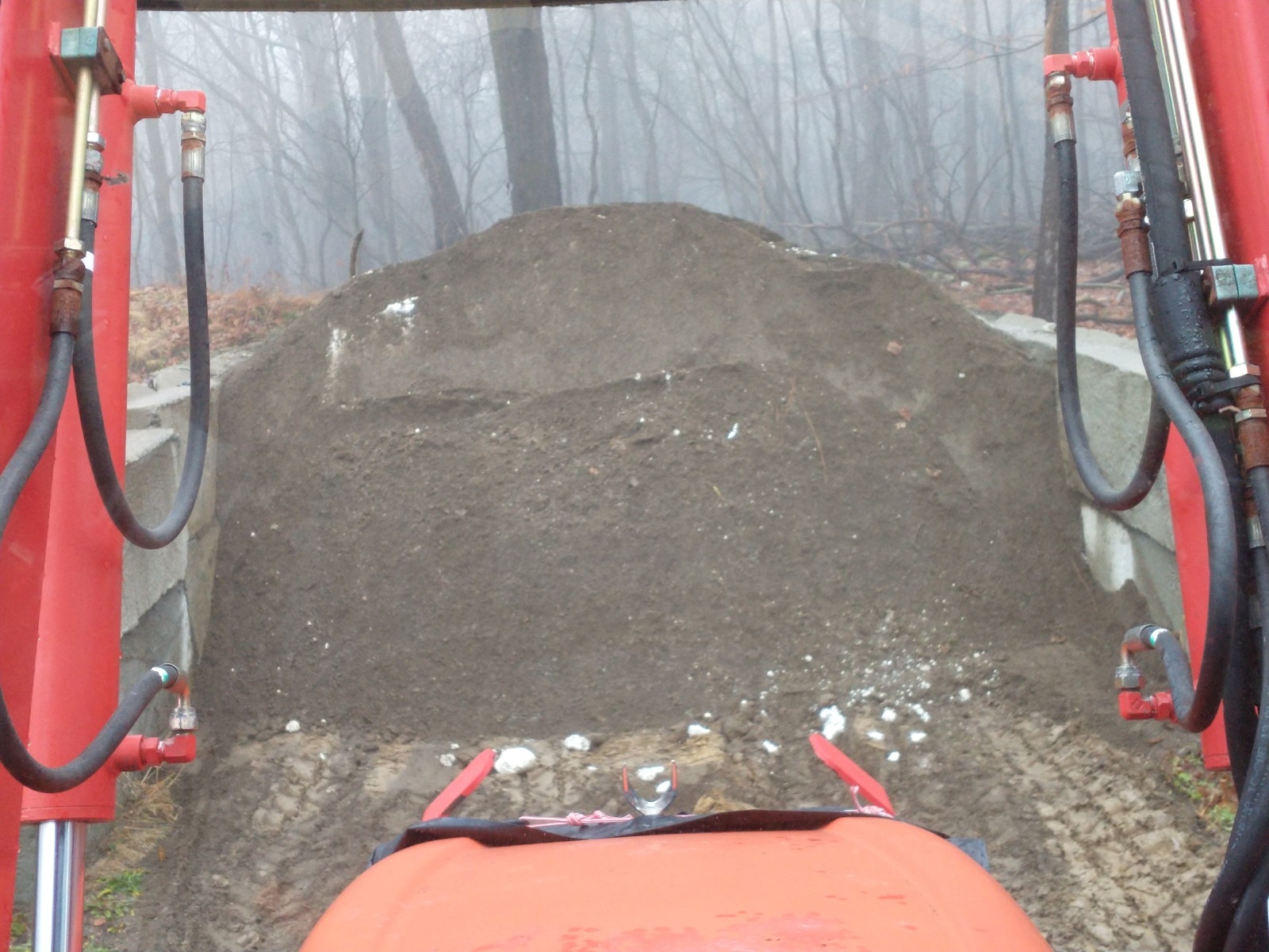

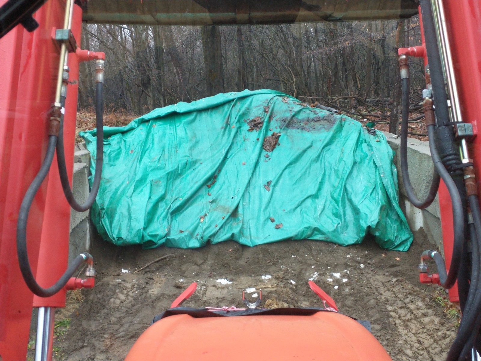

I have an actual sander that I use and a large sand pile. I hadn't had to sand much the last few years and I neglected to prep my sand pile and sander this fall so the rain has leached the salt out of the outer layer of sand and it has froze a foot or further into the pile. So this winter I've been scrapping at the face of it with the loader bucket and salting the face, actually used an 80# bag of calcium flake to try and pull some of the frost out and put a new tarp on it just the other day.
Most years; piled up and tarped ready to be used. Screwed up this year and didn't get it ready

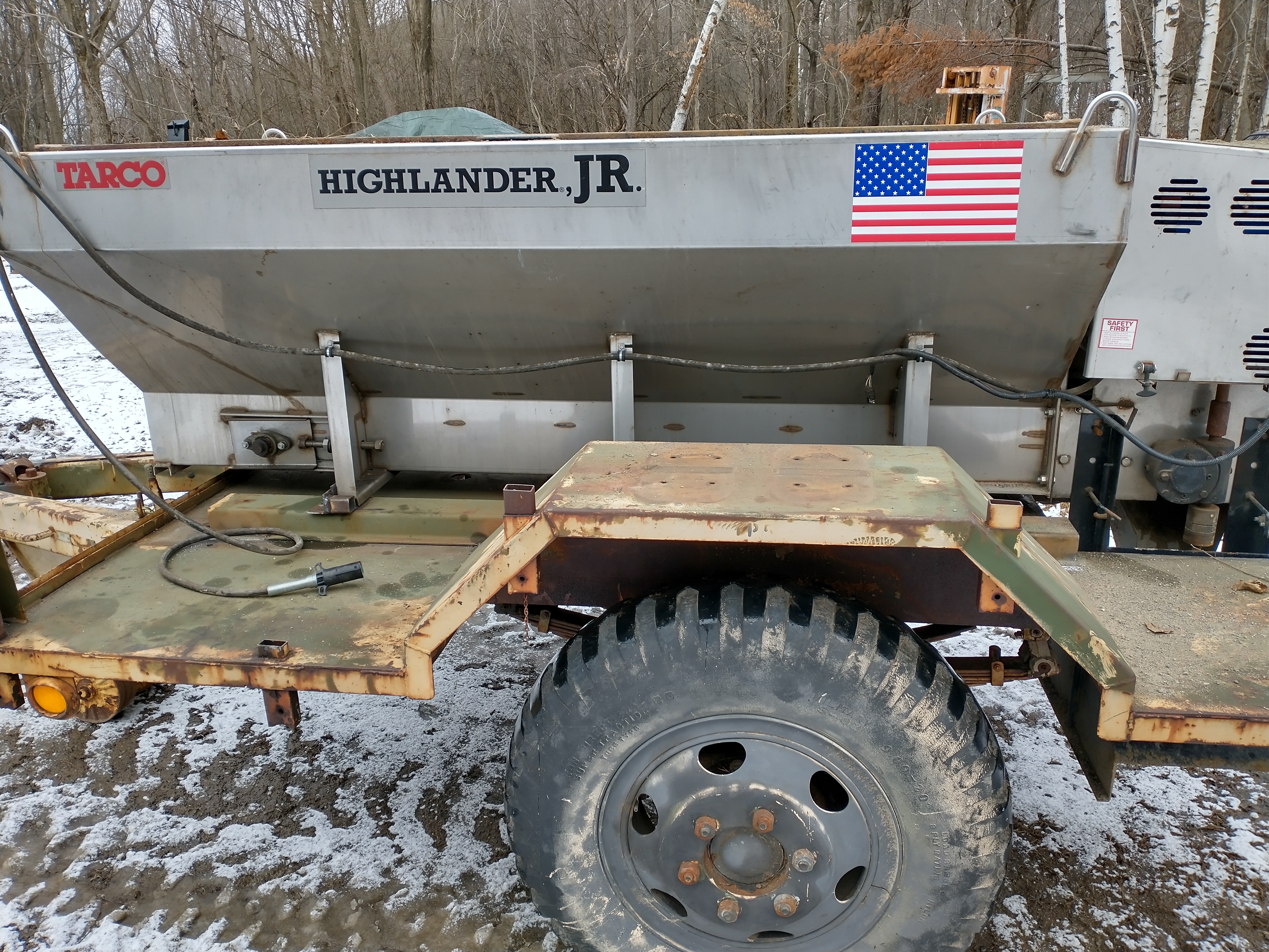

Sander mounted on a trailer to use behind the tractor

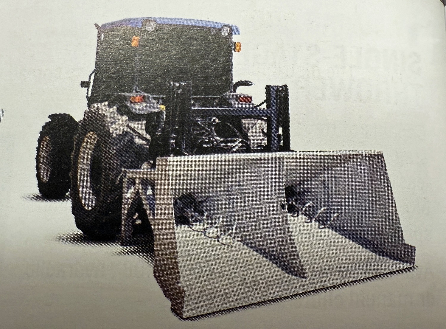

Clogging is definitely a problem with those cone ag spreaders. I had to cut larger openings in the hopper and put in more aggressive agitator paddles to break up ash clumps.

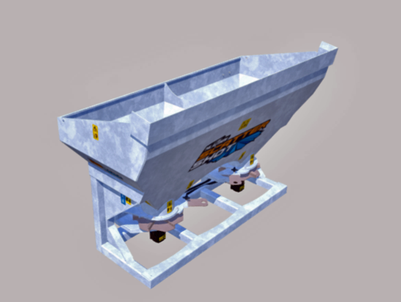

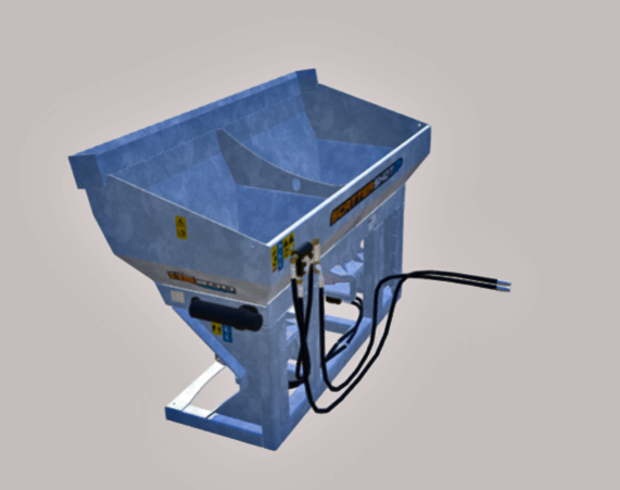

I talked to the dealer yesterday about this FEL spreader from Blue Diamond:
The manufacturer says it will spread anything that will pass through the screen. I'd like something that would also work on a 3pt hitch though. That way, I wouldn't have to remove the plow to put the spreader on.
