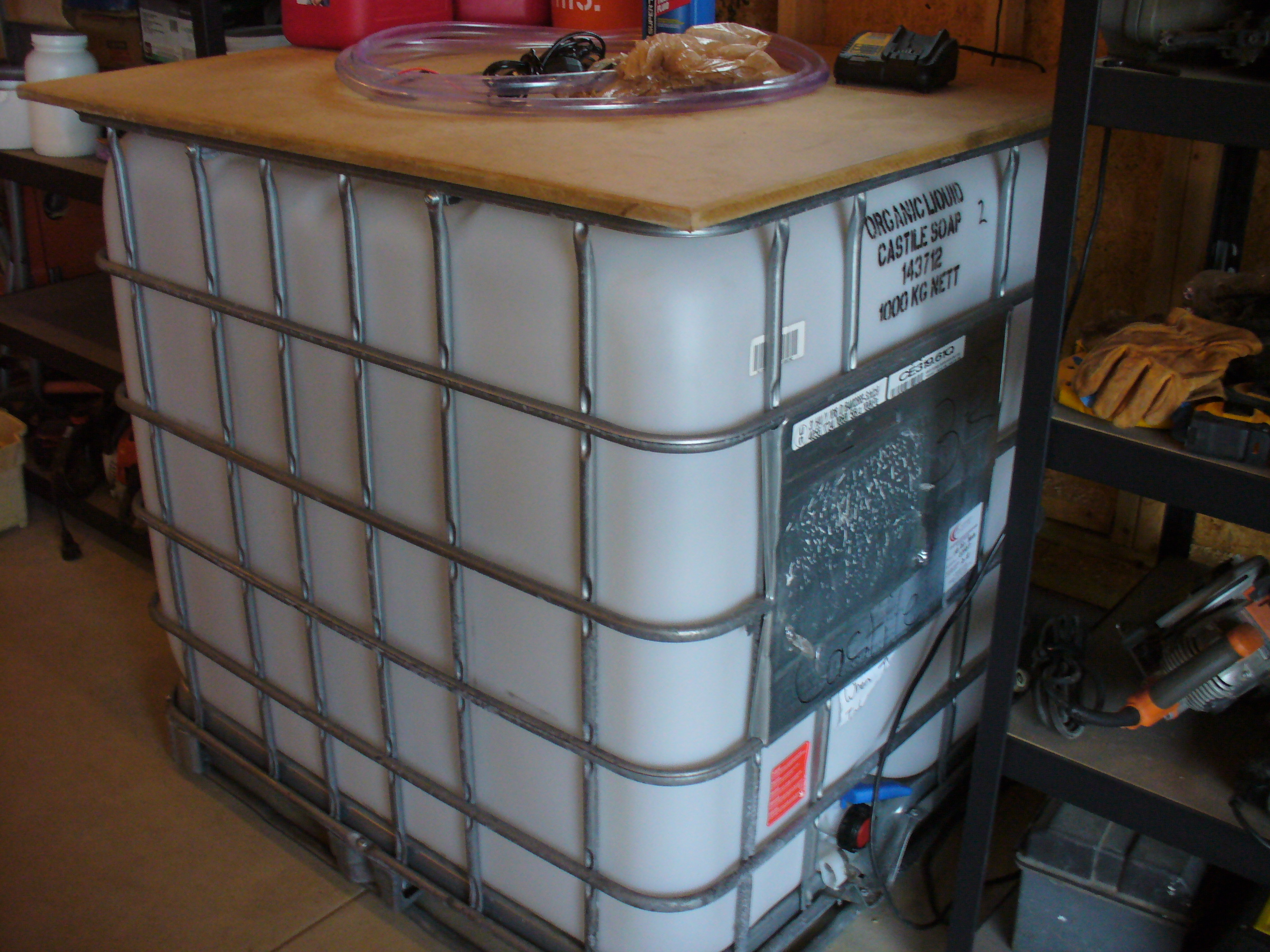

I just bought me a "tote" (sq plastic 275 gal container, with a metal surround cage) that landscapers use for water, commercial shippers use for soap, and non-toxic liquids. Got 2 on CL for $70 each. Bought an elec submersible fuel pump ($18) that pumps 5 gal in 1-2 minutes. Bought some vinyl hose on ebay, and voila ! my own diesel service station. Tapped into the 12v pigtail on the rear of the tractor, and do a quick connect for the pump when needed.
Ag distribution center will deliver 100 gal diesel for same price as off road at a local gas station.
WOW! $70 bucks each! I have them given to me, and sometimes turn them down because I don't feel like hauling them home!

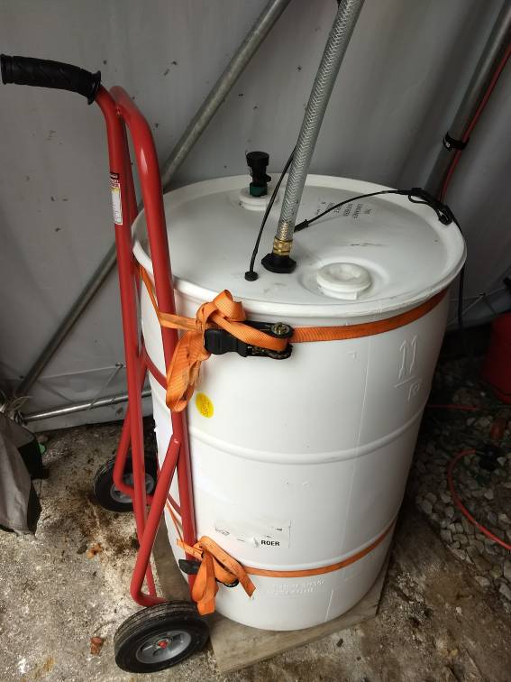

Plastic barrel, HF hand pump. If you are careful and don't over fill tractor, i.e. spill fuel. There is no diesel odor. Mine is in my shop and on a HF large furniture mover that rolls out of the way.
   / What do you use for a fuel transfer tank? #48
55gal, $15 submersible 12v pump I plug into my tractor.

I picked up two of these, 330 gallon, for emergency water supply. Filled them 3 years ago, then one recently developed a leak. Why I don't know - they're completely isolated from everything, inside of a metal storage building.
I tried to find the leak but was unsuccessful, by installing a tubeless tire valve in one of the lids, then pressuring it up to 80psi. It surprisingly held the air pressure. But for sure, with it full of water for an extended length of time, it definitely DID leak. It leaked about 100 gallons of water inside of a month.
The point is though, before you fill it with diesel you'd do well to either partially fill it and wait to be sure it did not leak.
