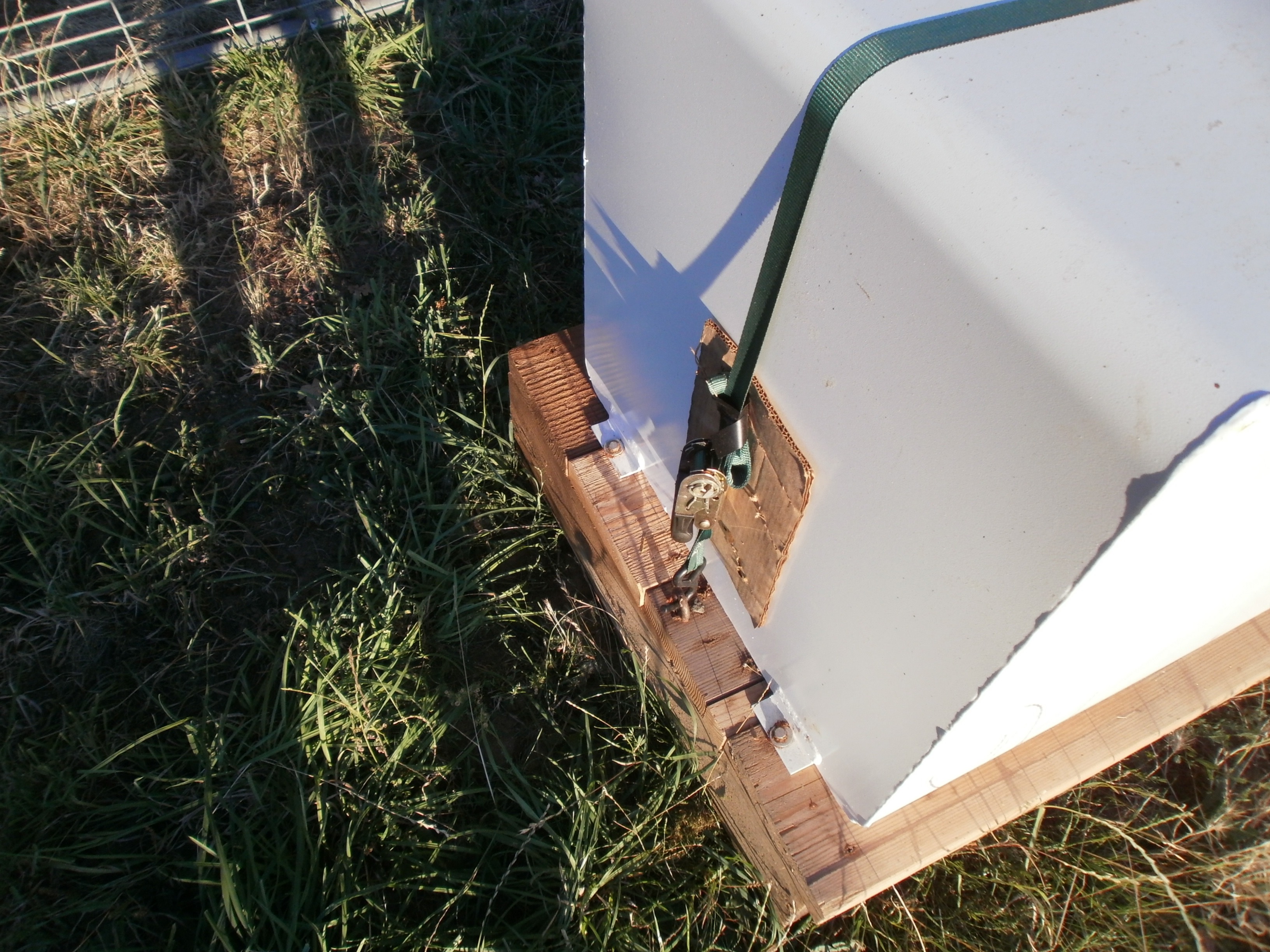

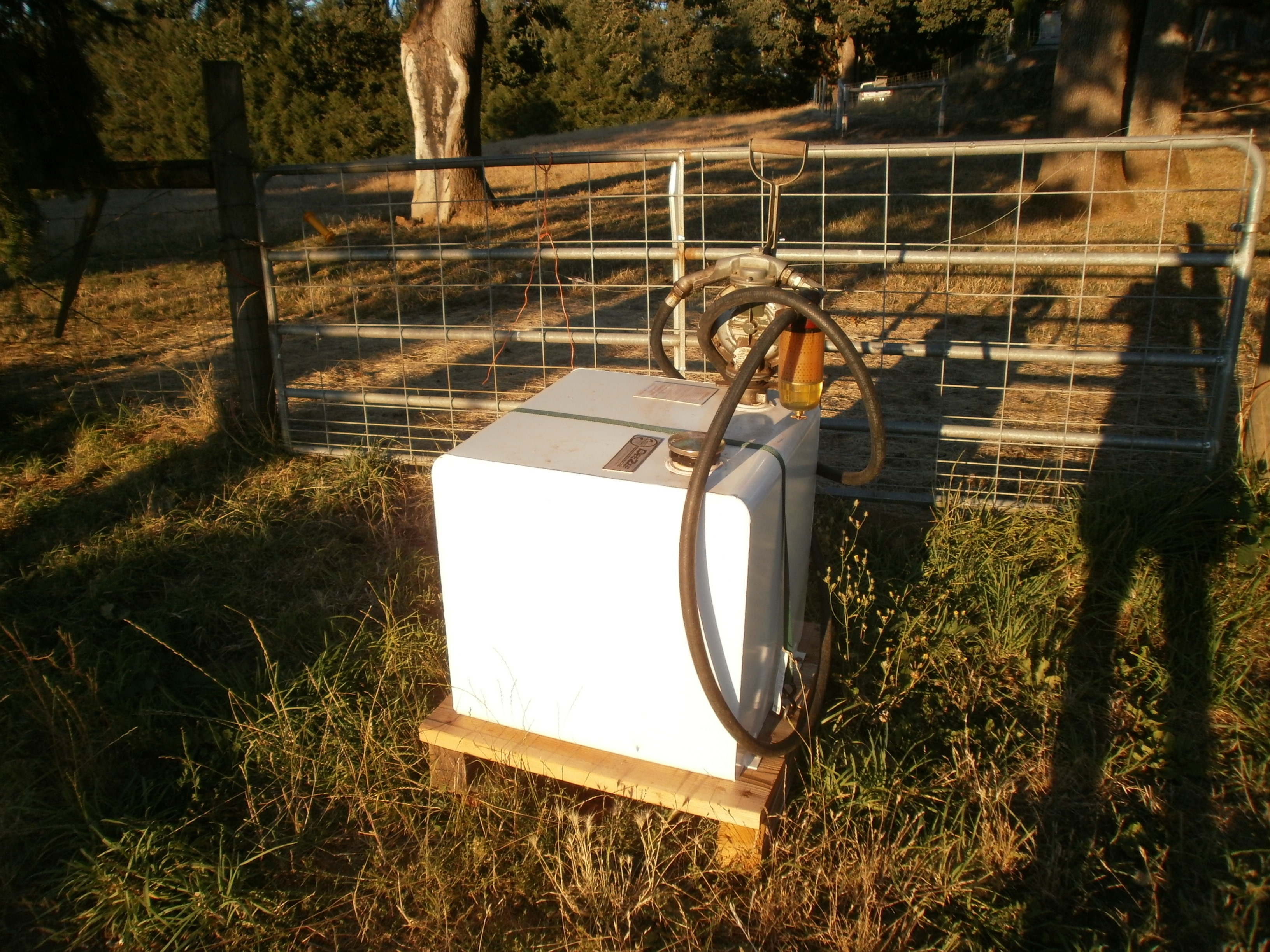

For years I used a drum and this hand pump. I punctured the drum a while back and said boy, I am lucky to have never done t his before. I finally bought a tank, mounted it on a pallet that I can put anyplace on or off the truck or in the shop, where ever I want and not be busting my butt moving some drum around.
I wished I had done this before.
