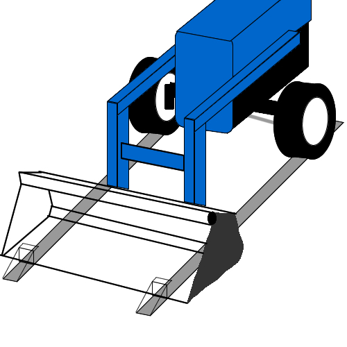

For all out there with a <font color="blue"> NH 7308 Loader </font> you know that unless you have some thing to butt the bucket against when you are putting it back on the tractor you end up just pushing the loader all over the place.
Here is a little brain fart I had the other day and would like to get some feed back as to if you think it would work and what problems you see with the design.
These two devices will be made out of flat bar with a stop welded at the end to butt the loader bucket against. The tires would rest on the other end thus holding the bars inplace while pushing agains the loader to install it. The attached pic should help clearify my confusing description. /forums/images/graemlins/smirk.gif
What do you think?

That ought to work. Nice drawing BTW. On the quick attach setups I've seen the tractror end has a hook that come up under horizontal pins on each side. As you come up under the bucket or forks and roll the FEL back the hooks engage. Then it's just a matter of inserting and fastening the lower pins.
That means I can park the bucket or forks anywhere and still pick them up.
/ What do you think about this idea?
My thoughts exactly. And these should be pretty easy to store when not in use!
/ What do you think about this idea? #4
The nice thing about your idea is that the stops are portable and can be positioned anywhere. I had thought to just drill some holes in a 4x4 and drop it over a couple of pieces of rebar sticking up out of the ground, much like parking lot bump stops are installed, but that would mean that I always have to put the FEL in the same place.
/ What do you think about this idea? #5
Brandon, great Idea. /forums/images/graemlins/grin.gif Another variation would be to make the hooks that grab the bucket come around from the outside. That way, you could drop the loader wherever you want and then come back with the attaching fixture whenever you want. As the bucket would not rest on the bars, you could walk'm over and set them up at any time. Your idea is much simpler to build. /forums/images/graemlins/cool.gif

Brandon, I have also heard that if you curl the bucket into a full-dump position before you remove the loader it will be easier to reattach. I was told that the 7308 manual used to list this as the proper procedure, but has since been omitted. Could be a case of 'what was old is new again'.
Tried that! Doesn't work on smooth garage floor. /forums/images/graemlins/frown.gif
/ What do you think about this idea? #9
How about a towing strap? Just attach the hooks before you lower the bucket, and use the same principle as with the steel.

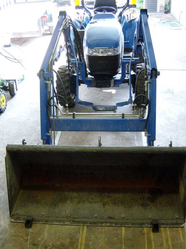

Well, Finally got them built and they work great. Here are some pics.

Here is a side view. The only thing I found that I have too do is use 4wd or the front wheels stop turning and it slides it around. But works awesome in 4wd!

I did try the tow straps as suggested earlier and they worked but were a pain to get lined up and straight. These were supper easy to laydown and line up.

1. If you mount/dismount outside you could weld some pins on the bottom to stick into the dirt.
2. Some cross pieces would keep the assembly square.
3. Cross pieces along the front could be used to position the bucket centered over your invention.
4. Some kind of spring loaded casters could be used. Keeps the system on wheels until the tractor front tires push down. Rubber on the botton could prevent sliding on concrete.
My loader supports (M6800 Kubota with LA1162 loader) sink into soft ground. I'll use your great invention to allow storage on dirt.
Thanks for sharing a great idea.

As far as the wheels and bracing. They really aren't needed. I used 2" x 1/8" flat bar stock. They are pretty light weight and once you get them on the ground they line up easily and are very easy to store.
The welded on spike is a great idea and would work well if you used them in the dirt. Mine are used on concrete so are not needed.
