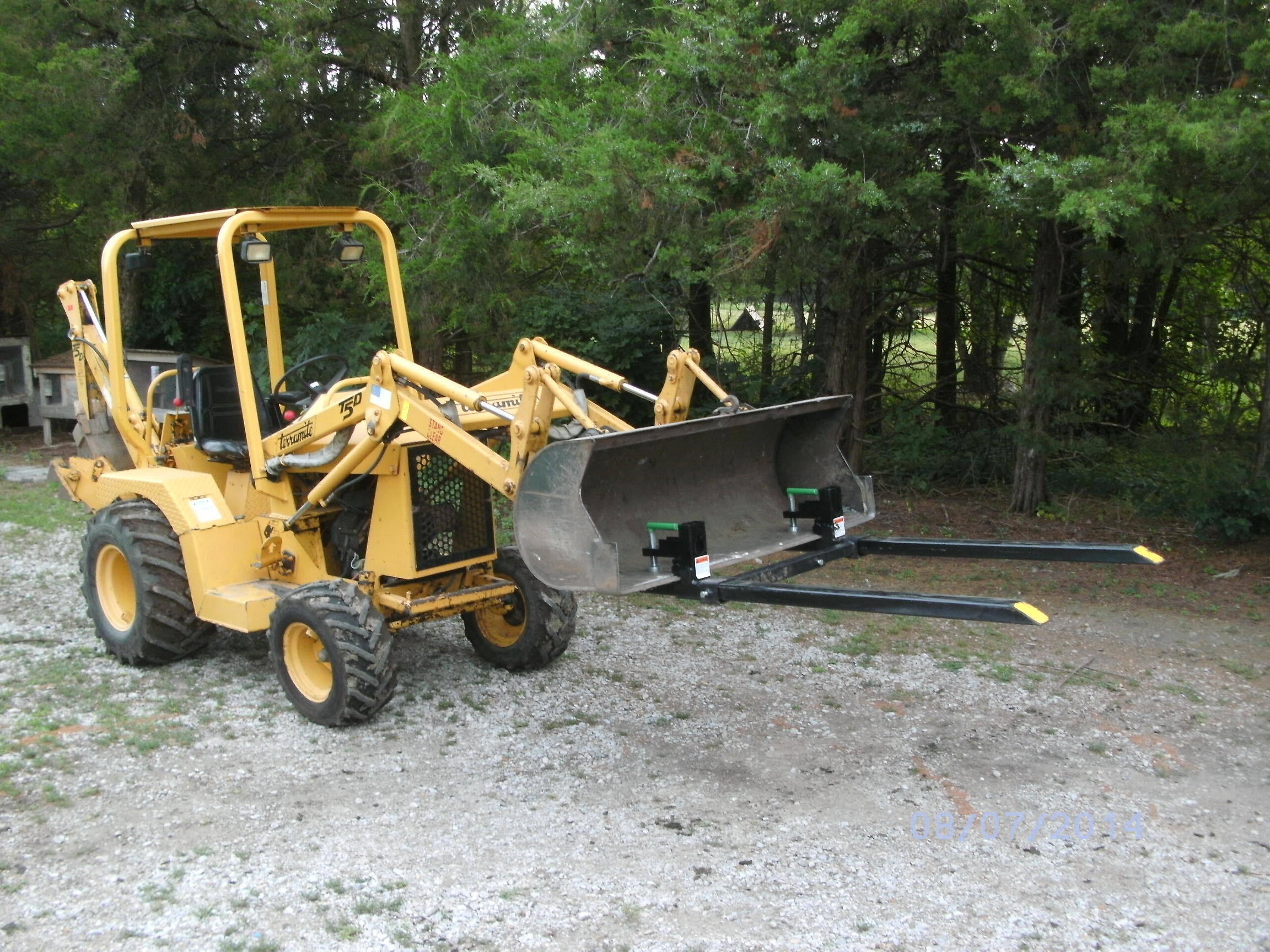

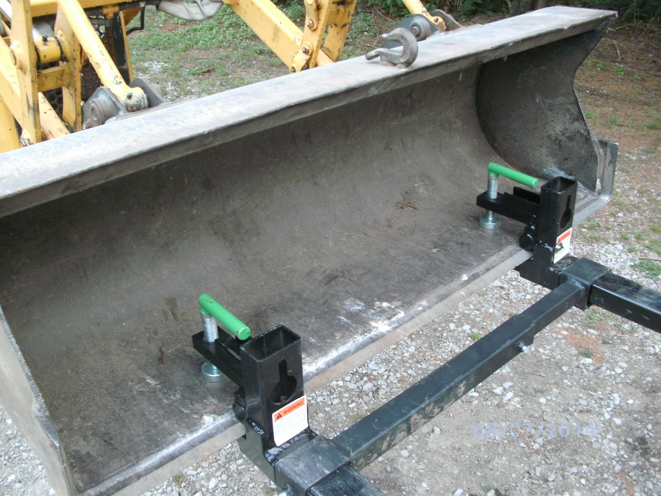

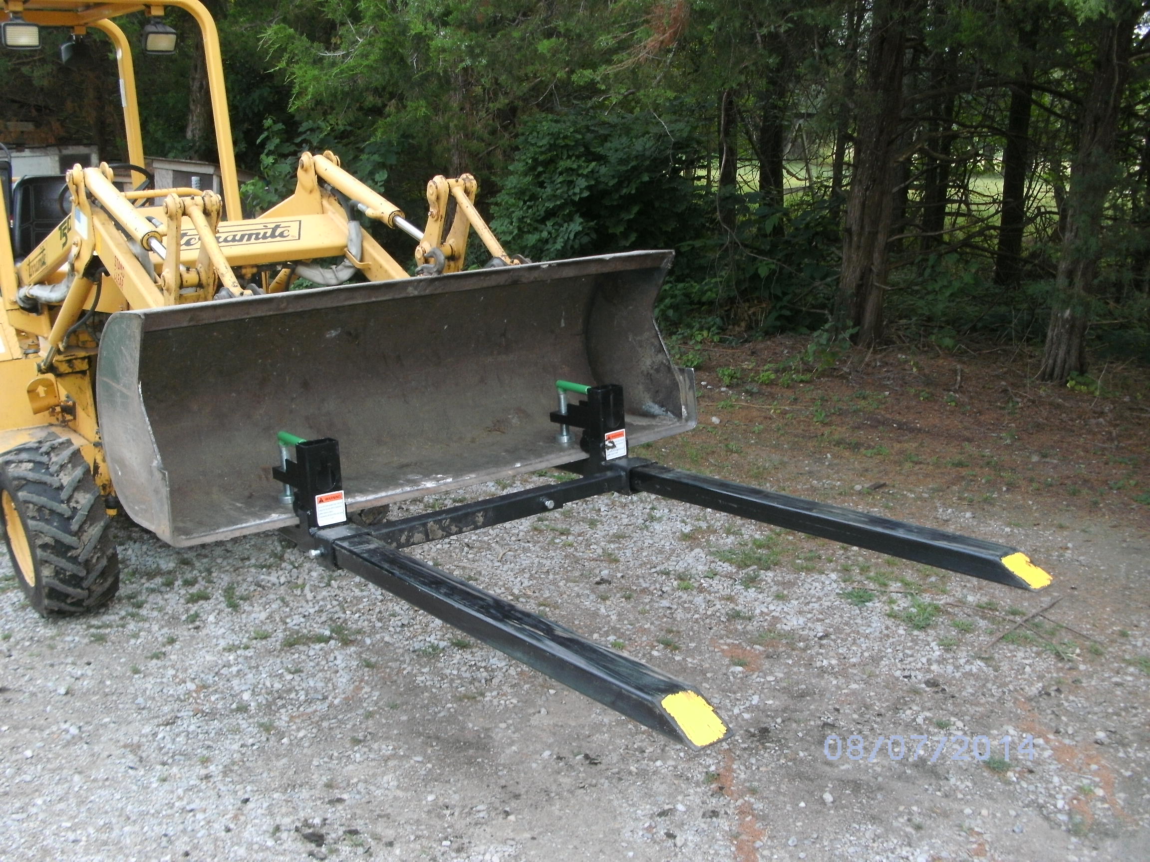

Anyone have any experience with a set of 3 pt hitch forks by the name of Farmit made by BHS Energy?
Log Skidder, Forklift, & more for 3-point hitch
Thinking about having a set of forks made similar to these that would fit both the 3 pt hitch and the front loader arms.
Building this a bit wider and adding mounts for the loader arms.
These are quite interesting. Detachable forks that remove and mount upright behind the
steel frame-super easy storage and always have them in the field. Chain link
locking brackets top and bottom, skidding and towing. Adding a winch mount too.
For my needs, this may be a very good design.
Your feedback and ideas would be appreciated.
Any idea as to the type of steel I would need, and the cost of materials?

I think they look pretty good. Keep in mind if you go wider with the forks they may not go under 3'x3' pallet but most pallets are 42''x48'' or 48''x48.''

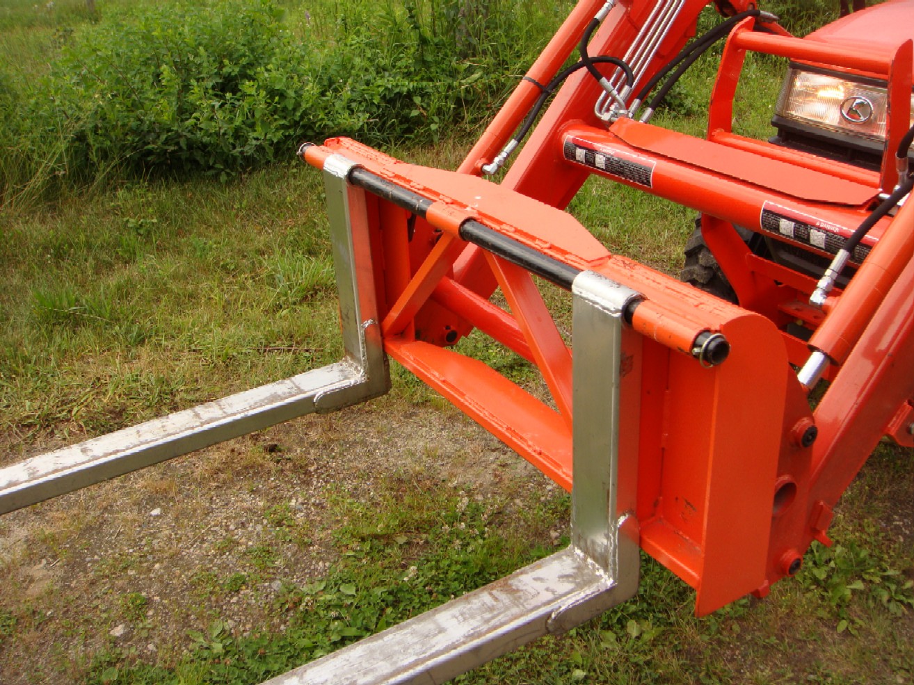

Get a couple of lengths of rectangular tubing, large enough inside to slip onto the forks (5x3 perhaps), 1/4" wall thickness, long enough to run full length of the existing forks plus whatever you need for added length up to about 4'. Weld a collar of 1/4" x 3 flat bar around the inboard end, drill and tap for a 3/4" or 1" diameter bolt for clamping the tubes to the existing forks at the back end.
The outboard end can be slotted or notched on the sides then partially collapsed and welded up to create a taper.
Pictured is the quick-attach fork setup I made from my B-I-L three years ago. The forks are 2x4x1/4 rect. tube, the outboard ends are tapered as described above. We have moved tree-length logs, blocks of split granite, steel beams and bars, pallets with brick, cement pavers, firewood, other tractor implements...the list goes on and on. Nothing has bent or cracked yet, the forks will handle any load the FEL hydraulics can handle.
