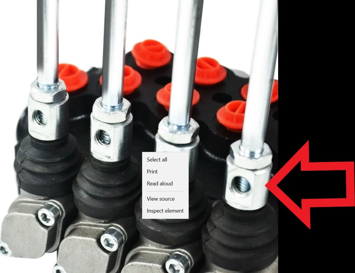

I saw these on Amazon a while back while looking for something else and now I don't remember the proper name to search for them.
I need to buy some for my joystick. They have threads on 4 sides so you can mount the joystick facing up or out.
What's their name?

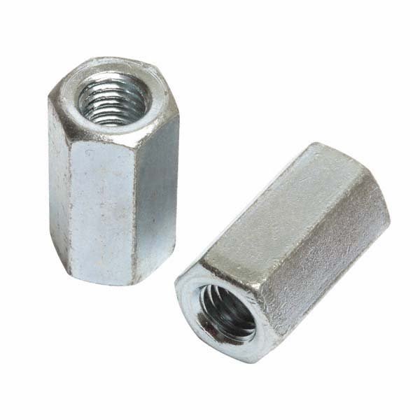

Barrel nut. You could drill and tap threaded couplers also.

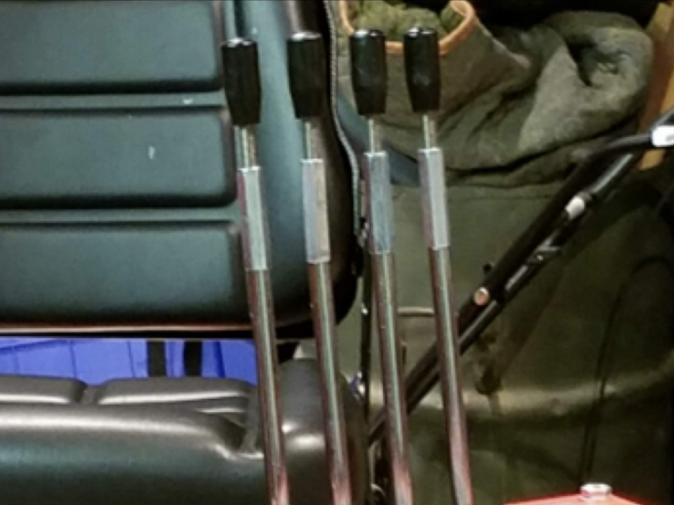

I just extended my joysticks with threaded couplers and ready rod. Here is what I just did yesterday.
/ What do you call this "nut"? #3
Mine were 10mmx1.5.
I did it this way for strength. I still need to put blue loctite on the threads.

I don't need to extend them. I need to change the direction they point 90 degrees.
A barrel nut only has holes on 2 sides. I need a nut with threaded holes on 4 sides.

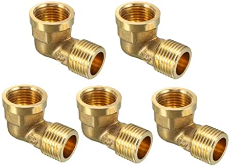

Do you have enough clearance to use something like this? I've seen these with either pipe thread or bolt thread:

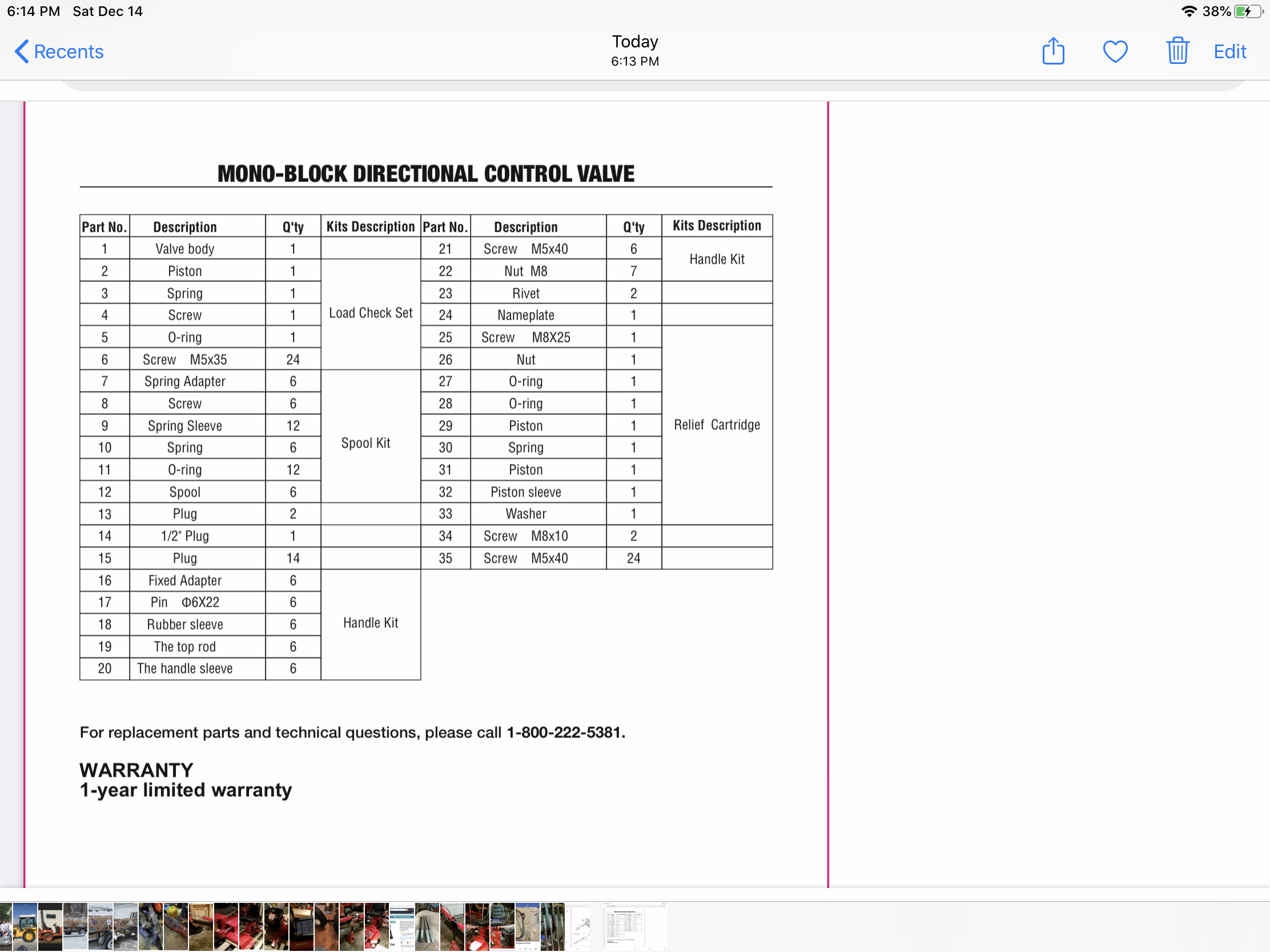

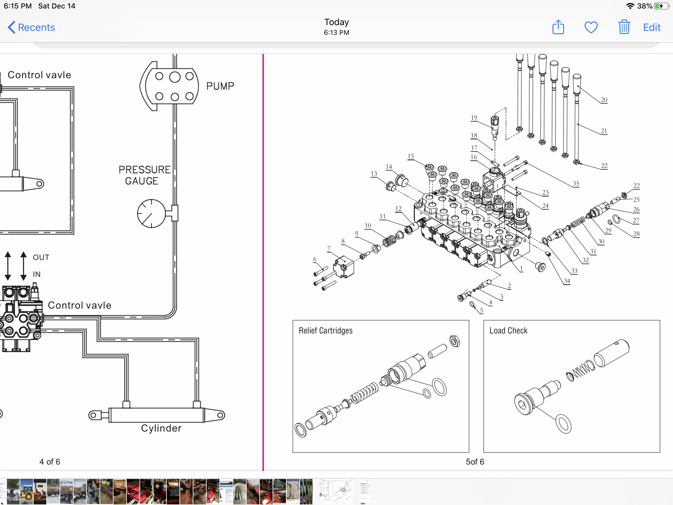

On a Nortrac valve I found this on the nut you are looking for and it’s the same for 2-3-4-5-6 way directional valves and it appears to be part of another item, here is a diagram from Northern tool. It is item 19.
There is a phone number listed so you can call and see it that piece is available separately.
Actually, I could use something as simple as this if I could find one with bolt thread to screw my handle into and then screw it into my valve to change the direction that my handle faces but I can not find one with the right thread.

My question is where can I get replacement rubber boots for that same style valve?
It is probably number 18 on the parts breakdown I posted, wish it had part numbers but at least there is a phone number you can call.

I have solved my problem. I got my neighbor to bend the control rods 90 degrees in his press and I am then extending the rods with a coupler and threaded shaft as lmold did in post #2.
Thank you for the suggestion!
Part #18 is actually part of a complete handle kit.
I only need the little rubber dust boots.
Three complete handle kits is way too expensive ($100+) to get 3 little rubber dust covers/boots.
