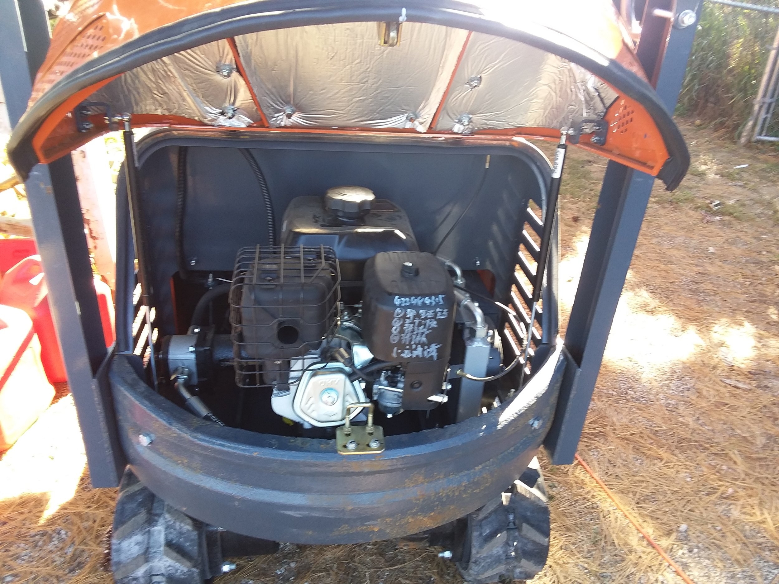

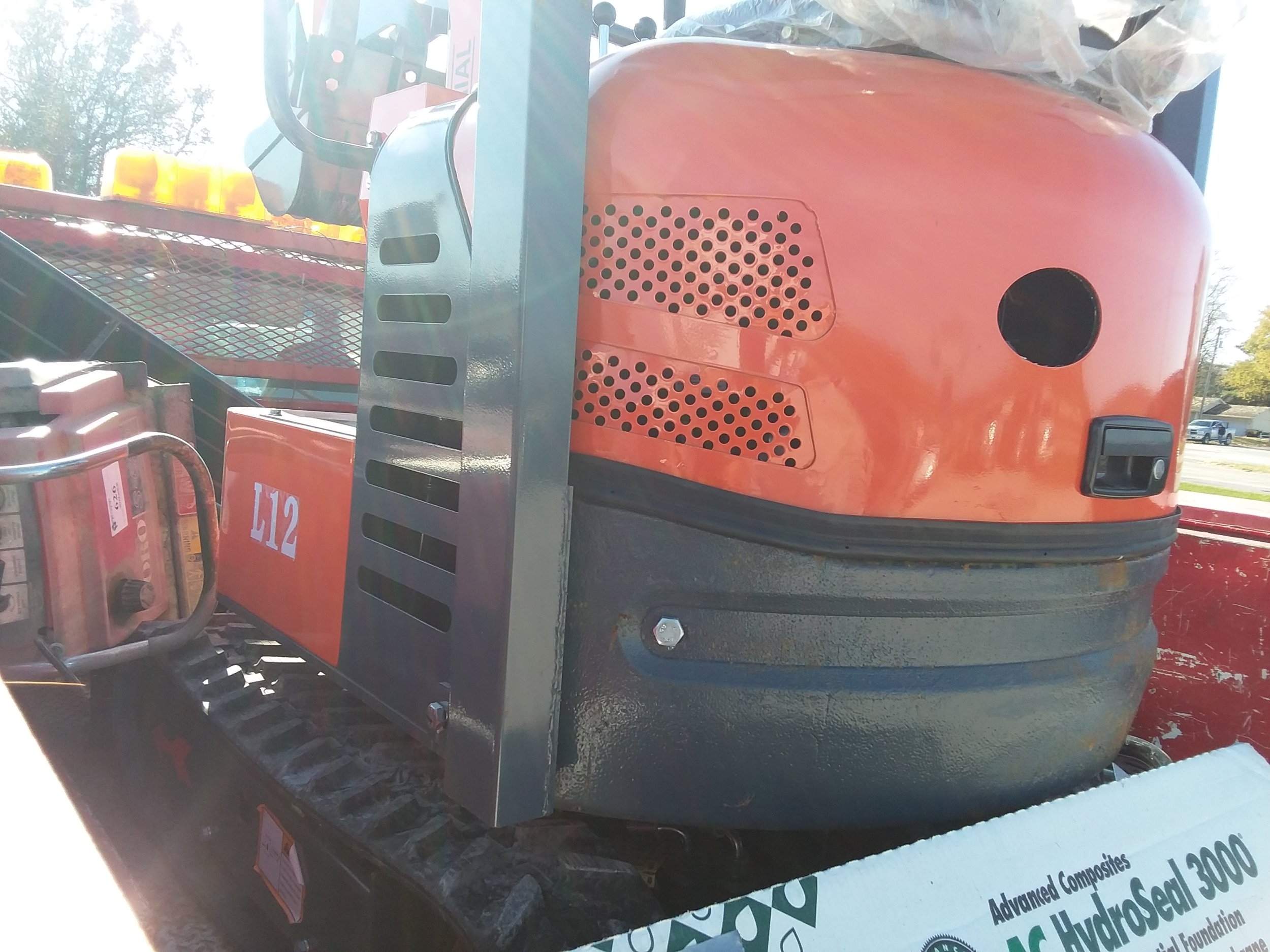

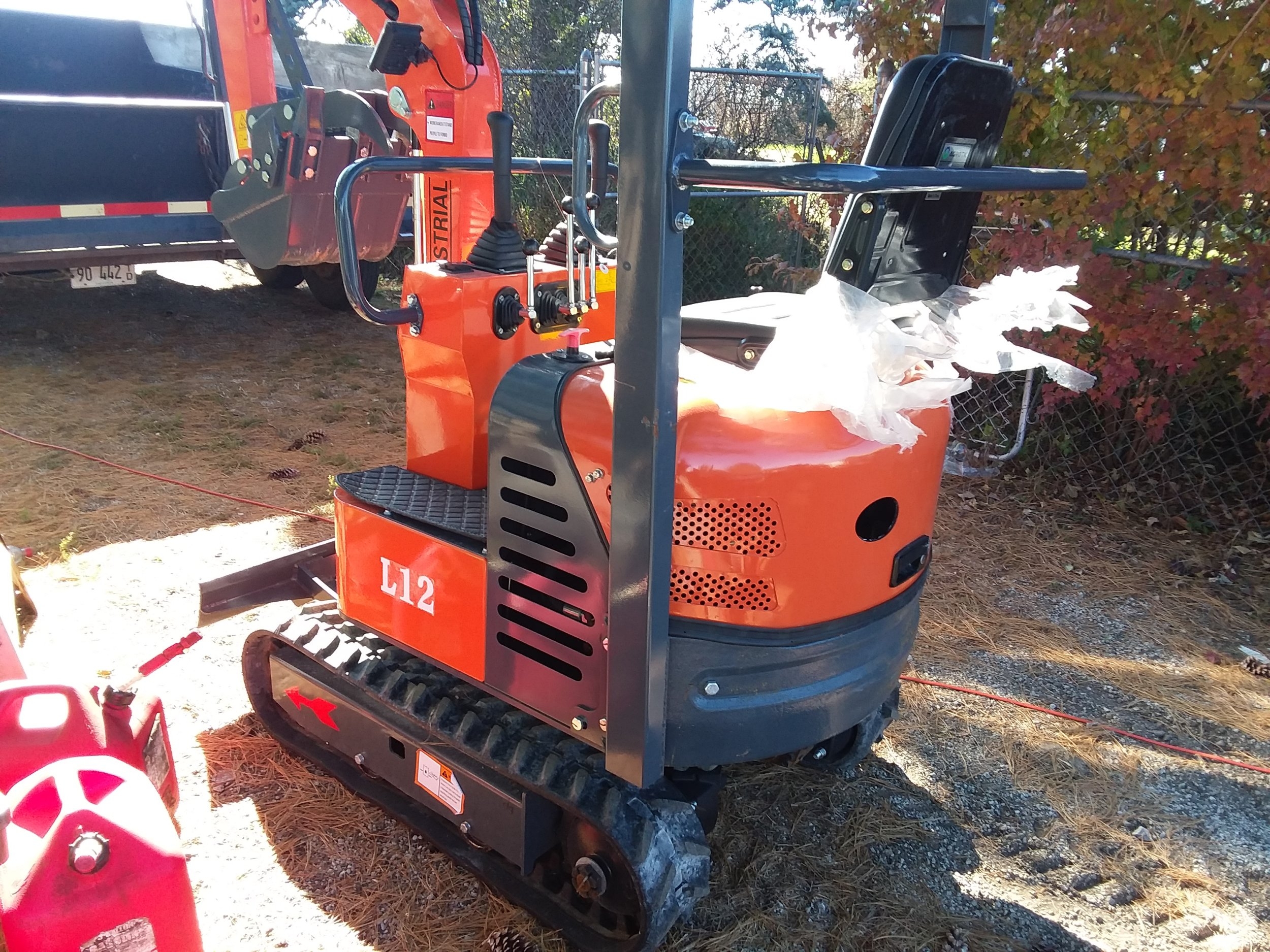

Let us know what happens with the leak on the track motor. I hope it's something simple. You have certainly had your share of problems with it. But, you have also found some creative ways to get more use out of it.
Will do! Ya it started out being a nightmare but after a lot of work I am getting the feel of it. Still gotta fix the teeth so they quit bending every time I dig with it. I still like the L-12 WAY better than the H-12, qsr-12, etc as you cant get to anything on them!
On the L-12 the hood raises up and most of the stuff is right there.
I also want to install my variable flow control valve on it to slow the thing down so it wont be so jerky. Motor runnin just above idle and it will throw you off the seat on the swing . Cant feather the handles enough to do any good,-- its either go full bore or stop.
I dont regret buying it now that I have used it. Blade extension is also on the list. Got that figured out and plate is on order for that.

Nice pics. Your L12 still looks great. Maybe when you have an xtra minute, you could get a measurement between the wheel motors for me. I am going to measure mine as well. I think this is a weak area as I have seen a few that have bent. you have less hours than I do, so if yours are the same as mine then I will know mine are not bending yet. I don't want to install a reinforcement until I confirm that it's all straight. Thanks!

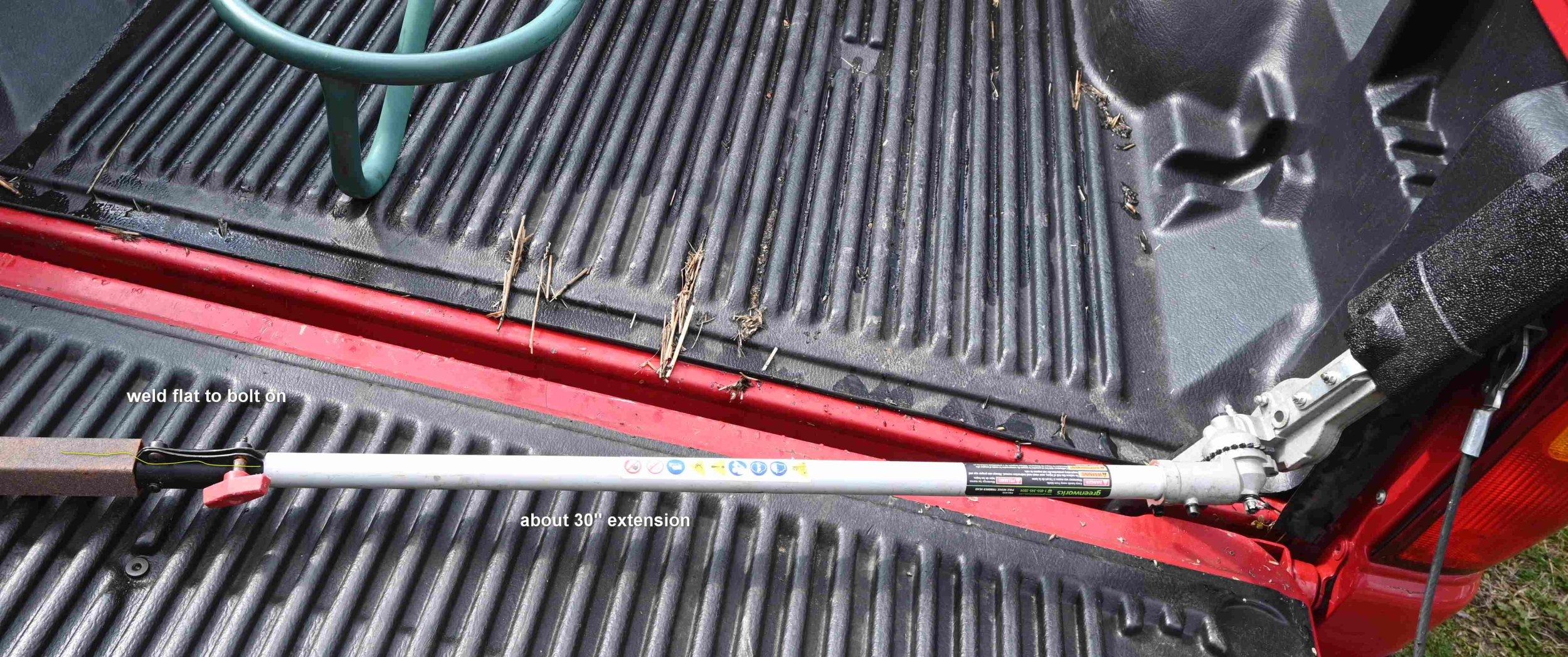

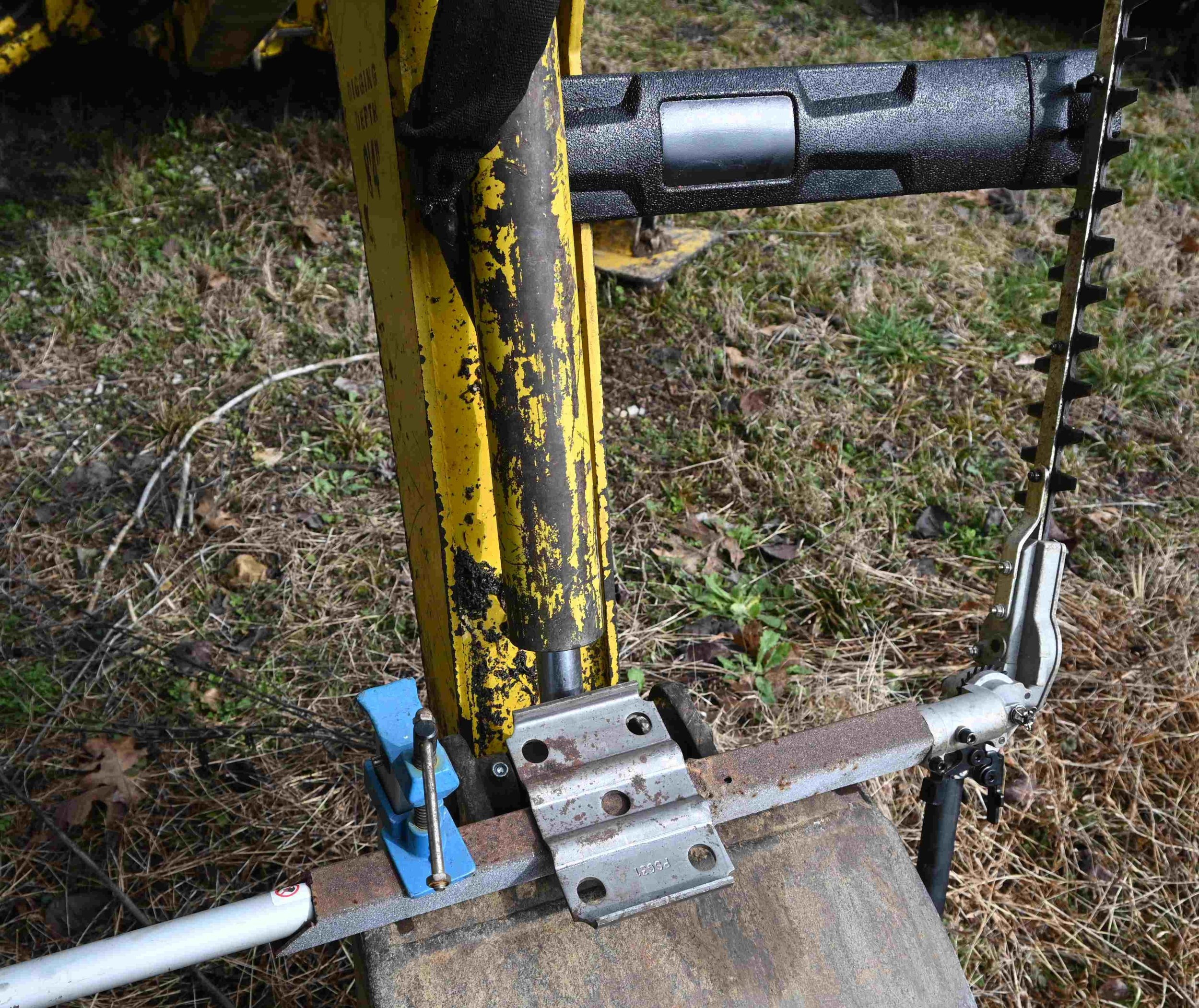

It turns out that the trimmer shaft will fit inside 1 1/4 square tube. It would be easy to drill a flat piece of stock to correspond to the collar that holds the attachment shaft on the power head shaft and then weld it in place on the square tube to hold the trimmer and attachment in place. Then weld or bolt the square tube to the bucket. The attachment would stick out about 30" from the side. Don't know if that would cause clearance issues with the house on the minix? Also, not sure if I'd mount it to stick out frontwards from the boom or sideways?
View attachment 853855View attachment 853854
HAHA!! Look at you! Well you got a good start. :) I was thinking I would have it straight, inline with stick, because I would travel down the trails with the house swung 90*. You may be cutting brush before dark! What if the tube was attached in a way that allowed it to slide in or out, sort of an adjustable feature? Not sure if I can explain it right.
