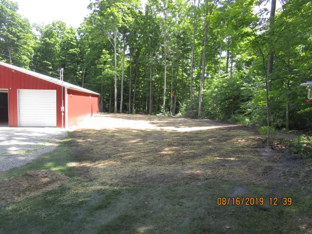

Multi-month project nearly done. Gravel/clay fill in front of barn. Covered with Afton stone. 15 trees wacked down. Stumps removed. Hill removed. Raked and dragged for many days. Sloped for drainage away from barn. Many rocks/roots picked up. Seeded. Watered.... Look Ma, I have more to mow.... !!!!! Spent many days on my tractors until I was sick of it... My butt is sore ...

Looks nice! Do you have a before picture to compare at all? How did the tractor hold do?

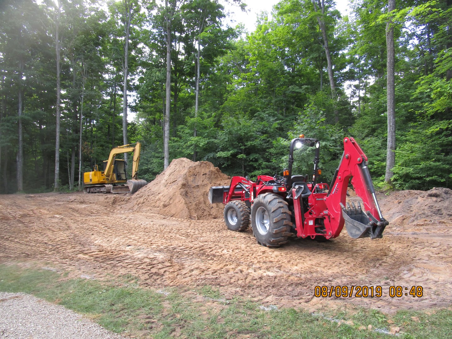

Here is a picture from 2016 that shows some of the trees I had to take out to lower the hill. I'm sure there are others, somewhere...
   / What did you do to or on your Mahindra today? #749
Thanks for posting that, can definitely see you had some stumps to move!
