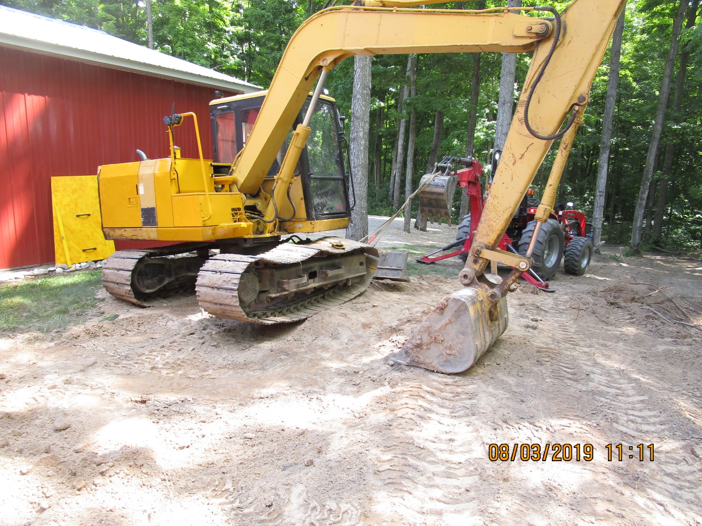

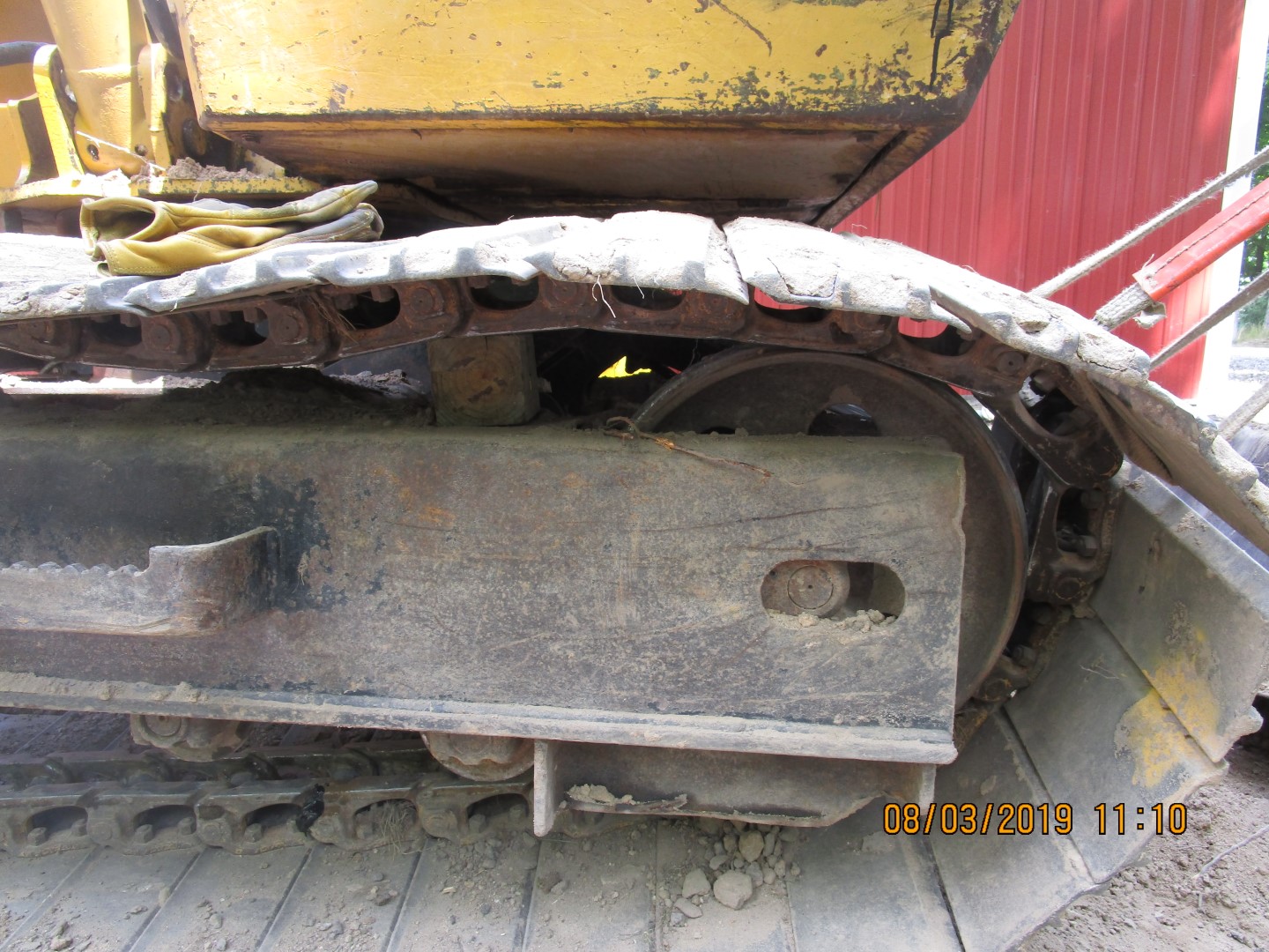

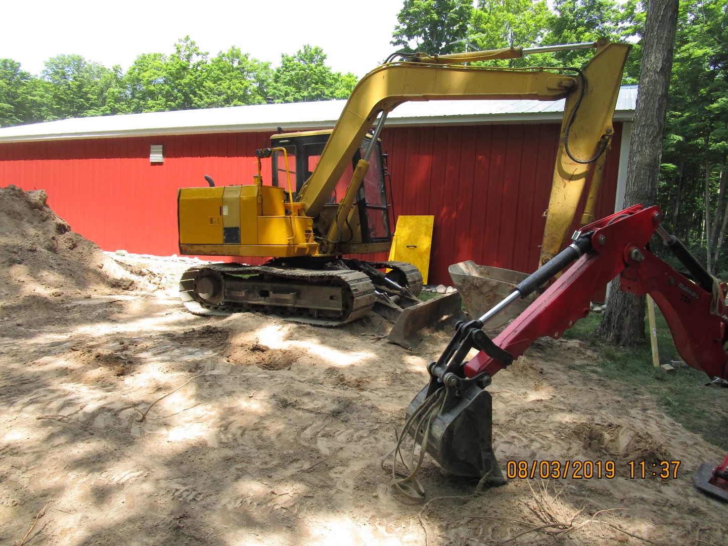

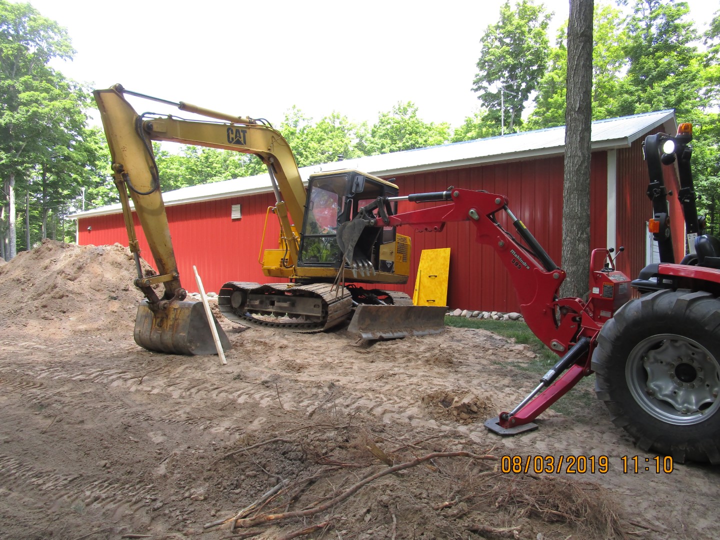

Used my hoe to install the track back where it is supposed to be on my excavator. The right adjuster leaks some, and the idiot operator forgot to check it whilst he was yanking out seven big stumps a couple days ago. I'd kick his arse, but I can't get my foot around back that far...... I am going to punish him by making him take it off/put it back on when the new seal kit comes.... I can just hear all the whining now ....
