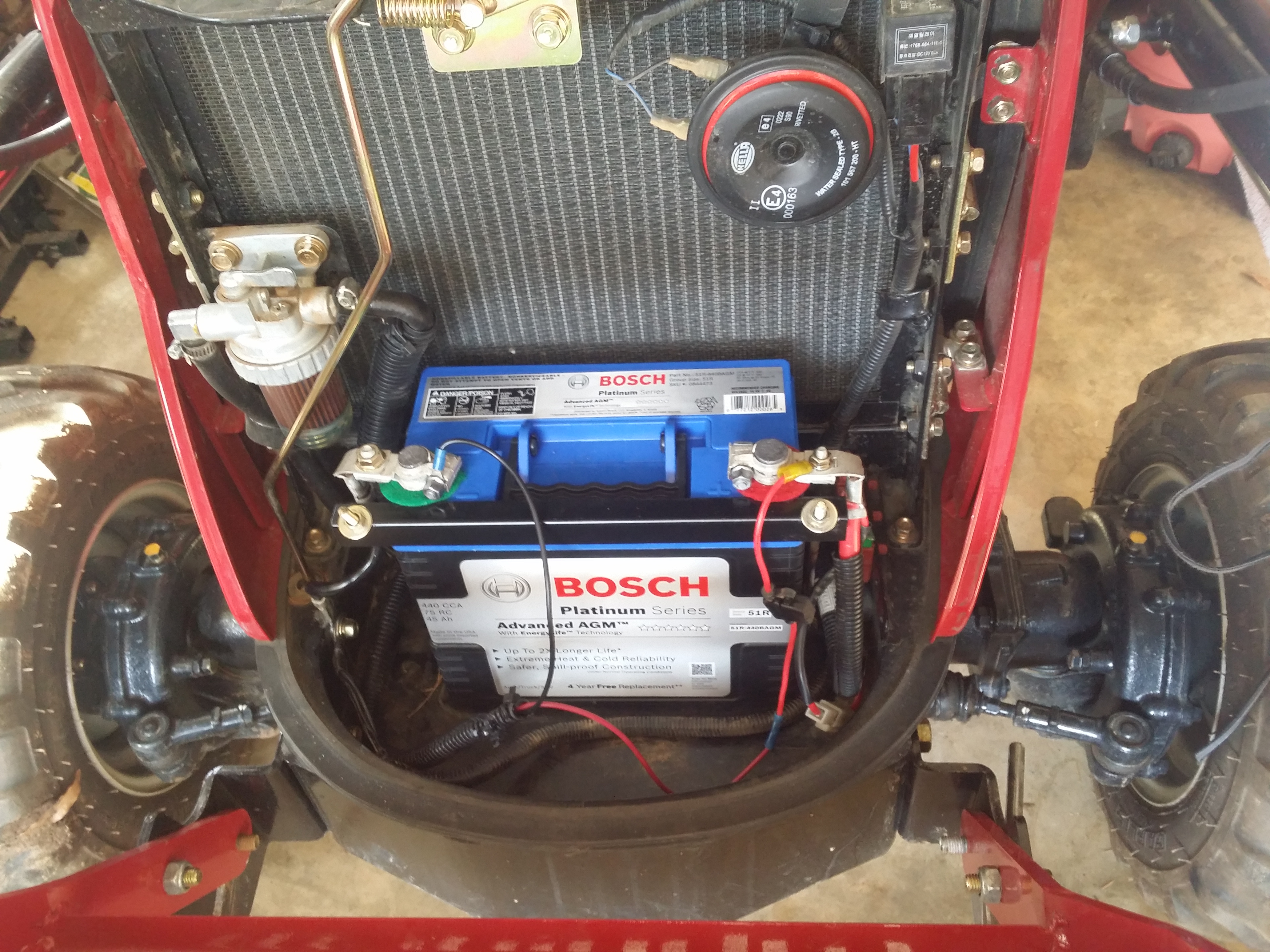

Changing out the stupid OEM battery. Why do they put unsealed batteries in a tractor is beyond me. I just caught it in time so there's no acid damage, just post fuzz. The vibration had the acid drool out the vent caps. :thumbdown:
Cleaned all up and now looking for a nice Group 51 AGM.
Autozone near me didn't have a Group 51 but a Group 35 will fit. $182.
PepBoys has a Bosch AGM Group 51 for $142ish.
Good part is I have a short gig spreading out gravel for a garage pad so at least it's paid for. Decisions, decisions...

No seat time for me (yet). I picked up the Bosch AGM Battery from PepBoys late yesterday and had it charging all night. The final prep/clean of the battery area today and install. Using an old mouse pad underneath the battery to help with vibration and help to prevent over tightening.
Done!
I'm thinking of adding a 12v outlet by the auxiliary light switch.

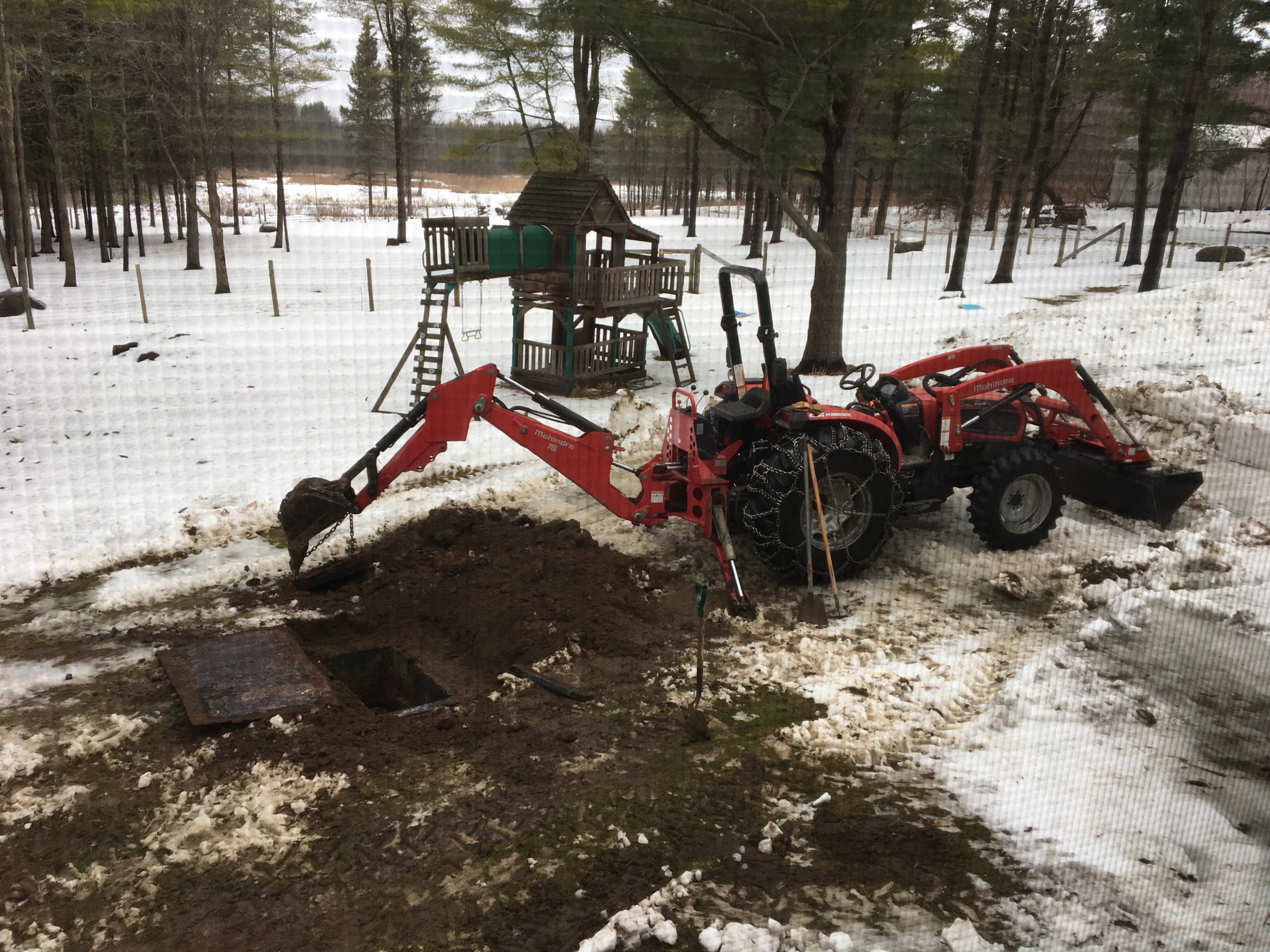

Dig up my septic tank. Pumper coming in a few hours. Thankfully got some nice temperatures!
