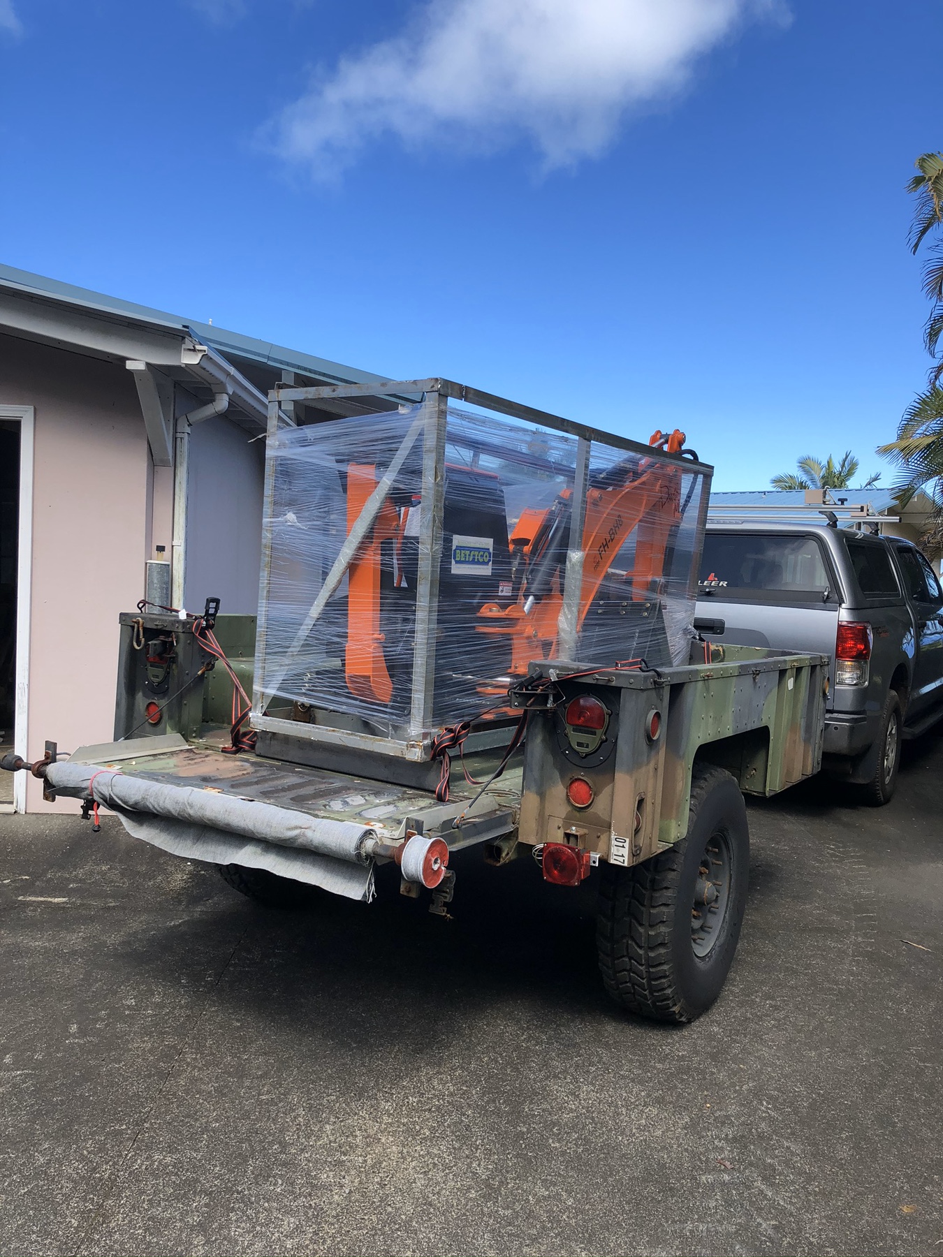

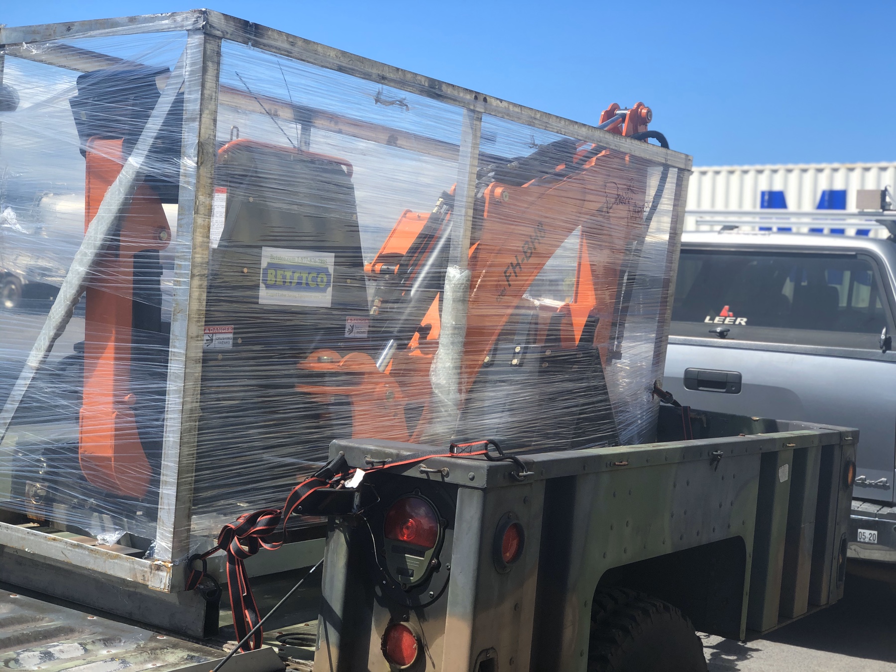

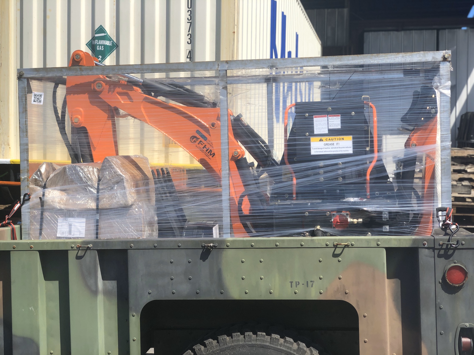

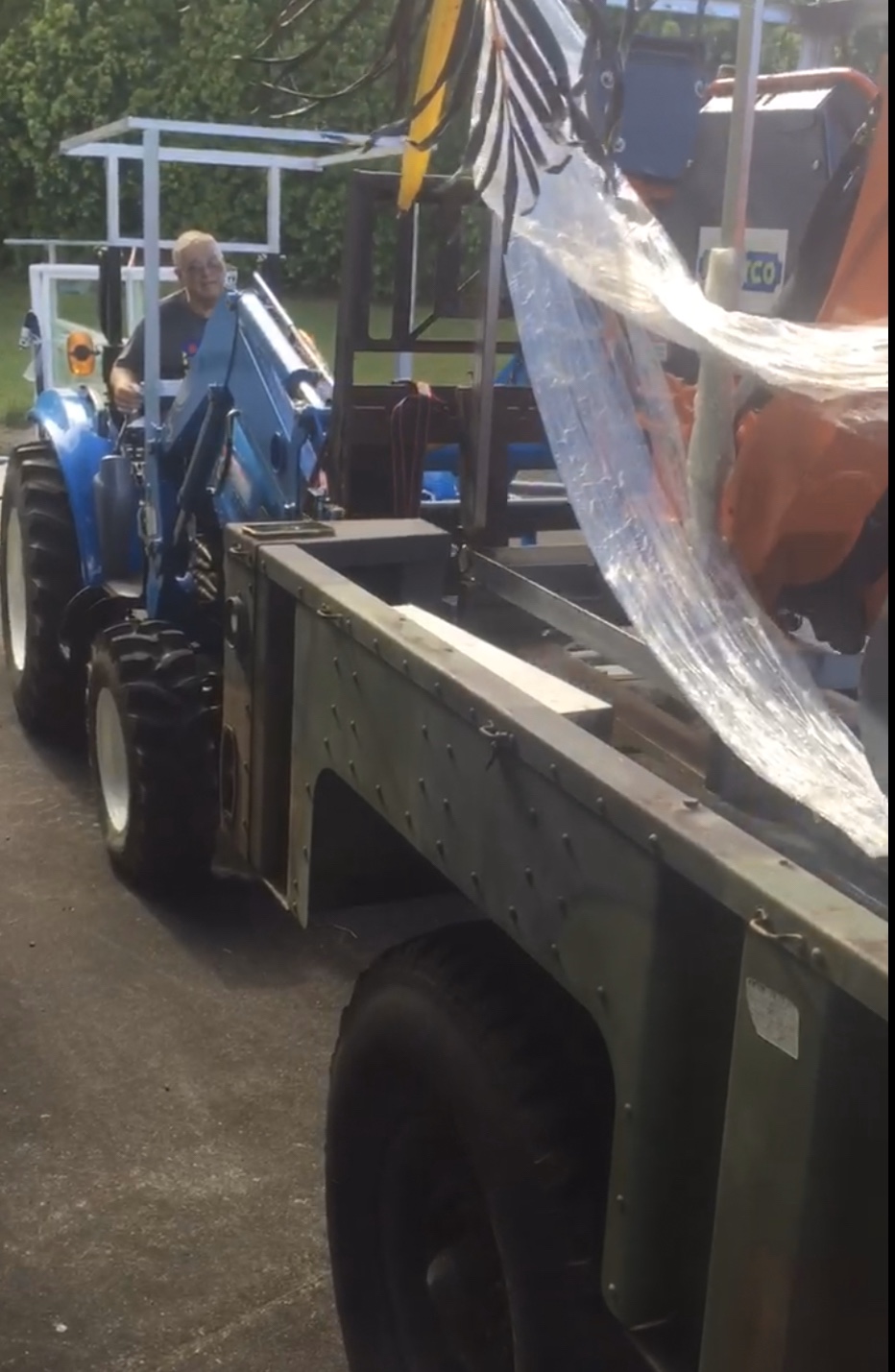

Picked up my Betstco FM BH8 backhoe from freight agent today. Actually a few days earlier than expected.
At agent
Home
Unloading
Crated weight was 1650lbs. At the limit with my pallet forks , actually had to take a few things off the front of crate to lift. Crate was 88inches so somewhat out there. Once on the ground, easier lift from side.

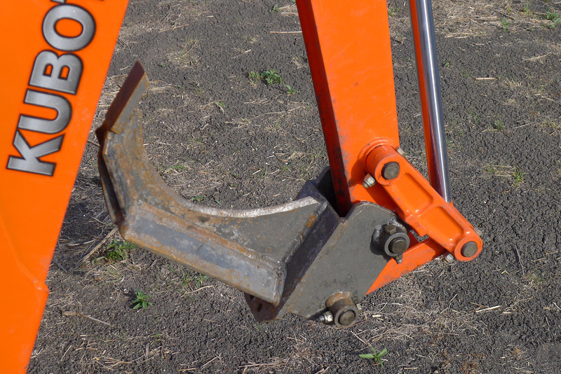

If im trying to trench even if its not that hard i will remove all but one ripper from box blade and drag it through the ground a couple times first can get it down a foot and marks the path of trench if just a hole just drag it back and forth across where want the hole! I plan to build a one ripper tooth attachment for my backhoe that has a sharpened cutting edge seen one this way for getting through the hard stuff and cutting roots around a stump!P1010403-L.jpg

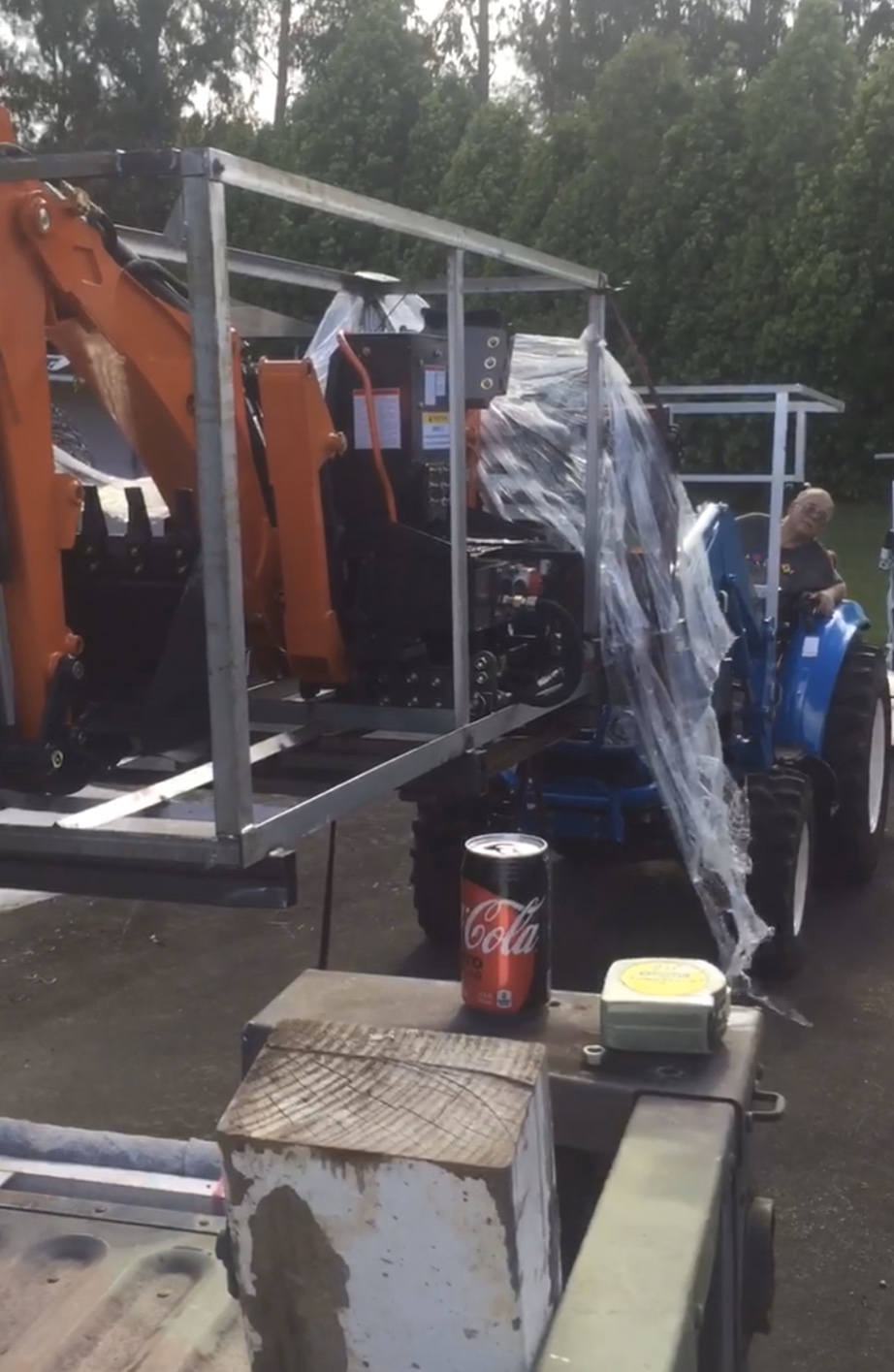

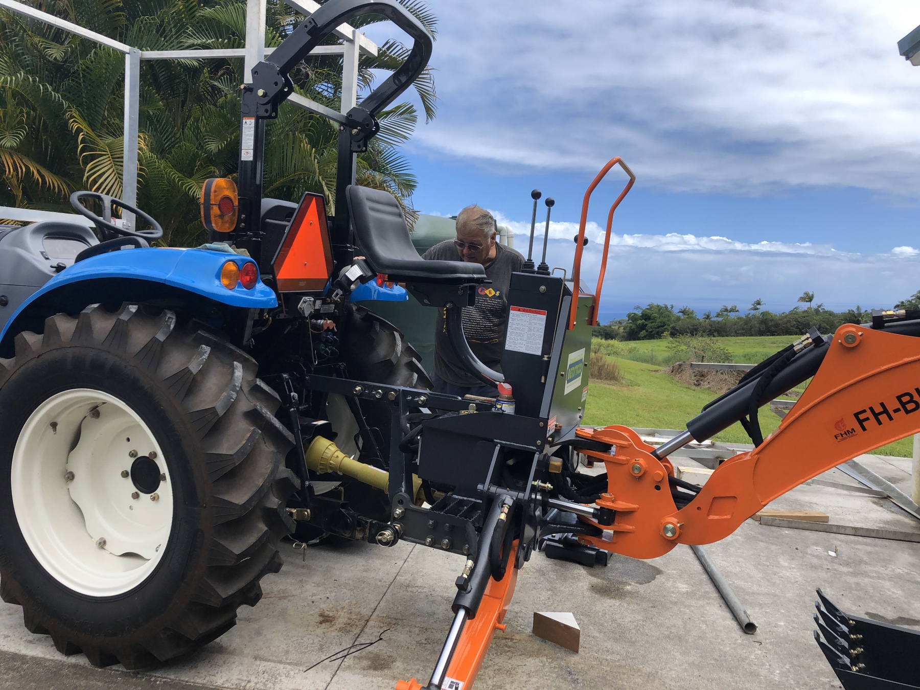

Mounted new FM BH8 backhoe today for 1st time. Just picked it up Tues. Took a few days to assemble due to wx and other things.
Seems very well built and very nice fit and finish. My Kioti bh was a subframe so this was quite different. Have to be very close to hookup PTO for hydraulics. I can see where having a proper dolly will be quite an asset. Thinking sometime in future I may convert to a subframe, but would have to custom build.
Controls are ISO configuration, so I either relearn or change plumbing. A bit counter intuitive that dipper movement is opposite of valve.

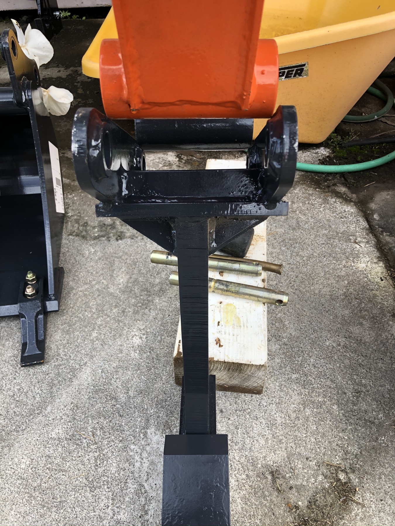

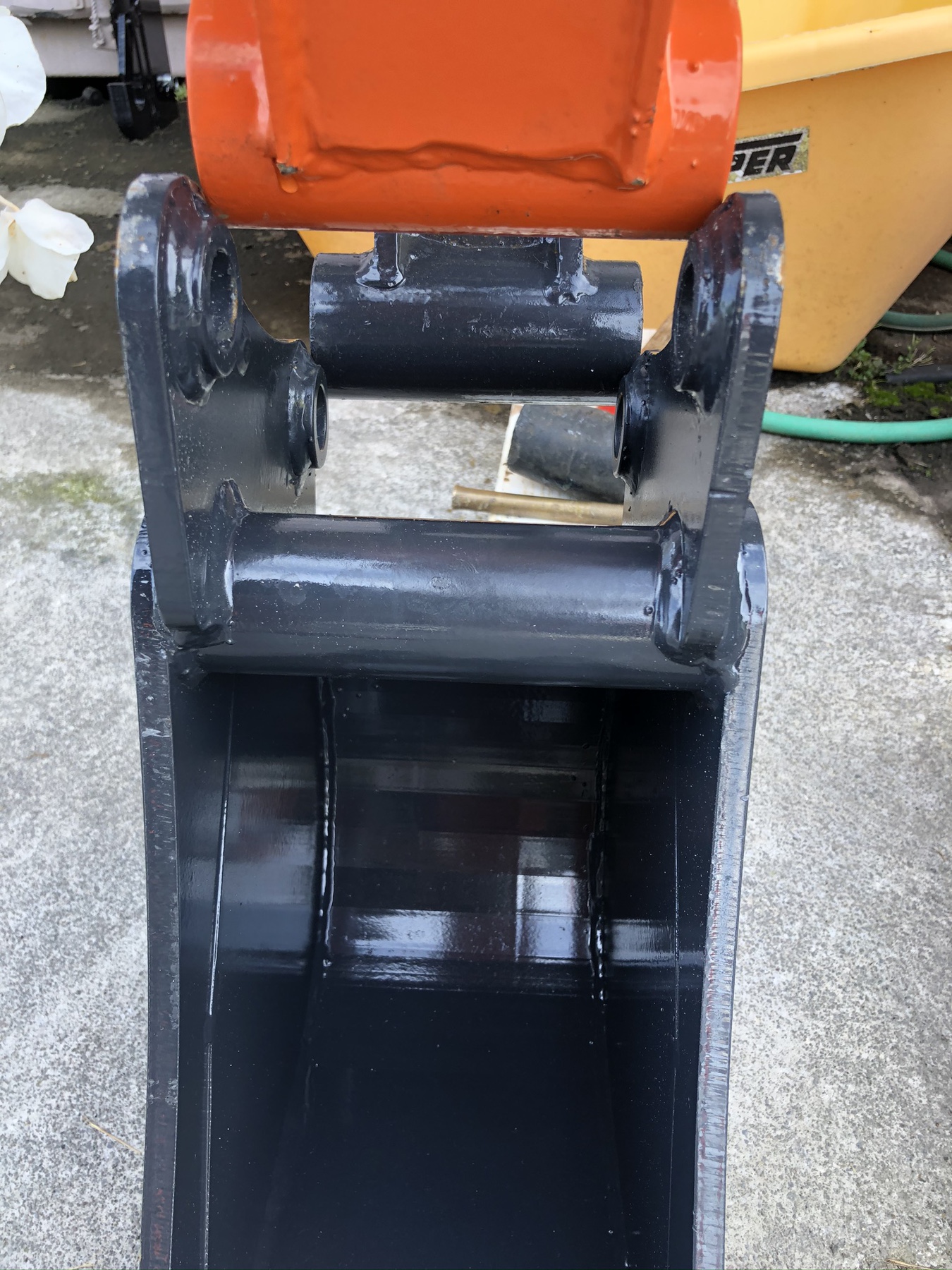

Didn’t get any productive work done as current project requires just a small bucket or maybe the ripper. Unfortunately neither would mount, bushings on inside of mounting plates.
IMG_0858.JPGIMG_0857.JPG.
Will be contacting dealer for resolution

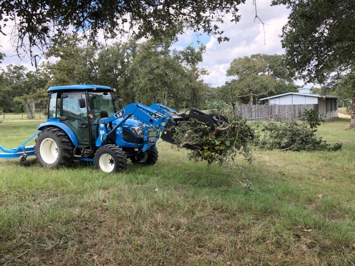

Tree trimming and burn pile building with our XR4155 HC and EA 73” grapple.
