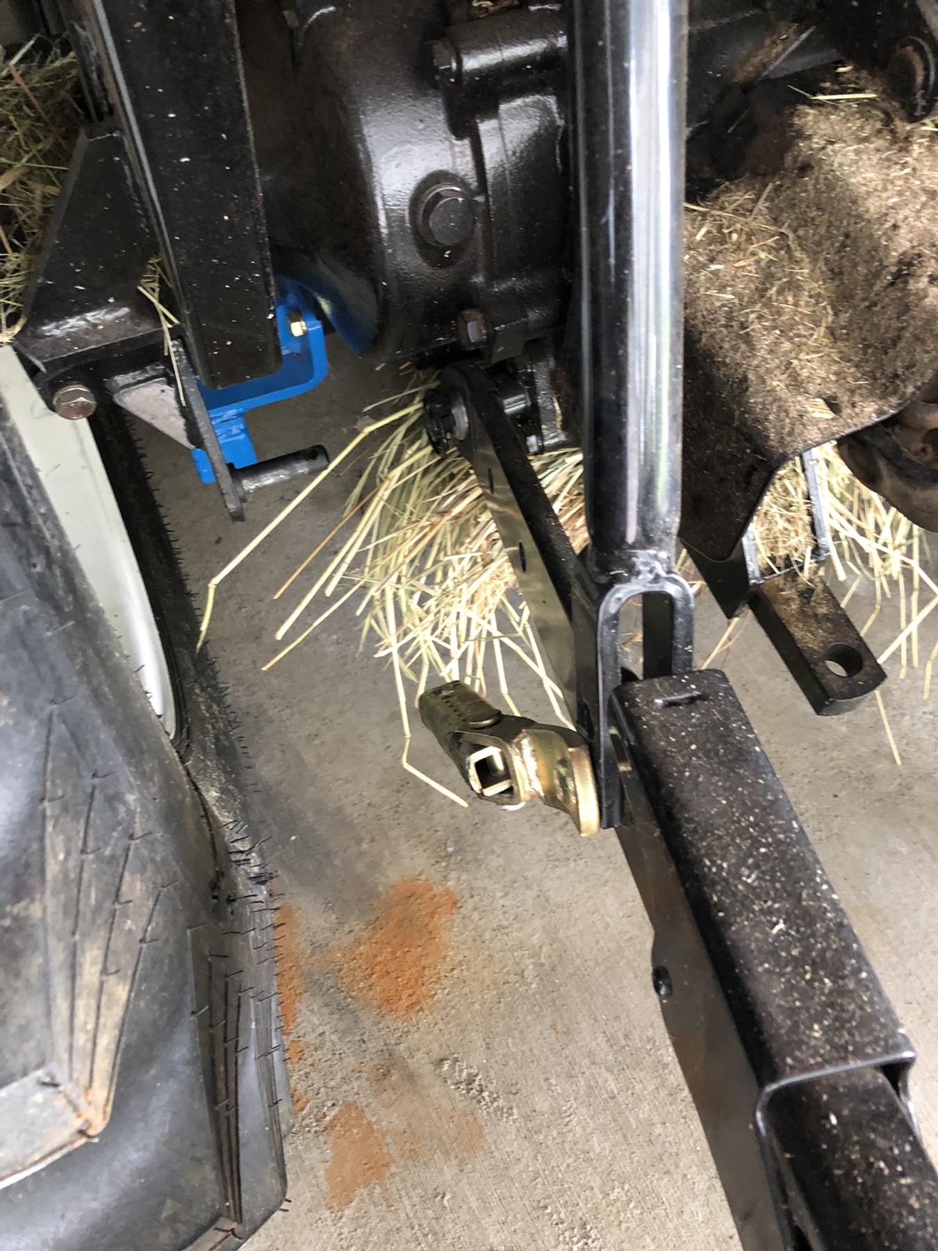

Got a few hours bush hogging. Stopped when I noticed I was missing half a stabilizer.☹️ have never had a stabilizer come apart on my Kioti or Case, so something new. Looked around for the main piece but no luck. Probably find with with mower sometime. Will definitely have to look to see how to prevent in future.
A simple fix sometimes for cotter keys (hitch pin clip or hairpin cotter pin) that get pulled by tall grass and weeds, is a piece of #9 wire or half a welding rod,knock the flux off slid it thru the cotter key hole about half way and bend it around just past a U shape the long tails (6") will move with the grass and not pull out.
There are also several types of so called locking or safety ones,

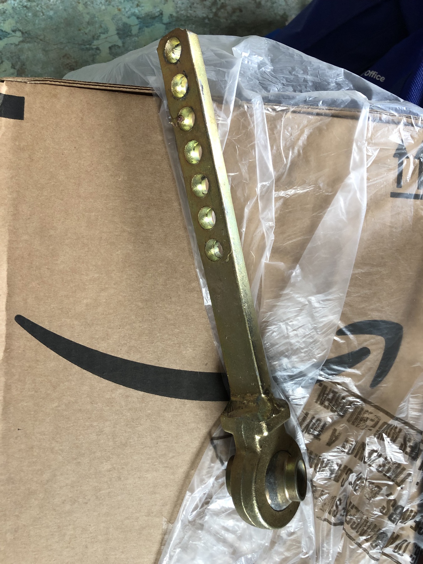

Thanks Lou
Found missing link today

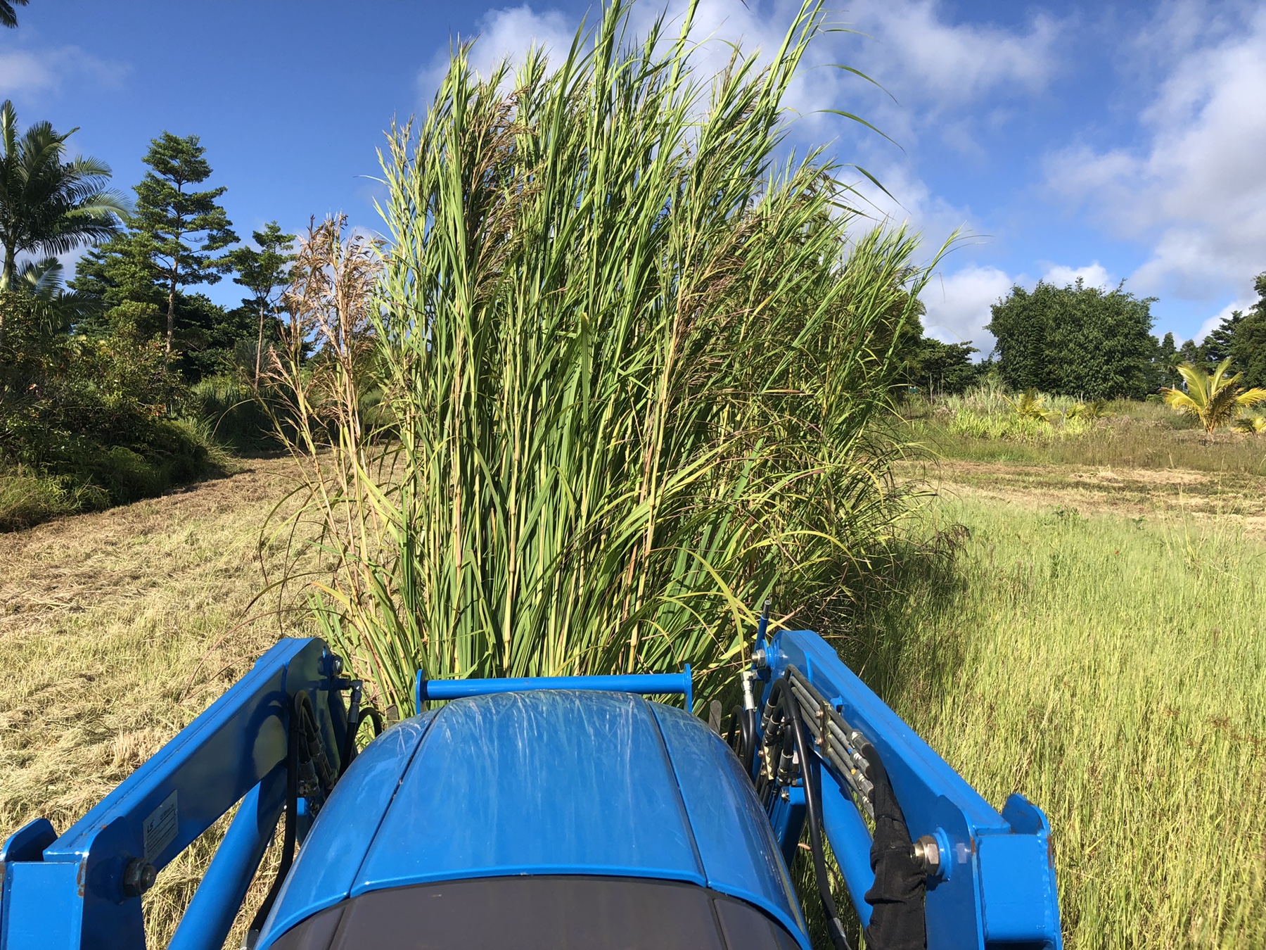

This is part of mowing, Wainaku grass. This wasn’t largest, just one of few remaining when I thought to grab a pic. This field was mowed in Feb this year.
