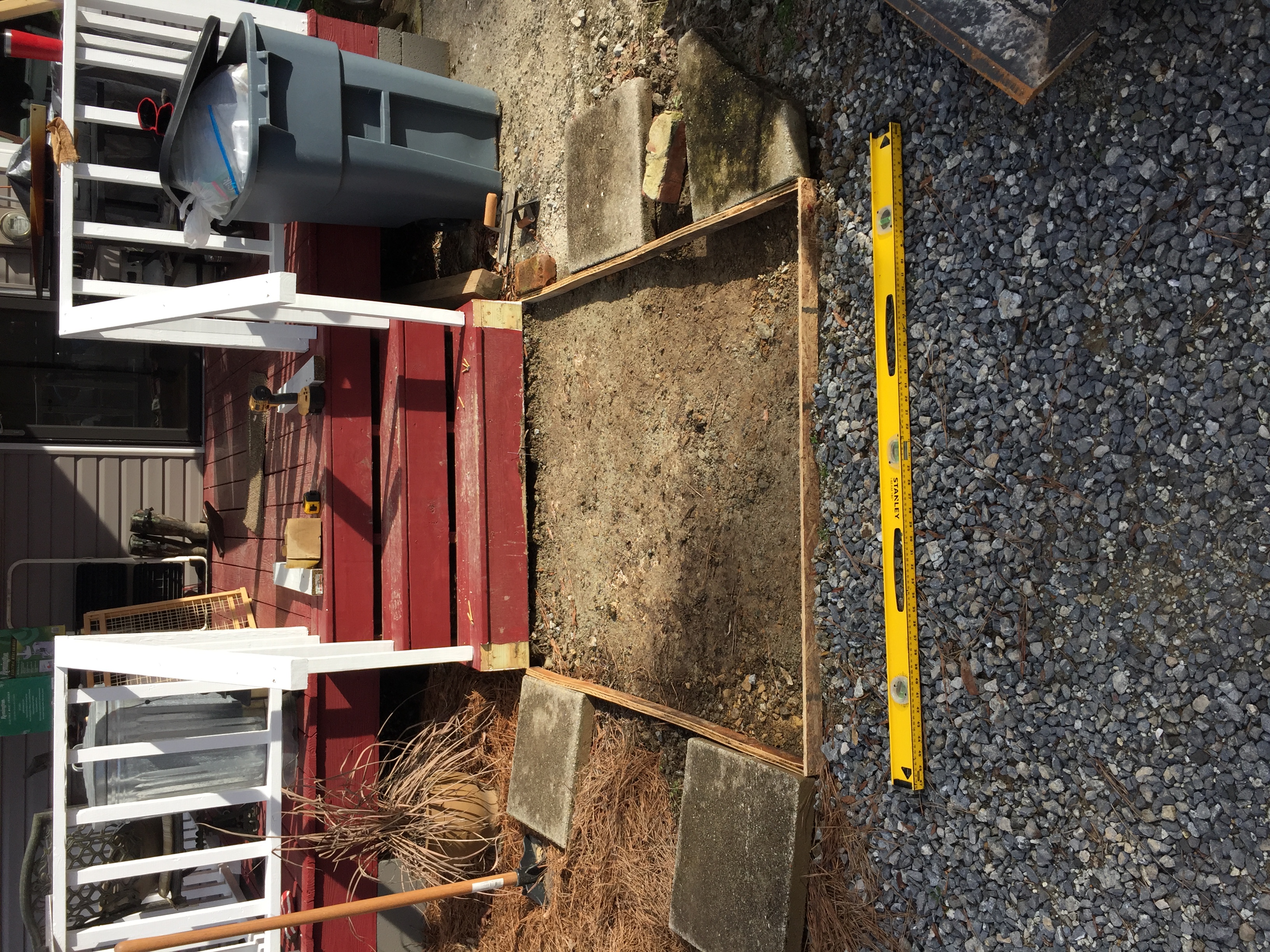

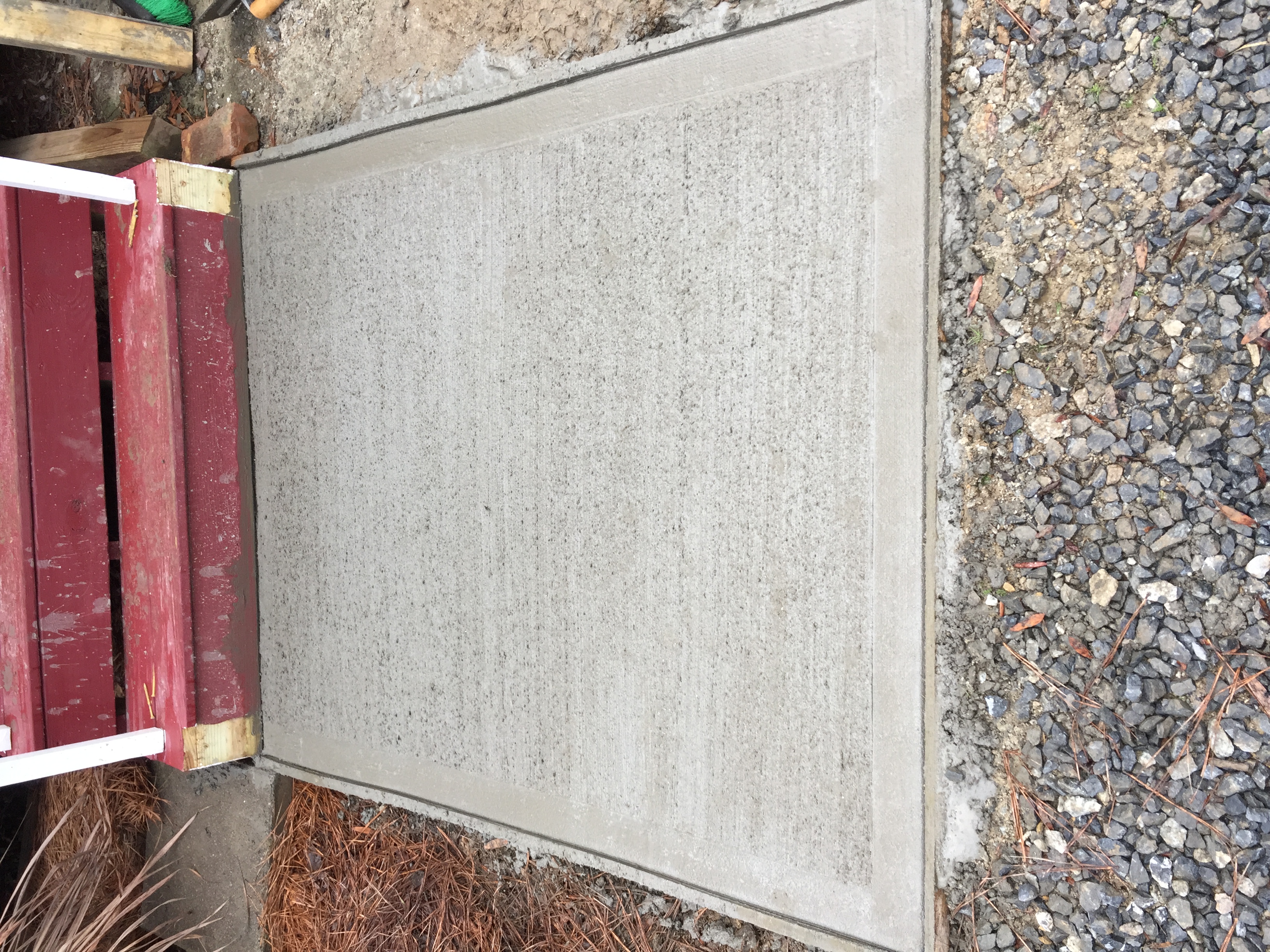

yesterday I poured a new sidewalk to our side porch. I used the FEL as my wheelbarrow to haul away what I dug out for the forms, then changed to the pallet forks to unload the 16 bags of concrete from the back of the truck. Today, I'm going to use it to take a pallet with some 16" square stepping stones around the corner to my daughters house because they need them for a project they're working on. Here's my sidewalk, didn't actually get any pics of the tractor picking up the pallet of concrete bags. That was 16 bags, 60# each....960 pounds was nothing for the front end loader, but the ride would have been less like a roller coaster if I'd grabbed one of the implements and put on the rear :laughing:

Looks nice! You apparently had more work mixing the crete than carrying it!

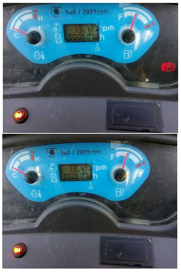

There is a thread on another brand where the OP got zinged by the manufacturer over a brake issue. Pedal wouldn't come all the way up and the dealer didn't think it was a big issue. Wore the wet brakes out and cost a bunch. No one knows why the pedal wouldn't come up or if it was the cause or not. But the discussion turned to brake indicators which may or may not have told him if the brakes were applied. The brake lights on our dashes are only for the parking brake, not normal brake use. I changed that on mine this morning. Added a $1.00 LED and a grommet I already had into a hole already in the dash. Just had to remove the existing blank plug. No idea what the hole was originally intended for. Ran wire to the trailer connector near the rear PTO shaft to get the brake light power;
Now I have a brake indicator that's on whenever the brake pedal is depressed (whether the operator is or not).
Also added a pigtail connector for a battery tender. Yes, I found the other two connectors for the key switch to get the entire shroud removed and out of the way.
