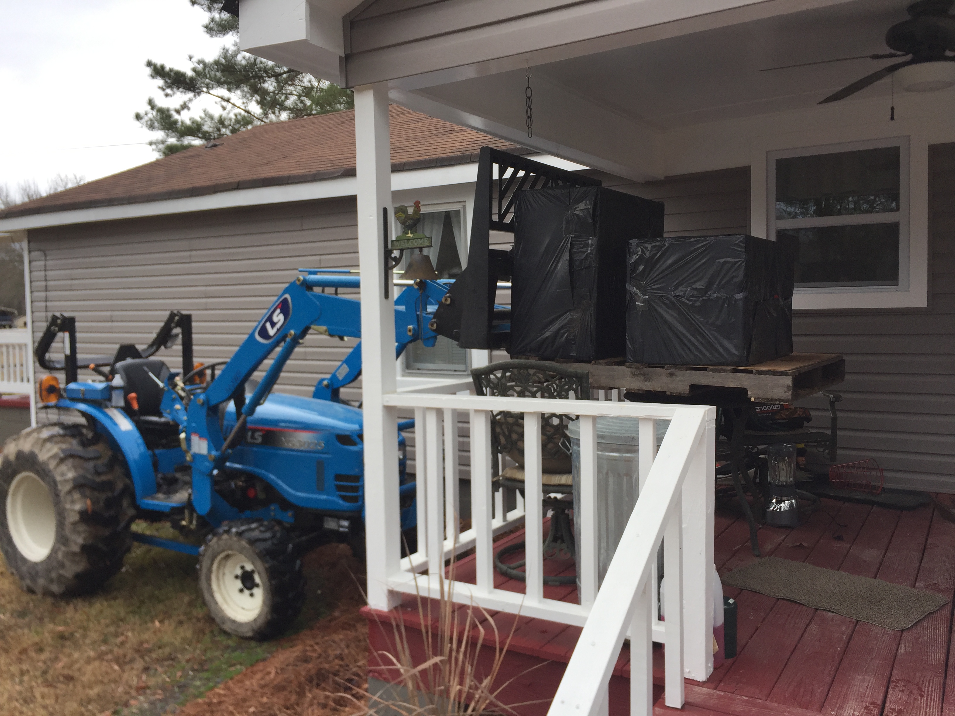

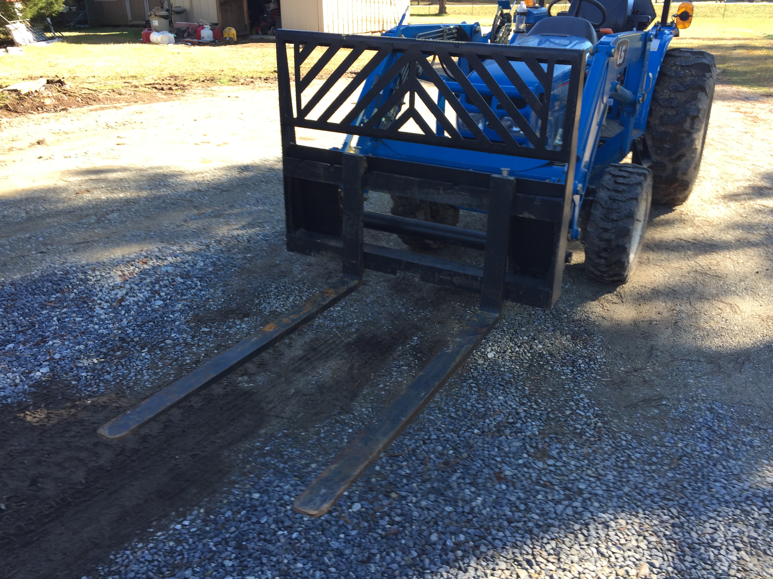

a few pics of the pallet forks I picked up yesterday...already putting them to good use, as we bought a couple of big presents for the grown up kids. Wrapped them with black plastic, and left them on a pallet. I'll move them from the garage to beside the porch tomorrow afternoon when the kids get here for dinner and Christmas celebration

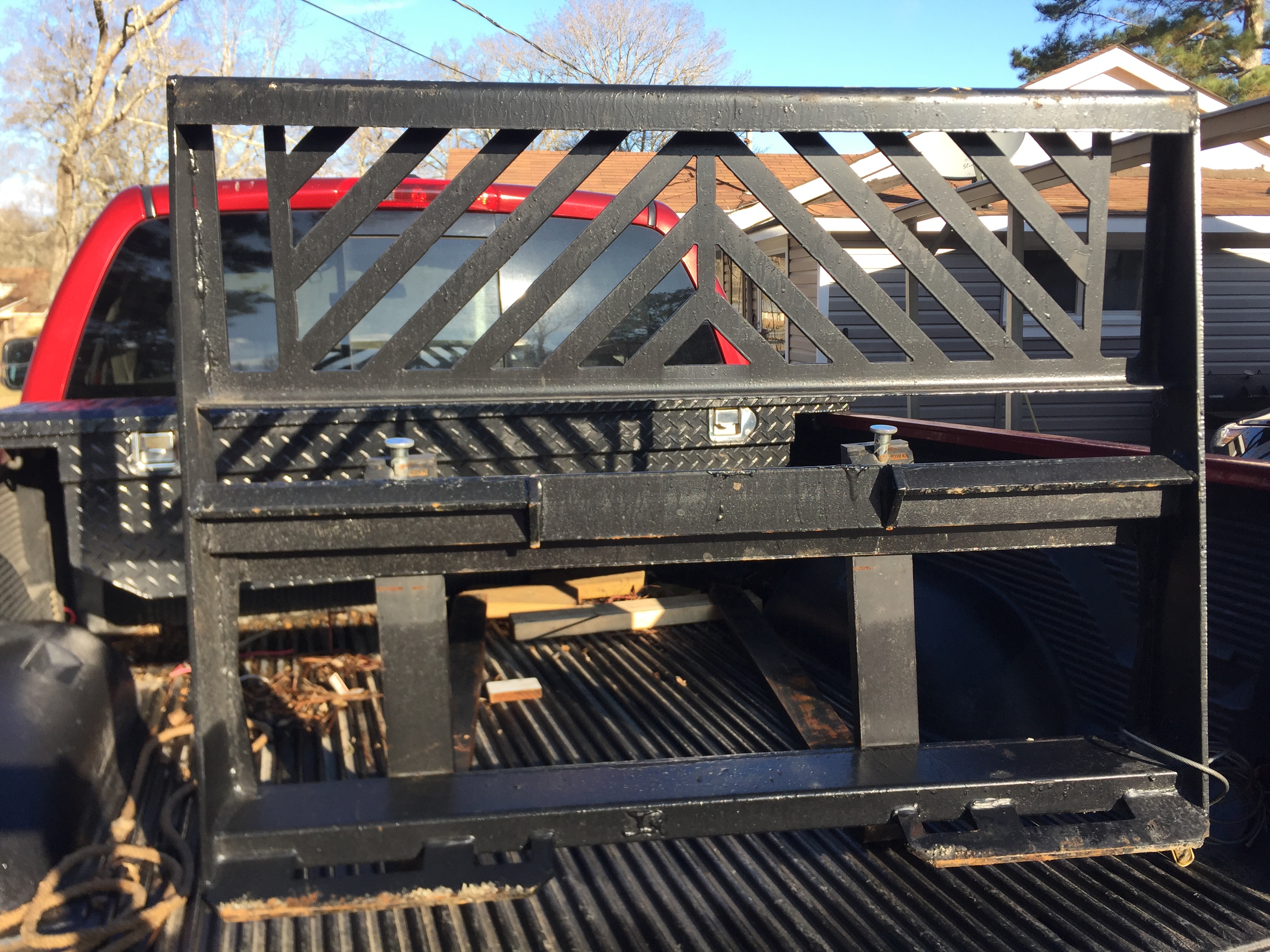

Who makes these forks? I like that tall back stop frame. Do you have a good view of the forks?
   / What did you do on or to your LS Tractor today? #313
I'll get you one later, we're about to head out. These are made by B Xtreme Attachments. These even have adjustable forks, not stuck in one place.I'll get a pic of his logo too. He has grapples, snow plows, blank QA plates, buckets, post hole diggers ect........really nice guy and once you become a customer, you get
discounts.
   / What did you do on or to your LS Tractor today? #314
When Santa needs hydraulics to deliver some presents, you may have had a really good year! These were for my oldest daughter and her husband. The pallet forks were part of my Christmas, so a good representation here

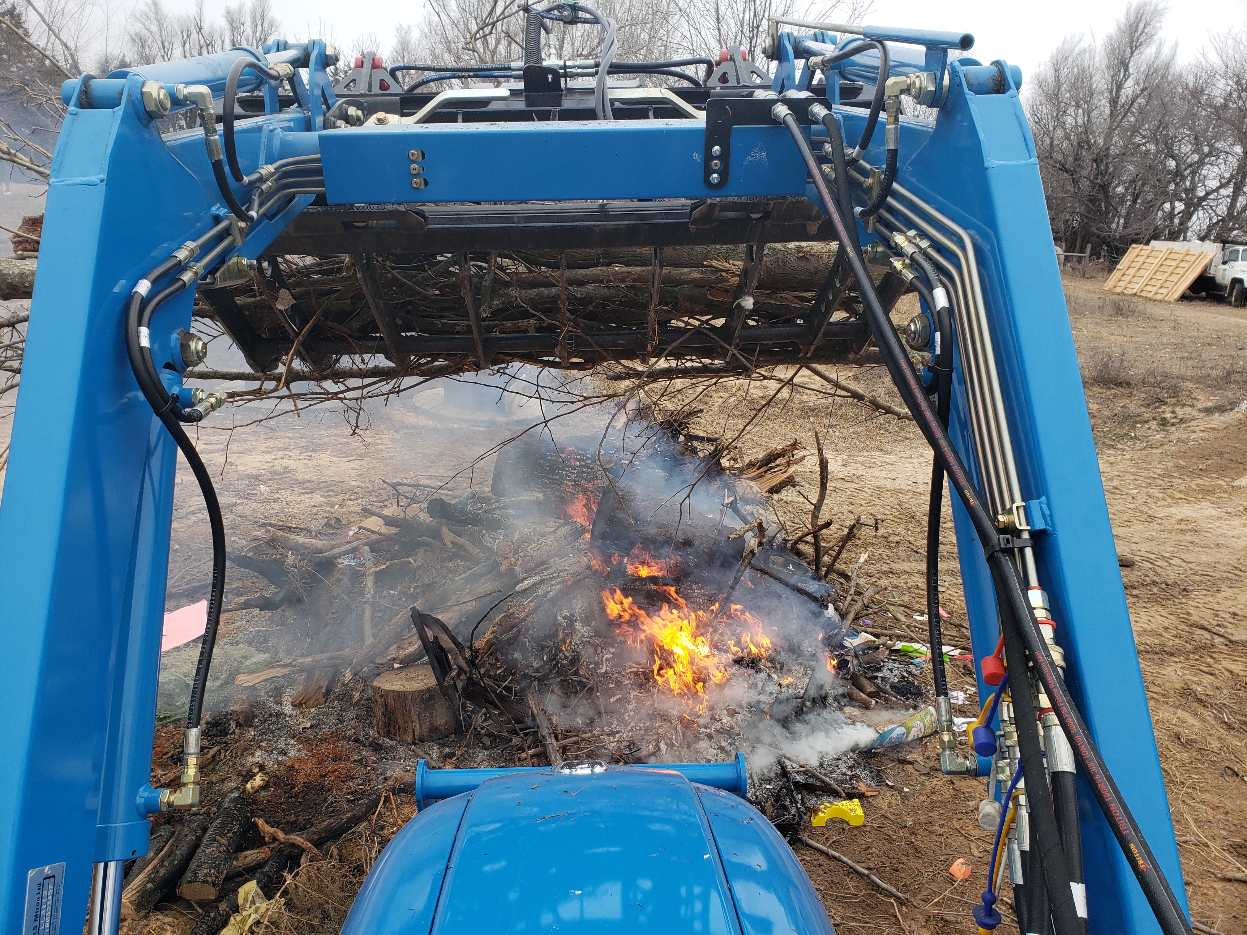

Burning off some ice storm damage from a few years ago.

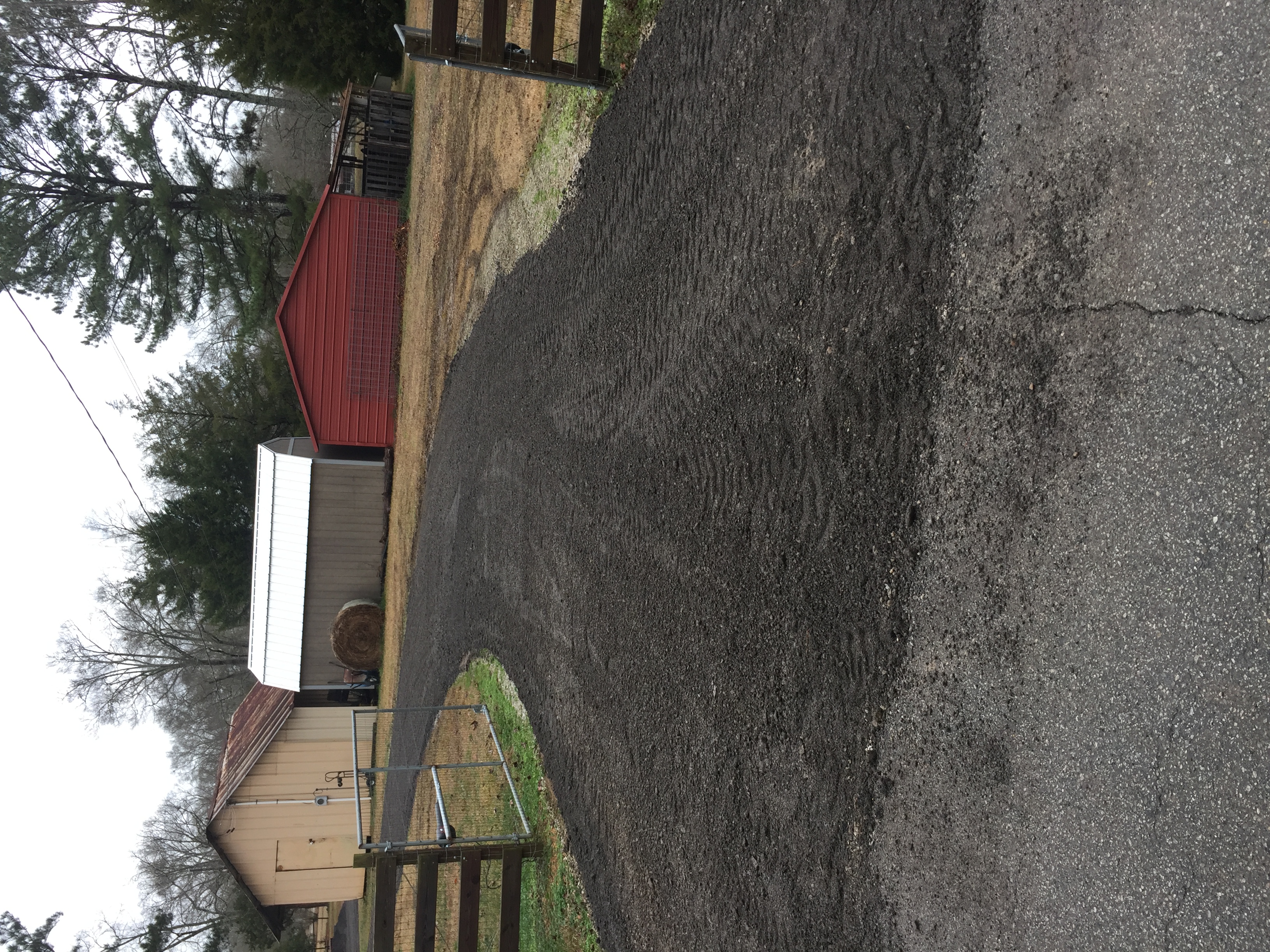

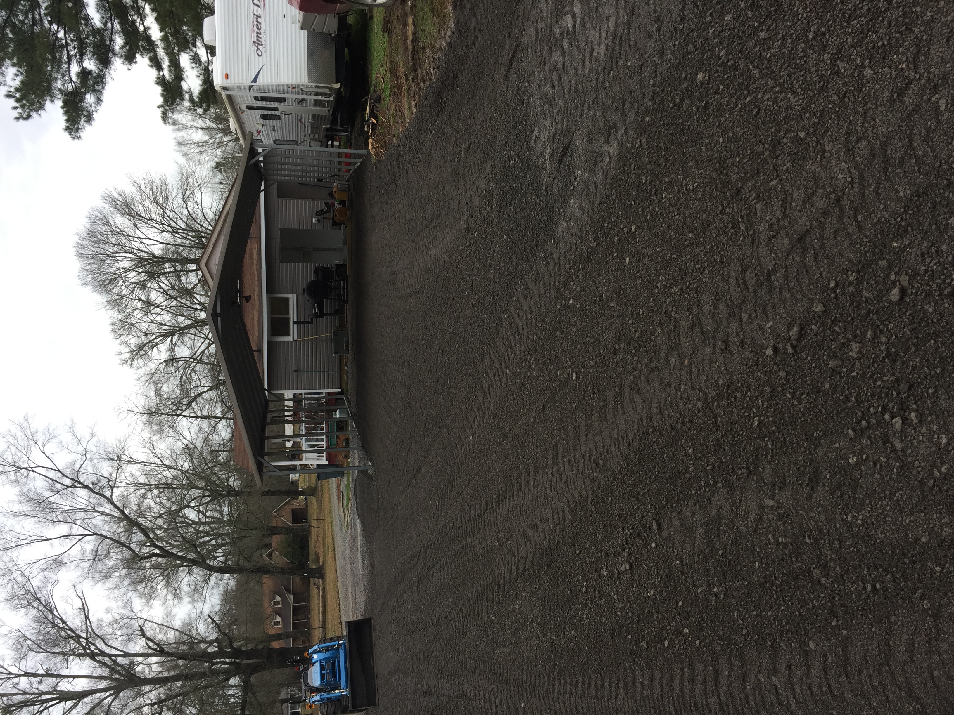

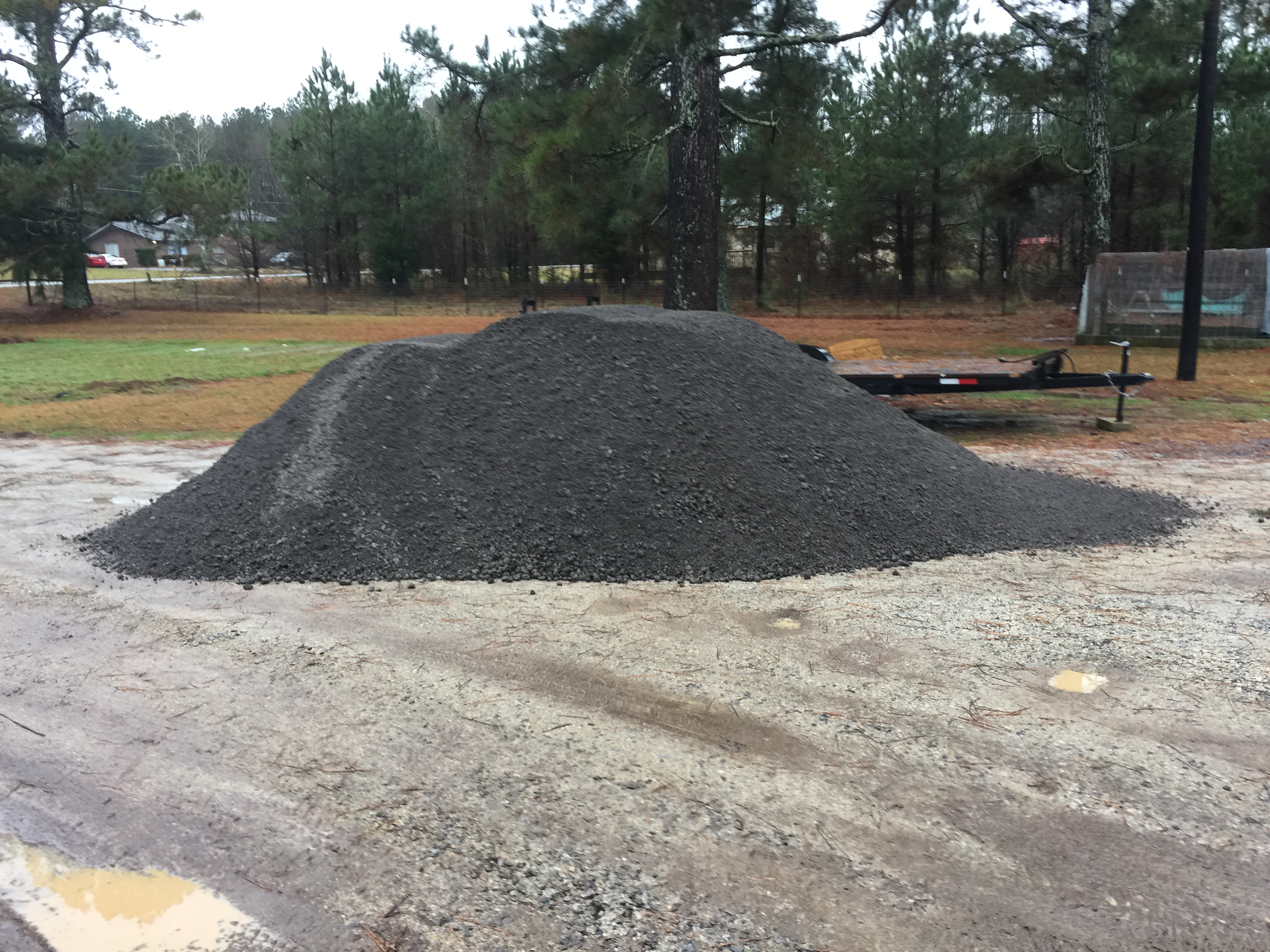

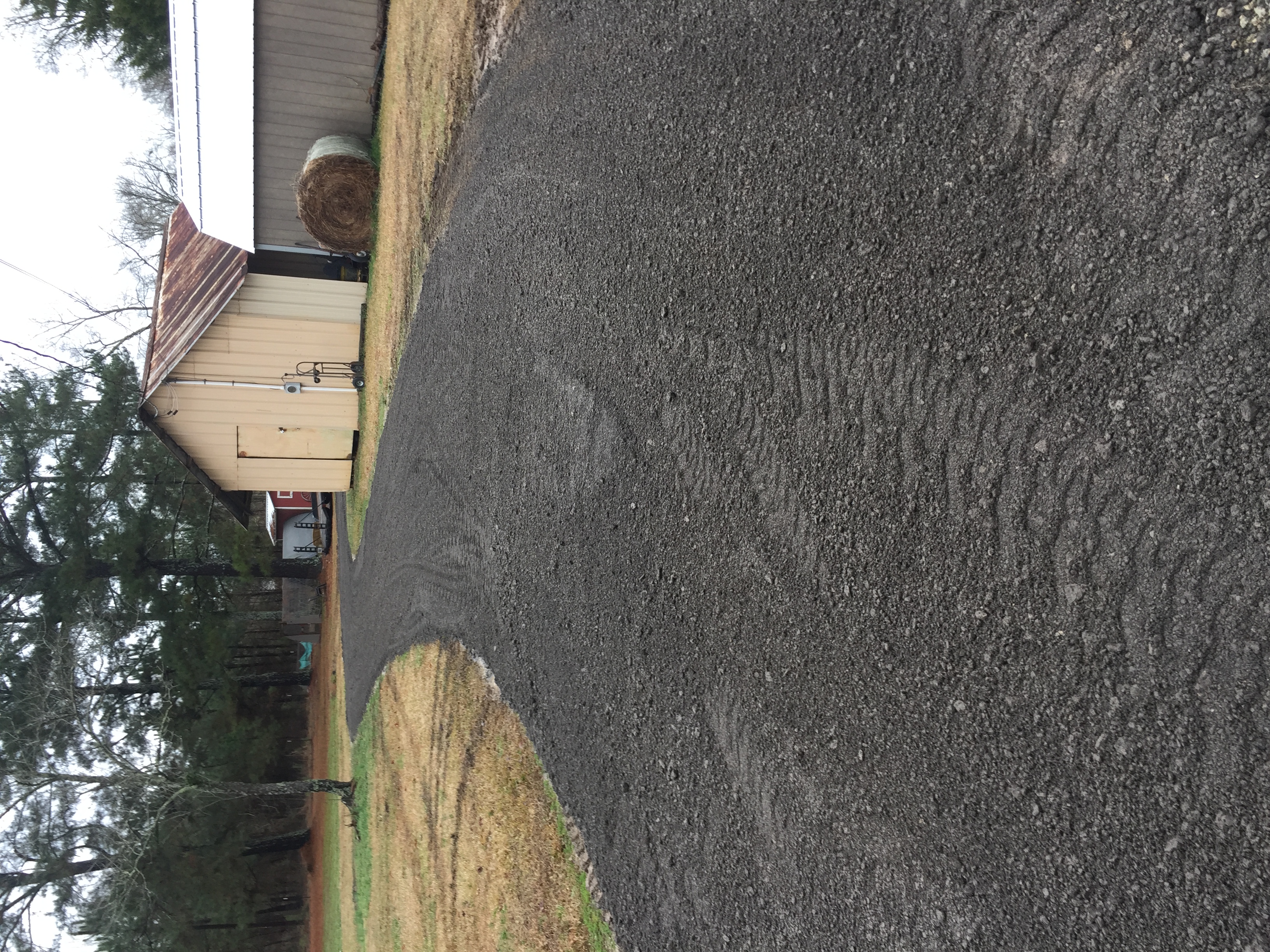

I had two tandem dump truck loads of asphalt millings delivered today. God to spend a few hours of ME time on the tractor spreading it...
really have to say I love the free float setting on the loader bucket, sure makes smoothing gravel easier for sure.

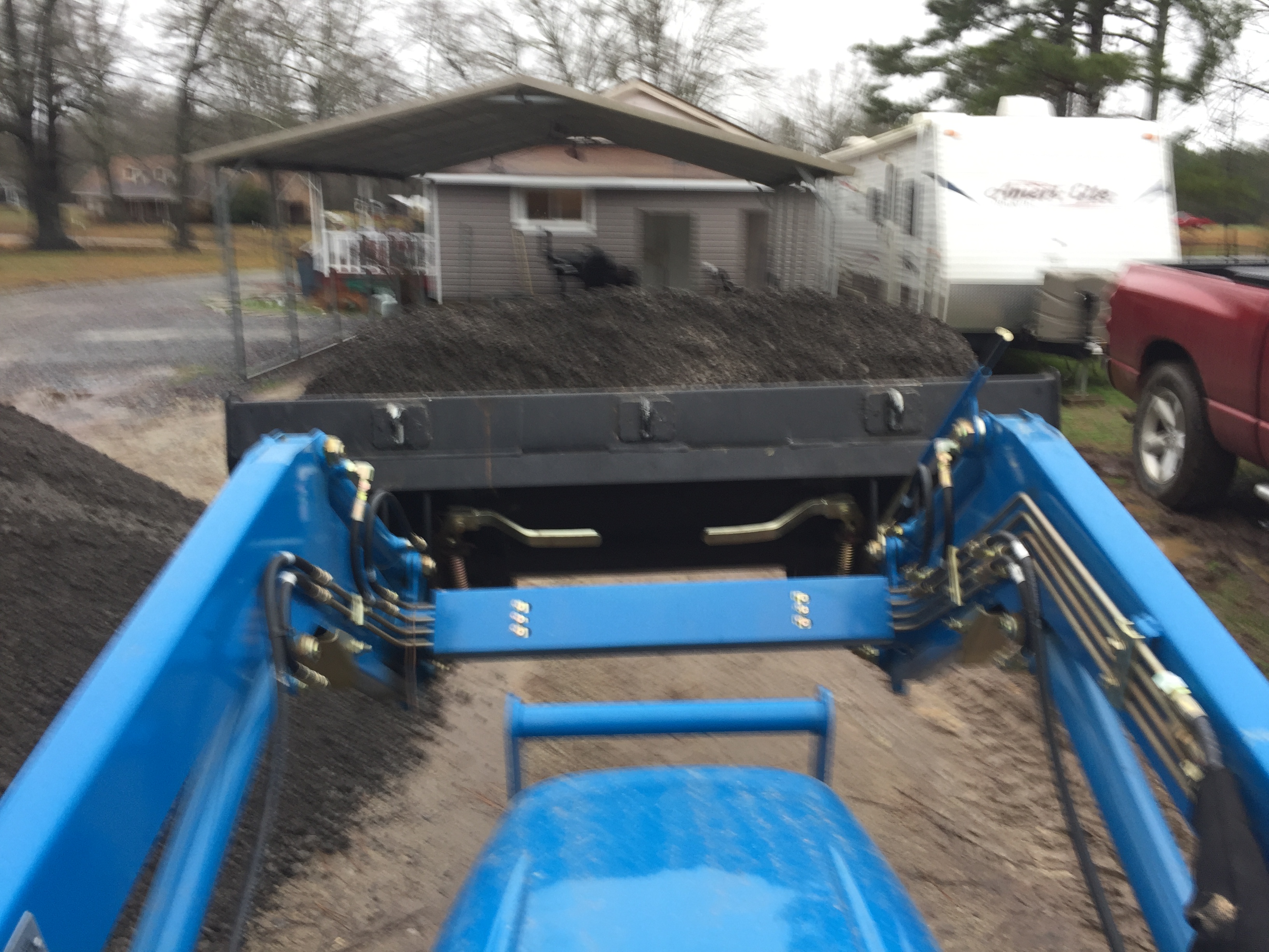

Ok, there's one pic I took because someone had asked me if this tractor would pick up a bucket full of gravel, so the answer there is yes....
   / What did you do on or to your LS Tractor today? #320
That looks super nice. I can't believe someone doubted the strength of tractor hydraulics. LOL.
