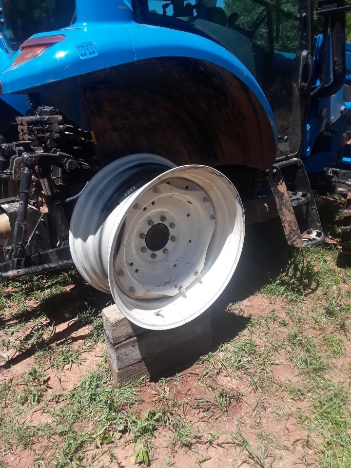

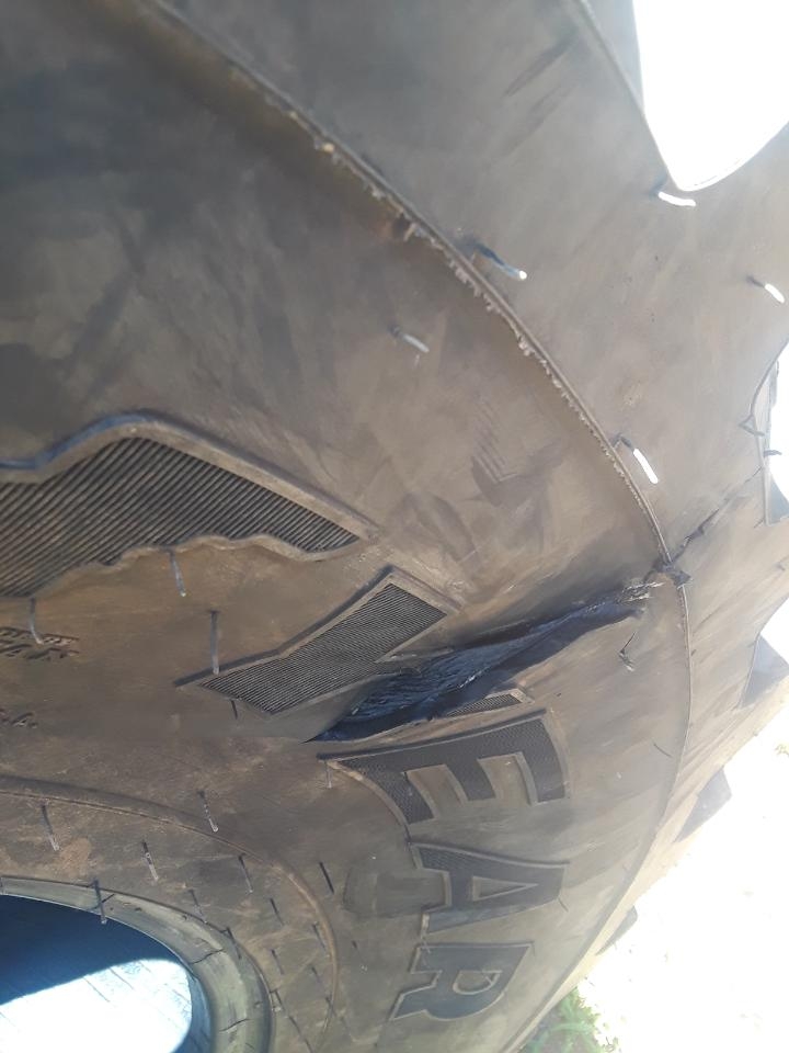

Speaking of tires...backed over an old split cherry or mimosa stump this afternoon when clearing for the power company to set their poles.
This is the result. Antifreeze spraying everywhere. I thought i blew a hose until the tractor leaned way over on that side. Good thing I wasn't on a side slope. Back tire on MT573.

Punch a hole or just knock the bead loose?
Well, here is the damage. Sliced right through the sidewall. Amazingly, the tire guy said he has seen them fix sidewall cuts, but only when they are straight vertical. Mine is vertical for about 4 inches then turn 90deg for another 1 1/2". He said that turn is bad. He took it anyway and said he will have the repair guy take a look at it.
No Goodyear R14T in the distributors and it shows coming from Goodyear direct will be minimum 10 days.
