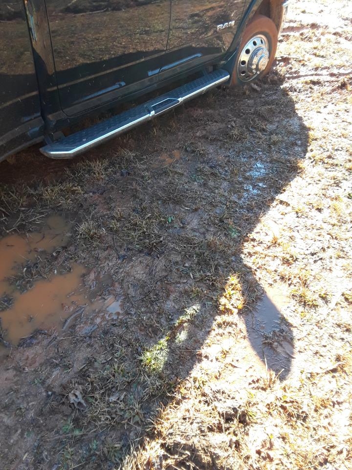

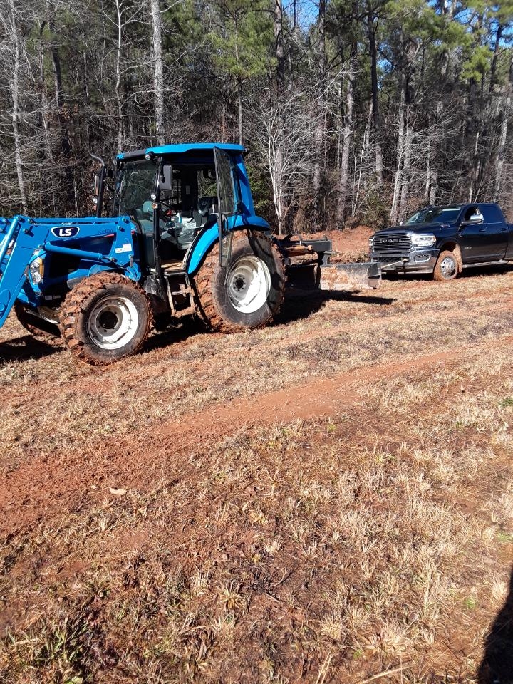

Heck of a rain last night. Turned the ground on my lot to mush. Luckily I keep a couple straps there. Truck was at the bottom of a hill and i ended up pulling all the way to the gate, about 600 ft.

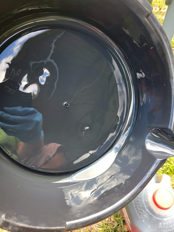

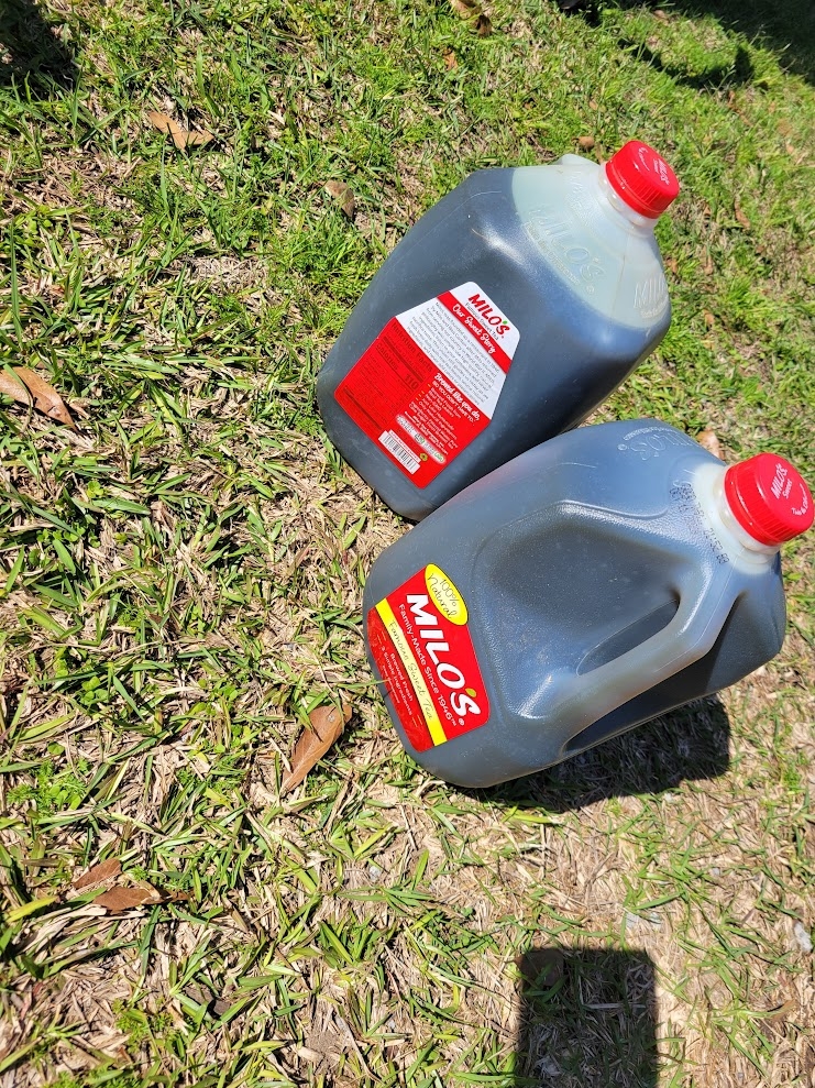

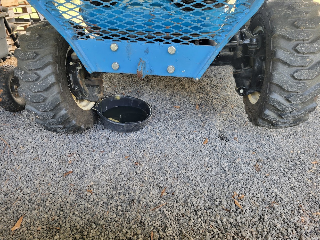

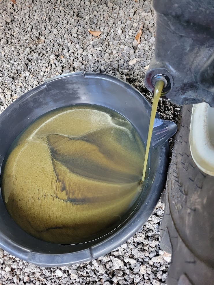

did the 500hr front axle oil change, used the bucket to lift the front and tilt the axle, also lubed the front axle holder and steering cylinder pin while it was up.
I ran the tractor for a bit before I drained it, the discoloration you see is all bubbles. The oil looked great, once the bubbles settled out, there was no metal or metallic discoloration at all, I was surprised since this is its initial oil change. Put 75w90 synthetic gear oil back in, that might help with foaming too.
Only took 1.5gal to the top of the dip stick, after 30+ min of sitting after moving to the level garage floor. I'll check it over the next few uses to see if the level changes. Manual calls for 1.7gal and I removed almost 2.
