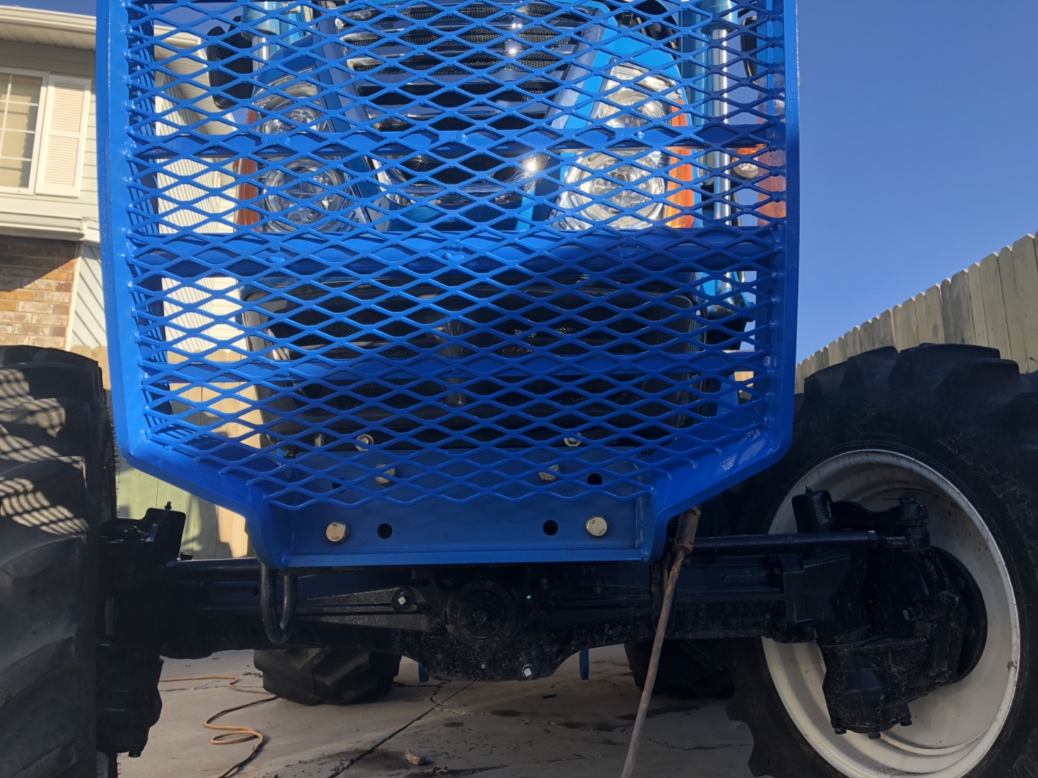

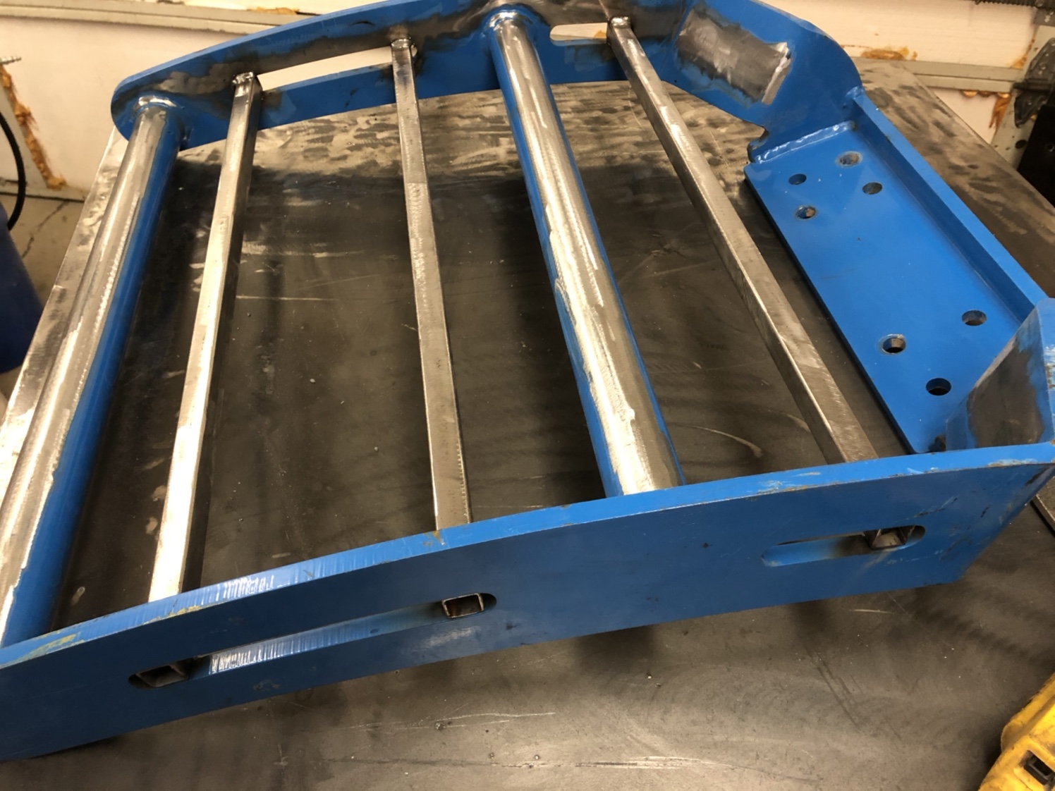

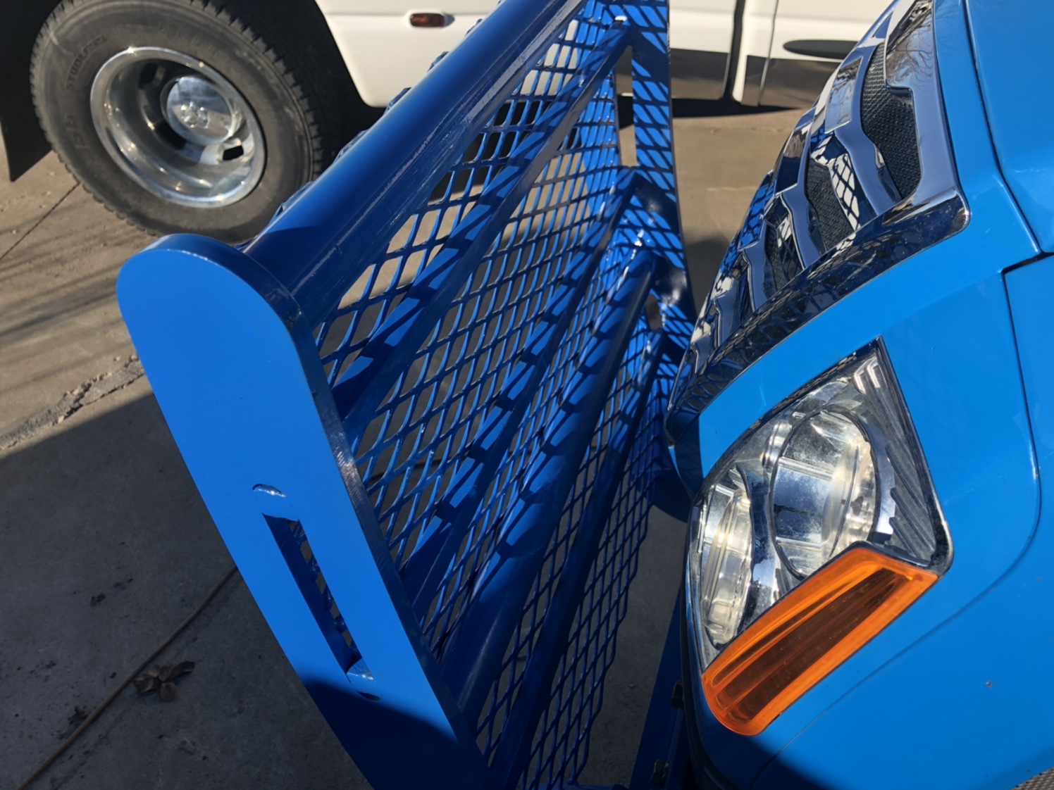

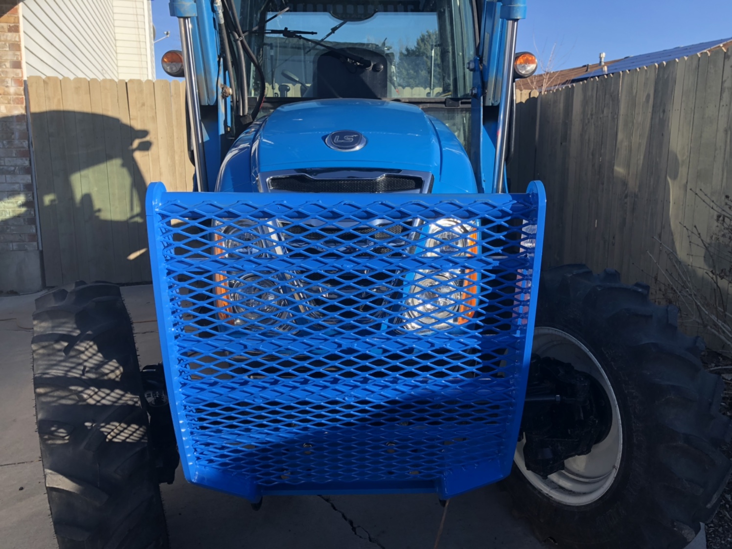

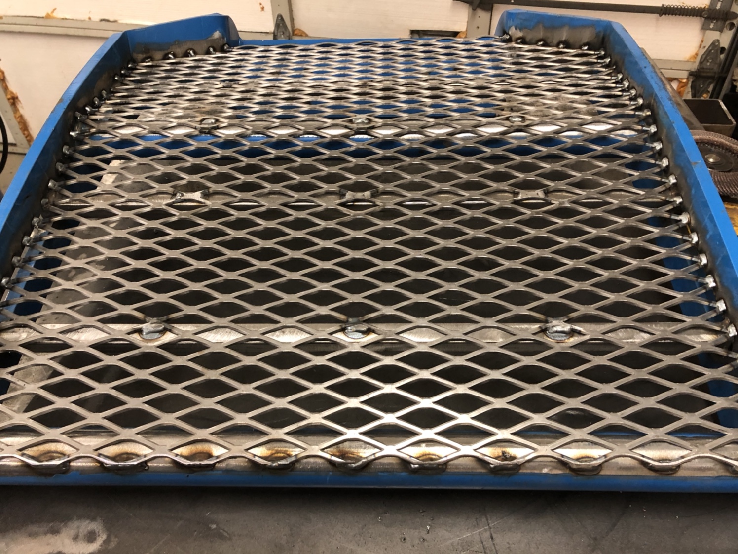

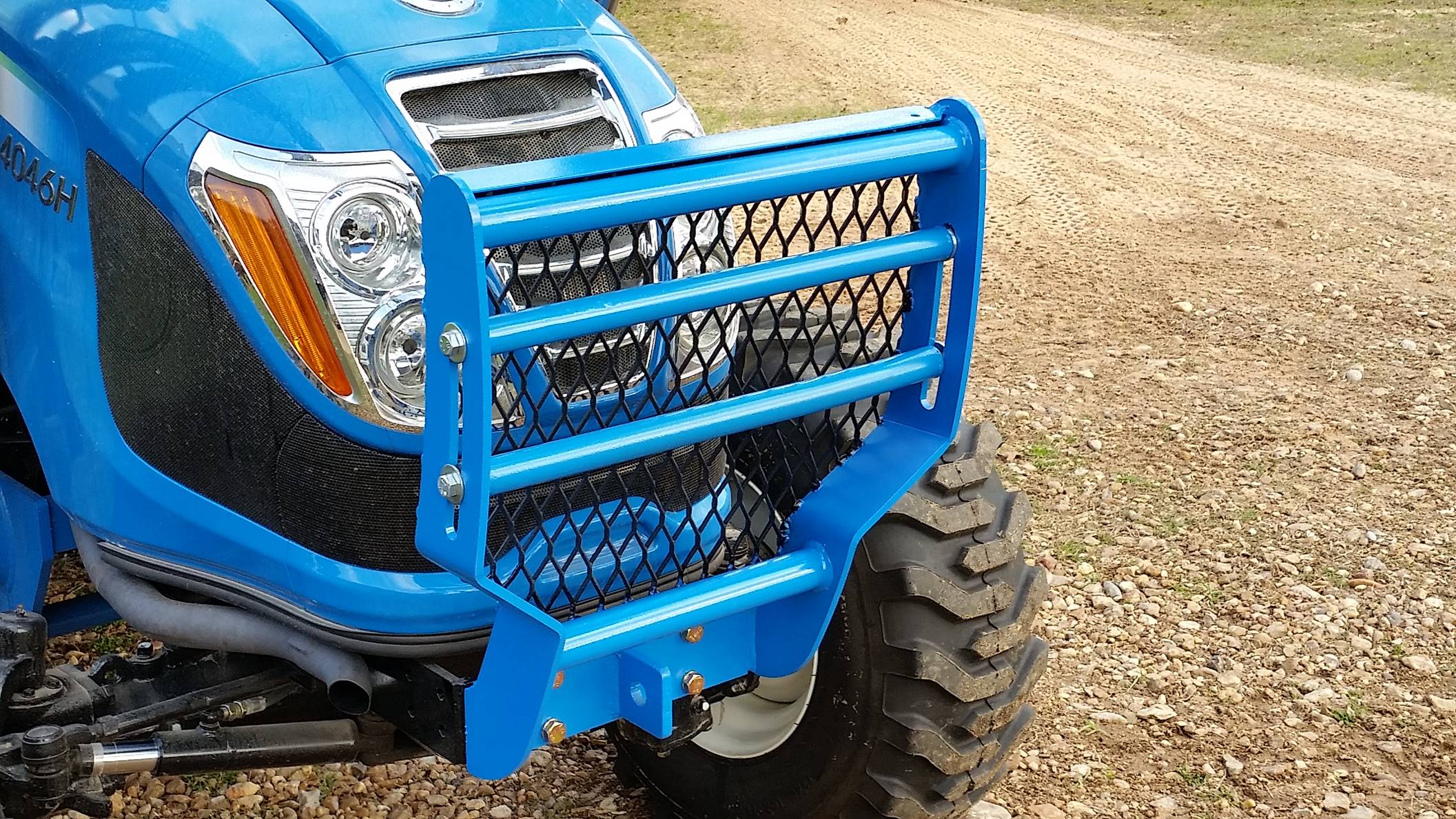

I have a grapple coming in a couple weeks, so I ordered a 2x2 piece of flattened expanded steel from McMaster and made up a grill guard.
I just happened to have some 1” square tube that fit perfectly in the slots in the factory push bar.
I used the small Lincoln 220v mig welder with .023 wire to glue it up.
I had read somewhere that Rustoliem “sail blue” was a good match for the LS, so I ordered a couple cans from Amazon since I could not find it at my local hardware stores. It did not match as well as I had hoped.
Overall, I am very happy with it. While I do not intend to use the grapple for moving brush, since I do not have enough trees, I figure that the one time I try to grab some sagebrush, with my luck I would get a stick through the radiator.

Really nice work!

3Lfarms, very nice job on the grill guard!!!!! :thumbsup:

I used the .120 thickness flattened expanded wire. It is a little more expensive, but it is nice to work with without the cheese grater feel to it.
Click the flattened filter on the left of that page, then it’s the thickest carbon steel stuff listed (at the bottom). Some of the thinner oddball sizes are actually more expensive.

Nice work .. you won't regret building it.
   / What did you do on or to your LS Tractor today? #1,689

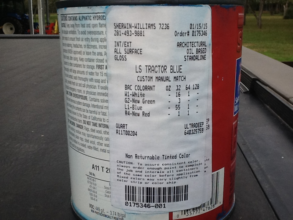

Nice job on the grill guard! Safety blue is the closest match to LS. Very hard to tell the difference unless original paint is faded.
Not sure if all the LS dealers have it, but mine provided an aerosol can of LS touch up paint.... I believe it has a part number on it.
   / What did you do on or to your LS Tractor today? #1,690
Yep, Safety Blue is "close". When I took my grill guard off to modify it, I first stopped by a Sherwin-Willams paint store, had them scan it, and bought a quart of enamel.
John gave me a can of the LS too.
