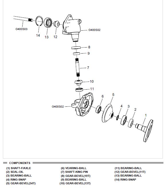

Could it be something as stupid as bolt(s) 6 or 7? I'm not sure if that cavity is oil filled or not though given the location of oil seal 9.

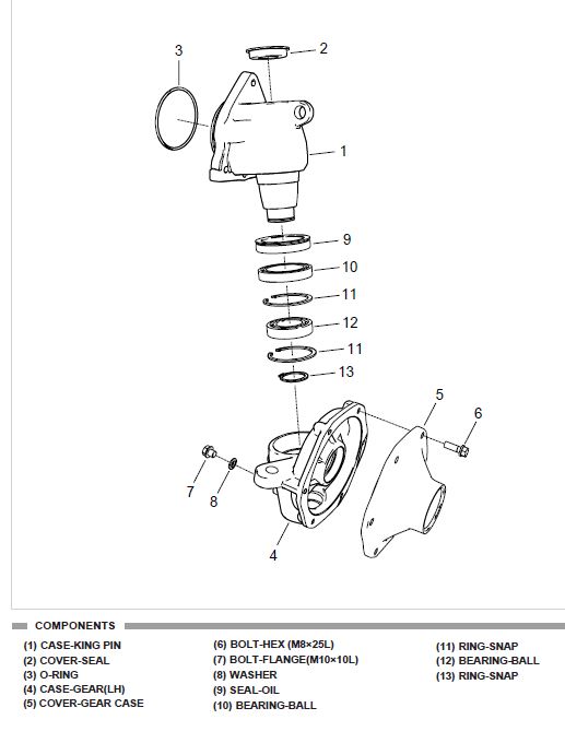

Couple pages further on is this diagram that shows another oil seal (2) which means that cavity must be filled:
attachment.php
It's 25 and windy, so I won't be out there today pulling a wheel to inspect further.

Yes, the best step is to figure out exactly where it's leaking. If it's just the hub shaft seal (#2 on the 2nd picture) or it's actually the knuckle seal (#9 on 1st picture).

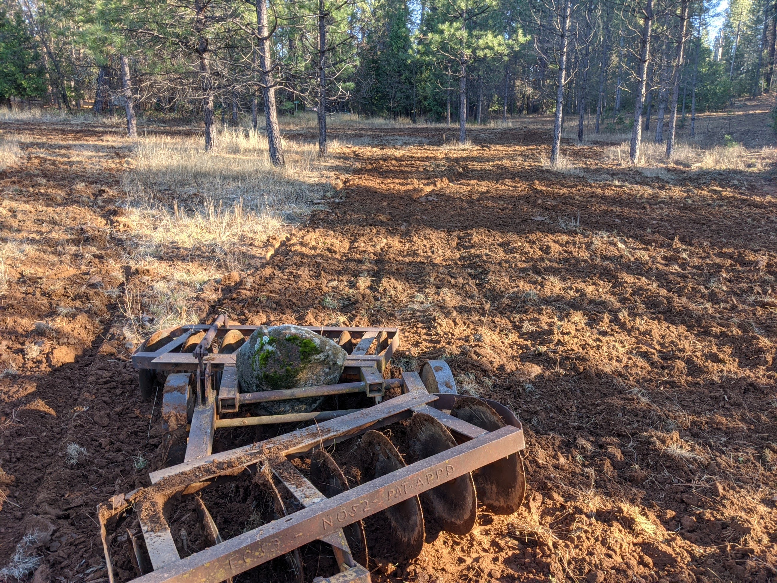

Moved some firewood and dragged Grandpa's disc around for a while.PXL_20210123_230048727.MP.jpgPXL_20210123_181714981.jpg
