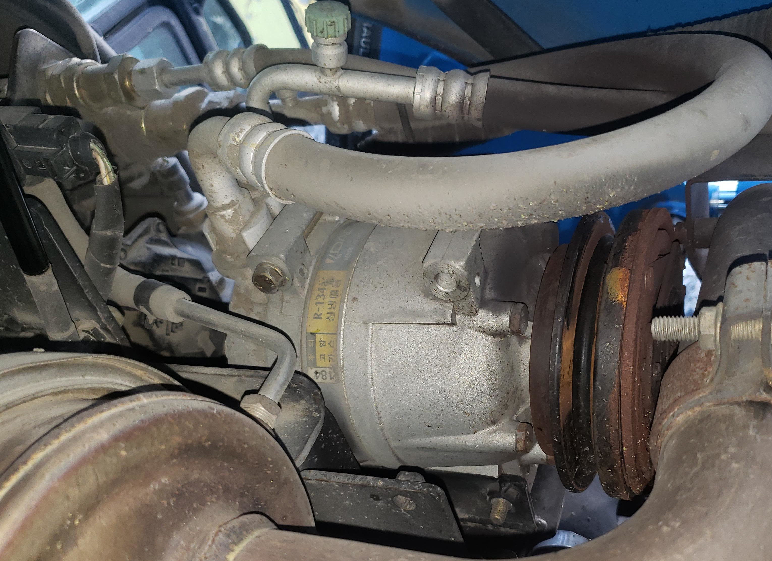

Like today I am trying to find a replacement compressor for this tractor. If I post a pic of the compressor is that ok?
I will even post an aftermarket part number if I can find one for anyone else that may need this. Is that helpful enough to pass your post standards?

January 2018 – about 220 hours (back in the shop)
The 2-year warranty is about to go out and I still have issues that were never fixed! Contacted Dealer about my list of issues and they told me to drop it off January 2nd to get it all done before the warranty is out.
• Requested they do the 200-hour service. I do my service at the dealer when under warranty so I do not get warranty rejections because I serviced it myself.
o They said they would cover this one because of all the issues I have had.
• The AC is still not getting cold and it starts to fail after about 30 minutes in hot weather
o Dealer said it needed a new belt to fix the issue. The belts were squeaking so that meant they were slipping and causing the issue. The AC load will make the belts slip if they are not really tight and then it does not get cold. Put on new AC belt.
• Tractor still will overheat when mowing or using for over an hour or so even if the radiator is clean.
o Dealer said it was also a belt issue and the fan must be slipping not cooling the radiator and AC condenser. Replaced fan belt.
• The metal piece between the hood and windshield rattles a lot and seems to be coming loose.
o The rubber weather strip between the metal and the windshield was not installed on this tractor. All the others have it. They put on the missing weather strip.
• Quick attach levers are still sticky.
o Dealer: The loader only had a one-year warranty. They put on some grease. I grease them all the time, that is not the issue.
• Transmission case is leaking oil somewhere. Leaves a small puddle where parked.
o They can’t find a leak anywhere.
• The forward and reverse drive peddles are sticking and putting me in dangerous situations.
o They said the fix for this is a new Damper for the HST control. They adjusted something on the hydrostatic peddles or something like that also.
February 2018 – about 225 hours (back in the shop)
• The hydrostatic peddles are sticking even worse now. Before it was sometimes, now it’s pretty much always and I have to hit the opposite peddle to get it to stop.
o Dealer: We think it's the damper being too tight. There isn't any setting or adjustment on it. We do have the old damper that we can put back on. We need to fix the pedaling sticking.
o They ended up asking me to just use it for a while because it’s probably a break-in issue with the damper. It got better, but have never went back to the way it was when I bought it. It will still stick on me and make me almost run into things.
• The low power issues seem to have gotten worse. Same issue with 2nd gear not making it up the hill, but now I see the issue in other areas too. Am I losing HP? Is there another engine issue?
o Dealer: They don’t see any power lose compared to other tractors they have on the lot. Seems ok to them. Maybe it’s in my head they suggested because of all the issues I have had.
April 2018 – about 250 hours (back in the shop)
• The tractor is intermittently throwing an error. I get limp mode and a red square with ! in it and saying code F02 637.
o Called Dealer. They told me to check my manual. Page 3-46 just says it’s an "Engine error warning indicator". Dealer told me it was a "cam signal drift fault" and to not use it.
o Brought in the tractor to get fixed, but 2-year bumper to bumper warranty is out.
o Dealer had a 3-week delay because they apparently have to ship this one laptop they have back and forth from location to location.
o Dealer said it was a "camshaft position sensor". They ordered it.
Dealer: I just got done talking with the person in charge of warranty with LS, he informed that the camshaft position sensor is not covered under the powertrain. You are looking at a cost of $200.20 to take care of that, just wanted to make sure before we get it and repair it with a cost to you without your approval. Let me know.
ME: How is a "camshaft position sensor" now covered under the powertrain warranty?
Dealer: John said he will call LS and see what he could do.
Dealer: Its actually not a "camshaft position sensor", it’s the wiring harness. I confirmed that you do not have the updated wiring harness and we've ordered that today to replace it under warranty. That will give me a lot more confidence in telling you to expect a more trouble free experience going forward. There is an updated wiring harness that these tractors were suppose to get but yours does not have it. We will replace the wiring harness for you under warranty.
o Putting in the new "updated" wiring harness fixed the issue.
• While the tractor was in the shop once again, I asked about trade in because it’s in the shop too much and I don’t see others having this many issues. LS should do something for me with all this headache. This machine is a lemon. I can’t use it. I have had to buy other tractors to do the work that this tractor should be doing. I want my tractor switched out with a new one.
ME: Can you tell me what the trade in value on my tractor there would be? It’s in the shop way too much to be a primary tractor. It has 250 hours on it and I can't count how many issues it has had. Maybe this one it just a bad apple. I had my John Deere 3032e for 3 years and never had to take it in. I worked that tractor harder than I do this one.
Dealer: Yeah, I understand. It's been really frustrating for us too. I'll work on this and get back with you asap.
Dealer: LS is not going to provide any assistance. I can offer $17,573 trade in value.
ME: Really? Deal with all this and also lose $10k for issues out of my control? I am at my end here. LS should be working with me on this.
• The 4x4 lever broke off. This has been a real pain to use since day one.
o I had told them about this issue not long after I got it, but they said it was “somewhat normal” to have to work it to engage. It’s because of the gears.
o They said they would fix it under warranty, BUT…
o Dealer: As far as the 4x4 shifter there are a couple of the pieces we need that are on back order.
o I asked them to order the parts and let me know when I can come get it fixed.
o I have still not been told when I can come get it fixed. They just want to weld it instead of put on new parts. I don’t want my tractor in the shop forever again. Will wait for next issue that I am sure will come.
[ During this time, if something broke, I just repaired it and did not call Dealer. The bumper to bumper warranty is out and I did not want to deal with anymore dealer headache. Many items broke that I fixed.
• Still can’t mow much with it or it will overheat even though the coolers and radiator is spotless. Dealer says it does not happen and has had more than enough of my time to fix it.
• Still can’t get up hills in my property in 2nd gear when I use to have no issue. Still have to use 1st gear on small hills.
• The AC still does not get cold and started to not work altogether after about 30 minutes of use. (update: now the compressor is locked up)
• The FEL quick connect handle finally gave out.
• The metal cover behind the hood vibrated itself off so I welded it back on.
• The hood latch came off.
• The gas cap broke.
• The FEL stick started losing the screw on knuckles inside of it so I took it apart and used Loctite.
• The weather stripping started coming off again under the hood so I glued it on.
• The front windshield wiper will no longer works correctly because the bolt that holds it to the windshield is stripping out and will not stay tight.
• The windshield wiper water pump went out.
• The safety switch on the seat once again stopped working and I had to make a loop to get the tractor to run again.
• The AC controls in the cab fall out with any big bump.
• FWD and REV peddles still stick from time to time and put me in dangerous situations.
• And on and on and on…
