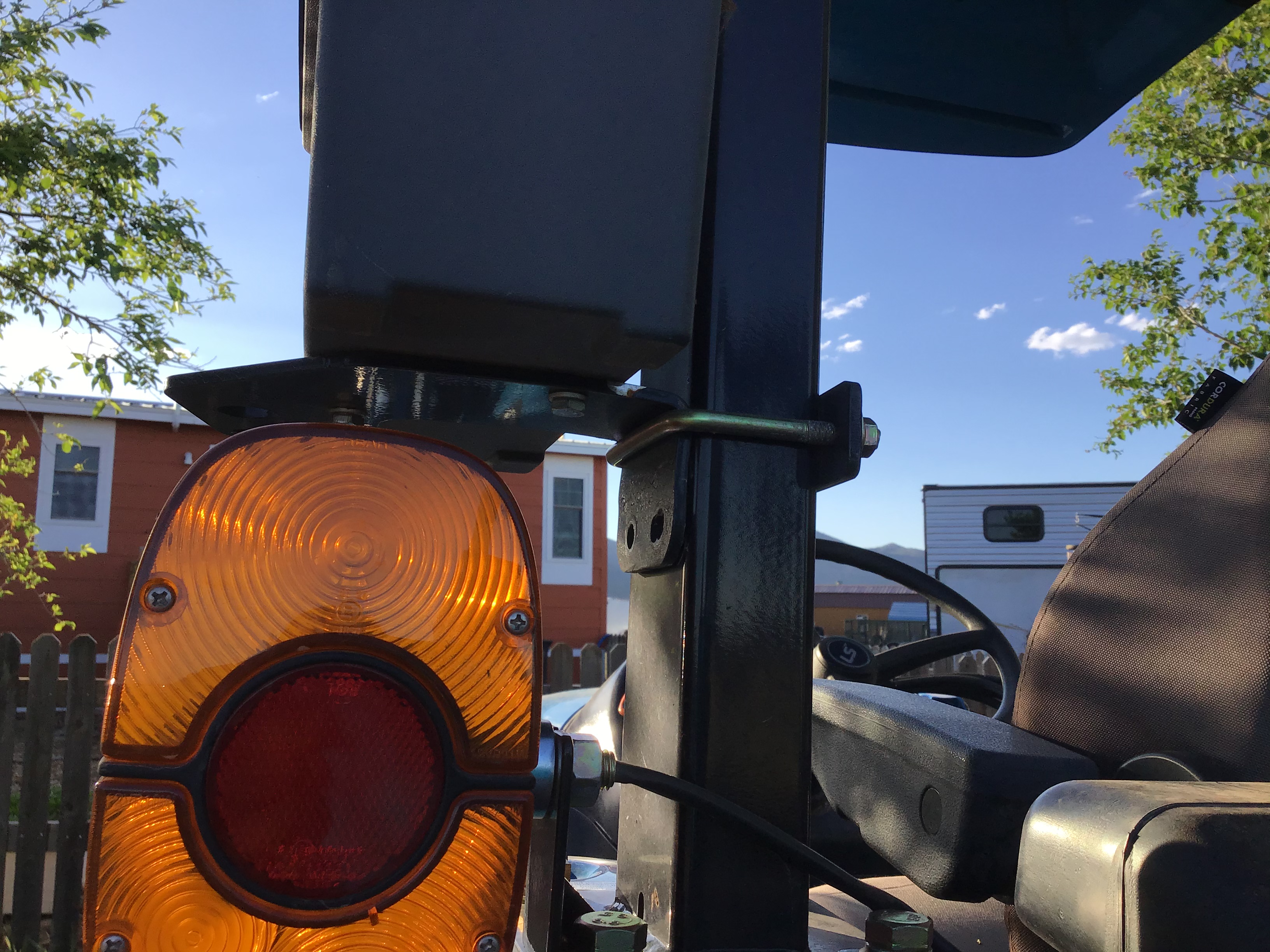

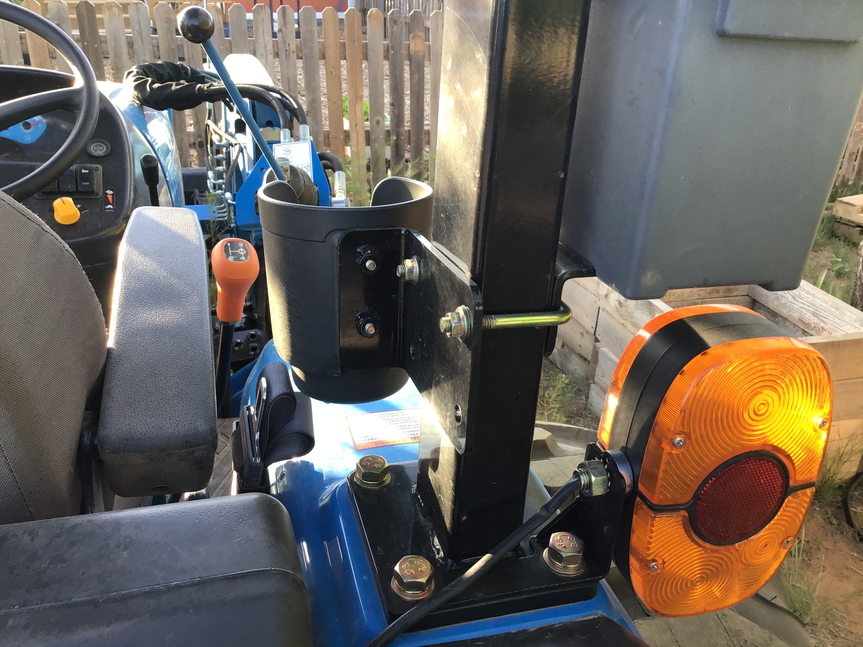

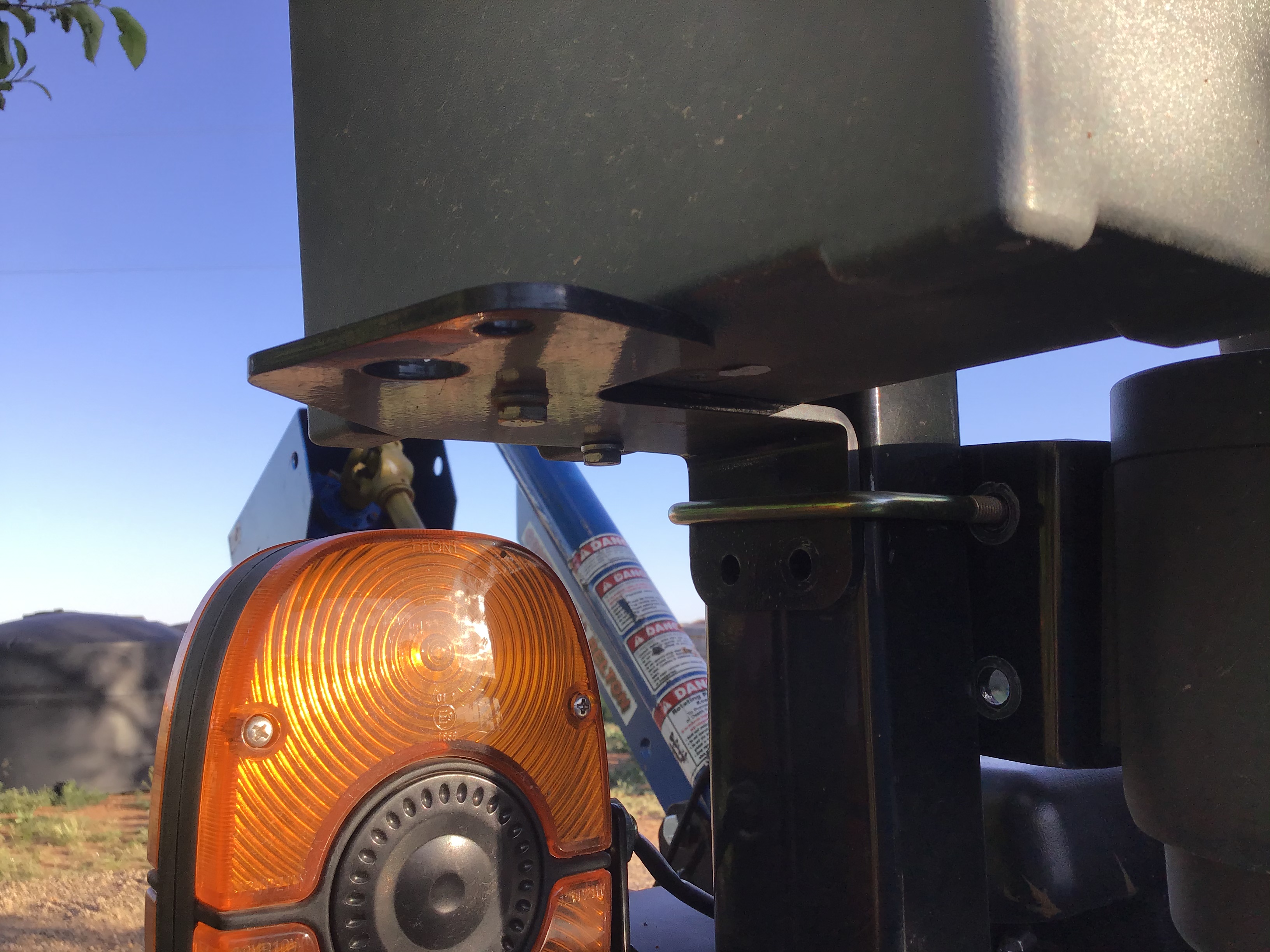

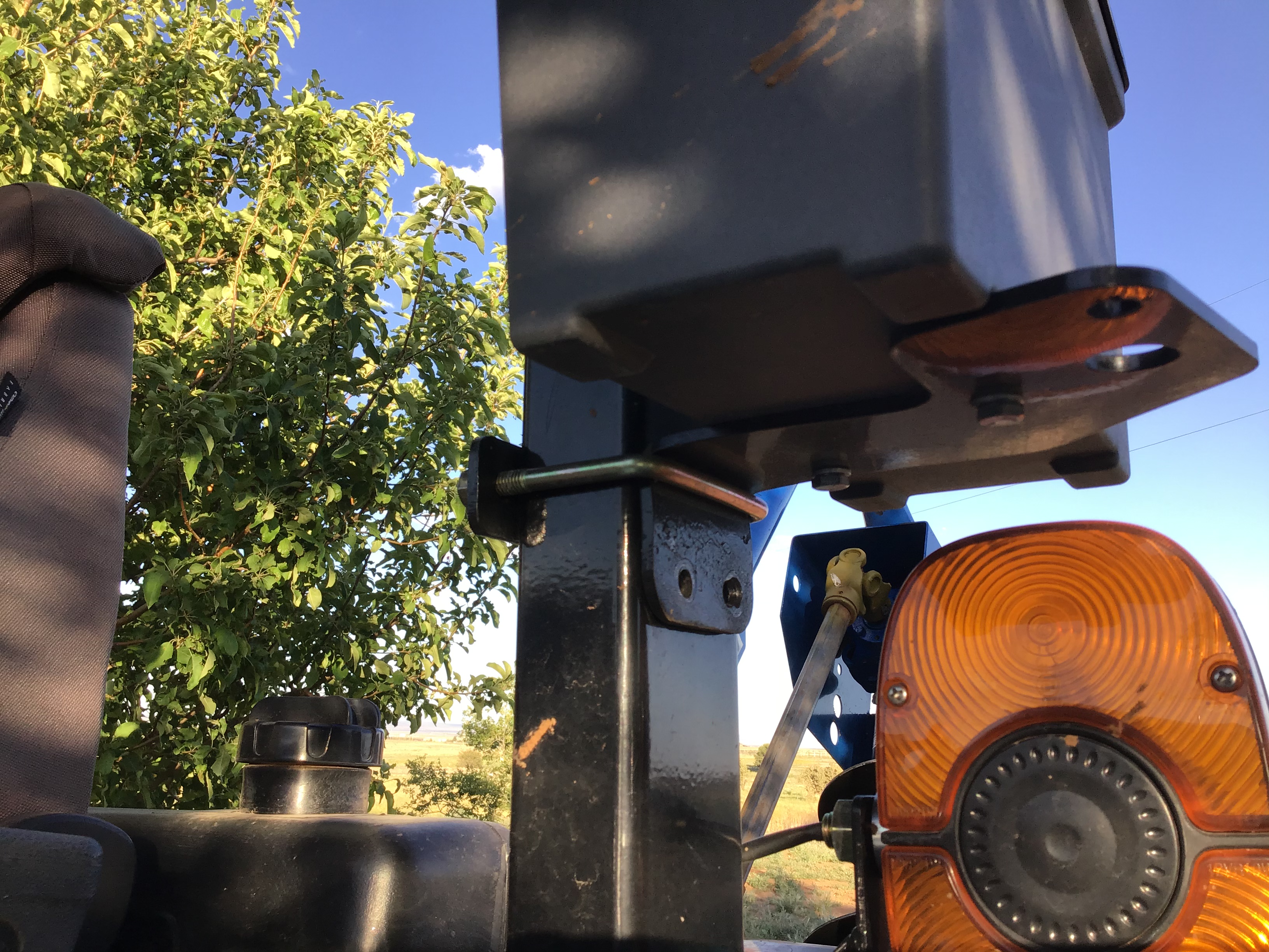

Someone was inquiring about how I mounted the ammo boxes to the ROPS. I had a couple of brackets left over from a Jeep bumper that were mirror image of each other. I used the LS U bolts from the cup holder (they put it on with two... way overkill) so used one on each side. Nothing has moved or loosened over the past 8 months, so I think they are good to go. Here are a few pics of the mounts.
My neighbor mounted his with winch mounting brackets he got at HF for around $5 each

OK, so you did a T, I did an L, somebody else did twin Is, I think I saw one C layout (or was it a U?) .... we'll have the whole alphabet before long.
I was going to try an A .... that way works forward or backwards.... :D

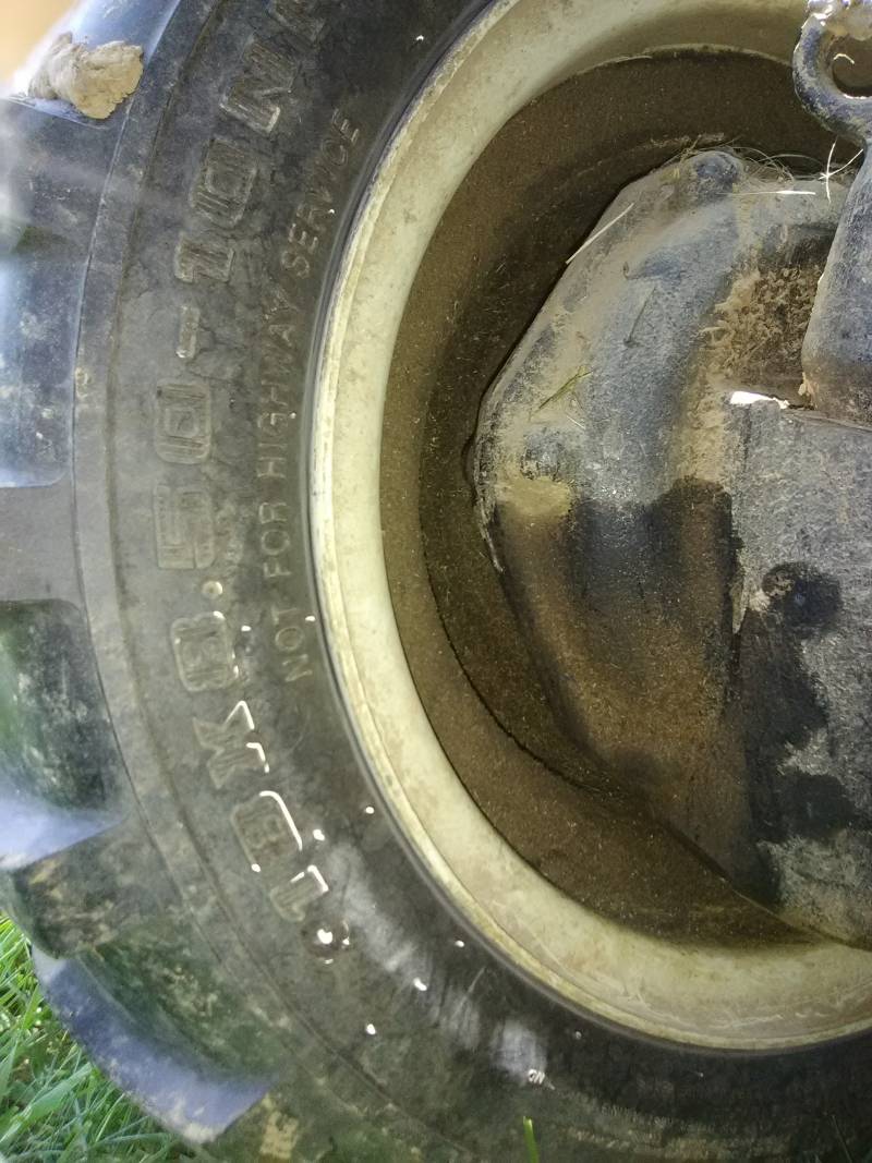

Last thought, noticed some 'wet' dirt around the left front axle, like oil/grease wet. Need to look into that more in the next day or so.

Sooo, anything to be concerned about? Left Front only. Nothing similar on the right side.

How many hours are on it? My dealer in Spokane ( Cascade tractor) told me to change the oil in my front axle at 50 hours even though the service manual States otherwise. He said during the first 50 hours there’s a lot of metal shavings that can cut the seal if it’s not changed. Personally I would be concerned as it’s probably only going to get worse.
   / What did you do on or to your LS Tractor today? #1,220
Did you have it parked on a slope towards that side? I had parked my 125 on a slope for a couple of days and had a similar “ wetness “. I cleaned it up reall good and kept a watch on it. No other leaking occurred, so I attributed the initial leaking to all the axle oil pooling over to the downhill side.
