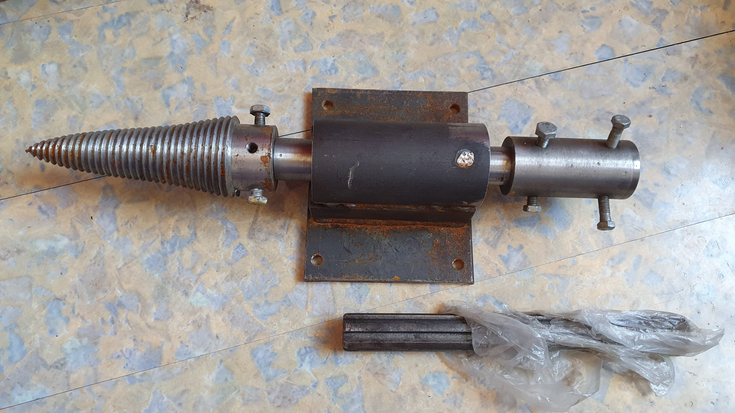

This probably will be my first attachment for this GB-15. 🤔:rolleyes:
I've bought it from a man who made it (lathe operator) for €70. They are more expensive here on the market than this price.
I will arrange it on a 3pt pallet forks which I'm gonna make myself so it'll be 2 attachments in one. I'll put that splitting screw on a steel plate, which will be screwed onto the forks. It'll be removable. Not a lot of work, not much expensive, hope it'll work well.
/ What Did I Purchase? #63
Be careful with this style of splitter. It can get really ugly really fast.
Weld a piece of flat bar vertically under the screw, leaving just a 40 to 60 mm of thread exposed so when the log is being split, the flat bar piece won't let it spin in a dangerous way.

Even if I know the emerging dangers, I still always thank everyone for warning.
Yes, for sure, it will be done. I've seen how that vertical bar should be arranged.

My promise.
It's interesting, because the screw consists of three different dimension cones. I never saw such before. Most of them have a double cone.

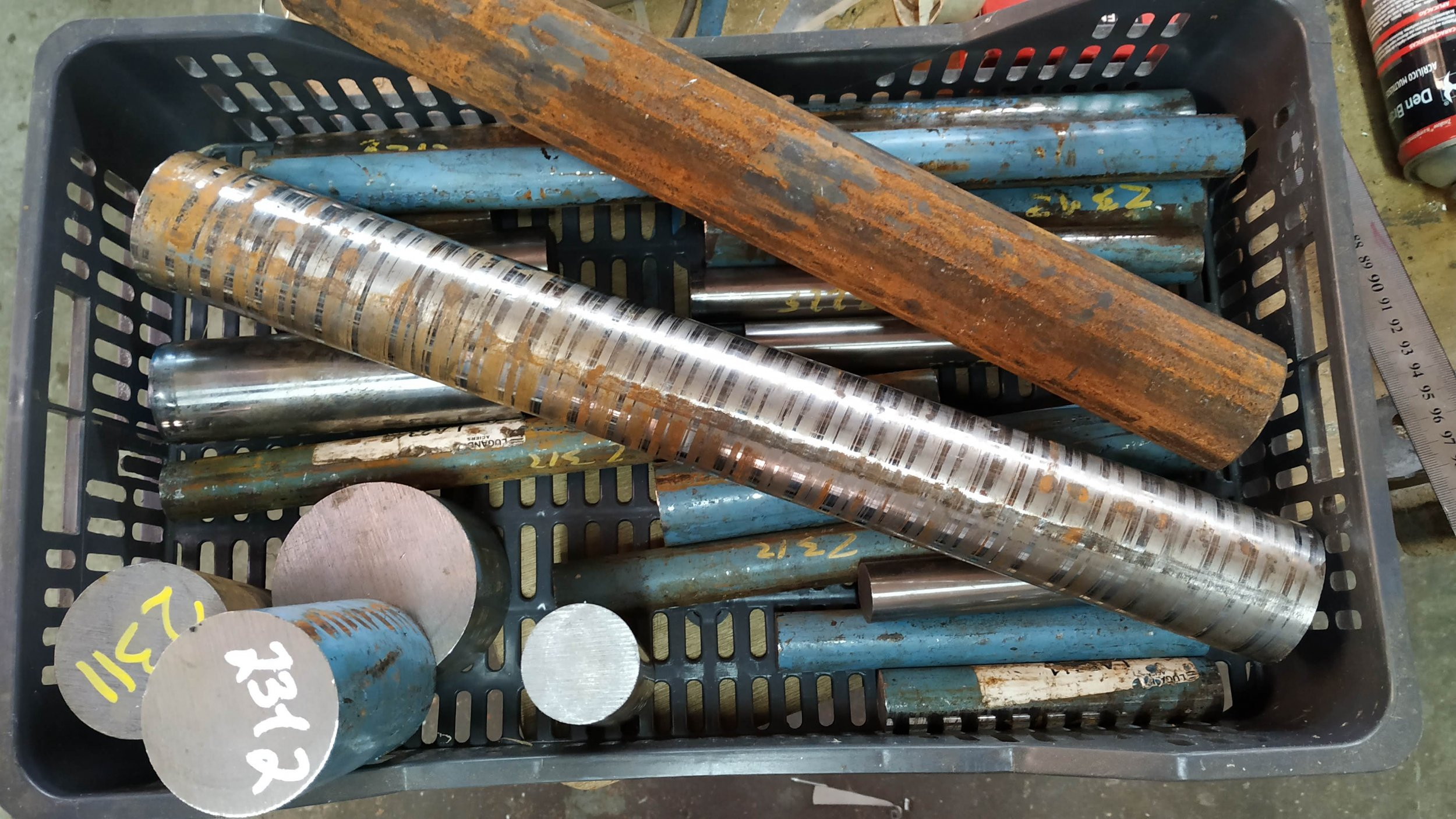

Drops are awesome and often can be found at a very good price.
I have a steel supplier close by that also sells drops from round stock, flat bar, etc from all types of grades of steel. Last time I went there for the loader project, I paid €50 and got a bunch of drops.
Here is a picture of what I got. From 100 mm in diameter, down to 20 mm. All kinds of grades, some pre hardened stuff as well.

You have a lathe if I remember. These cheap drops of different grade steel are invaluable for you.

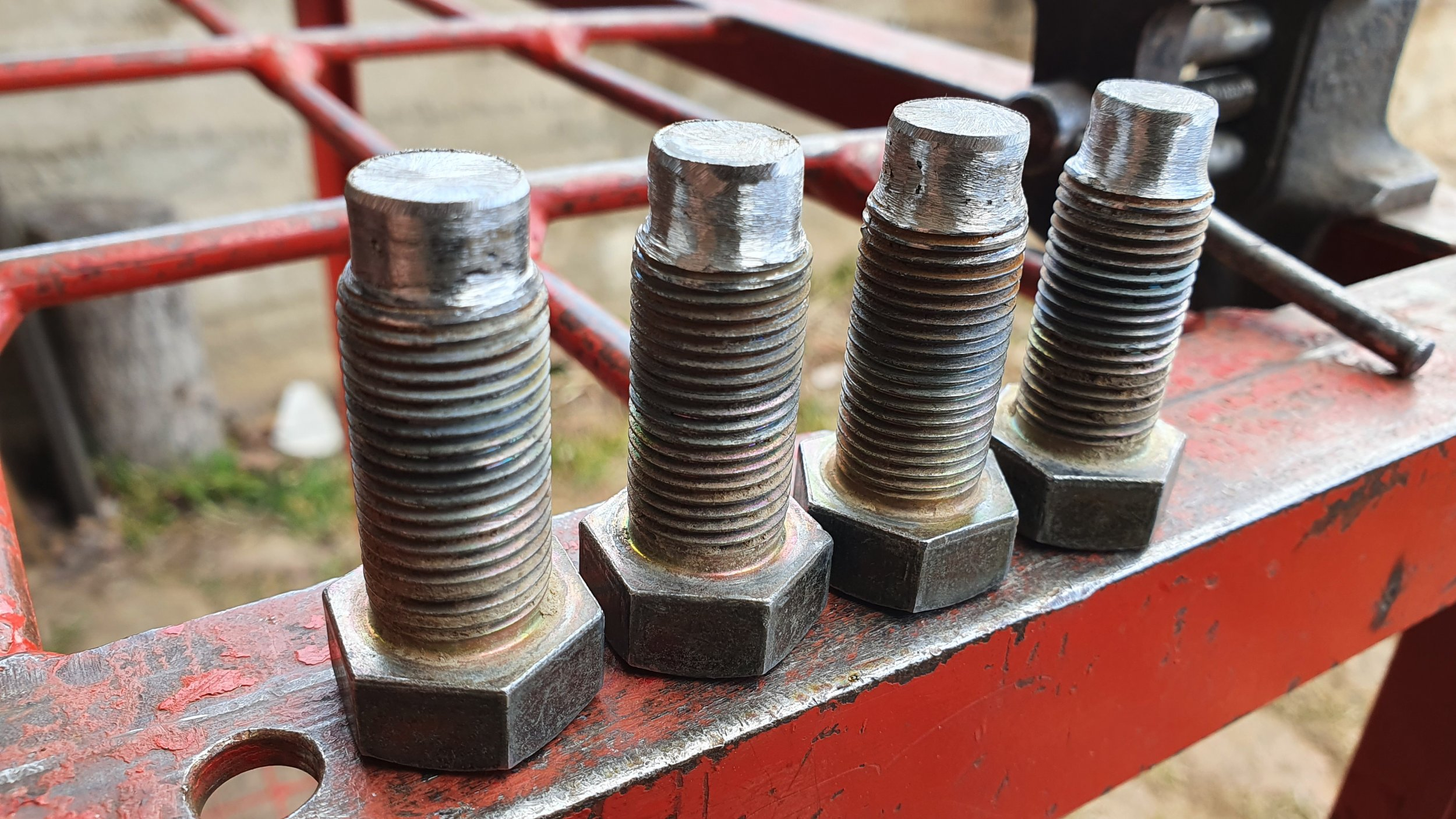

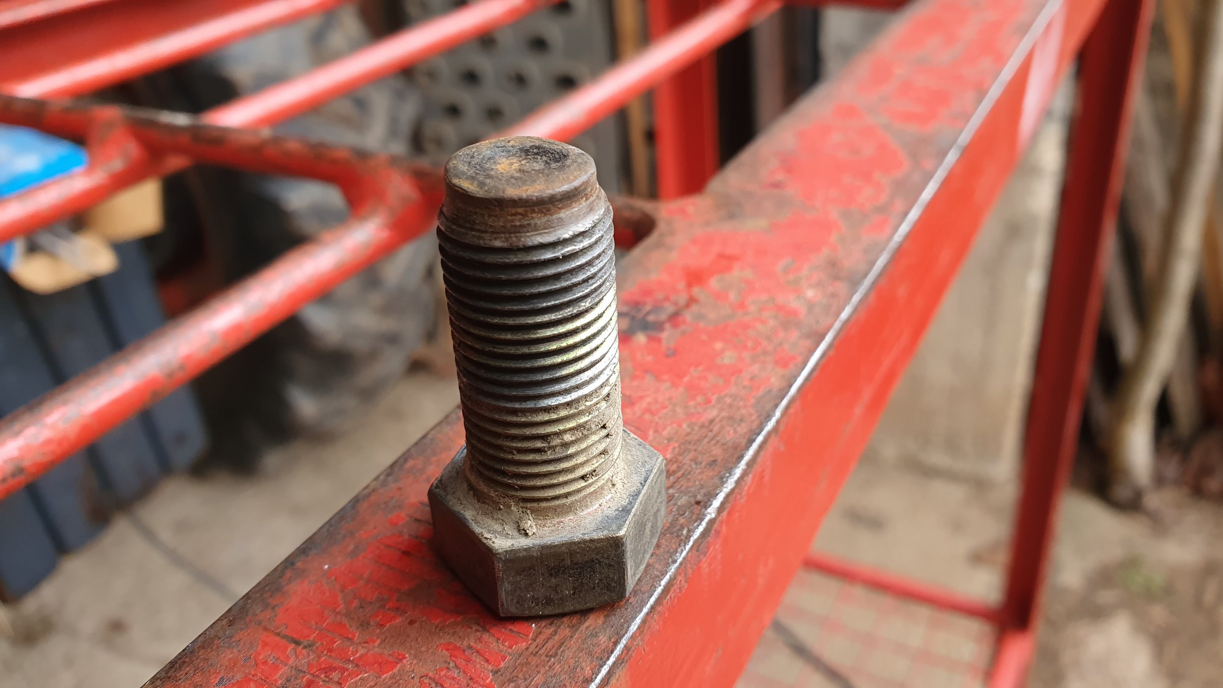

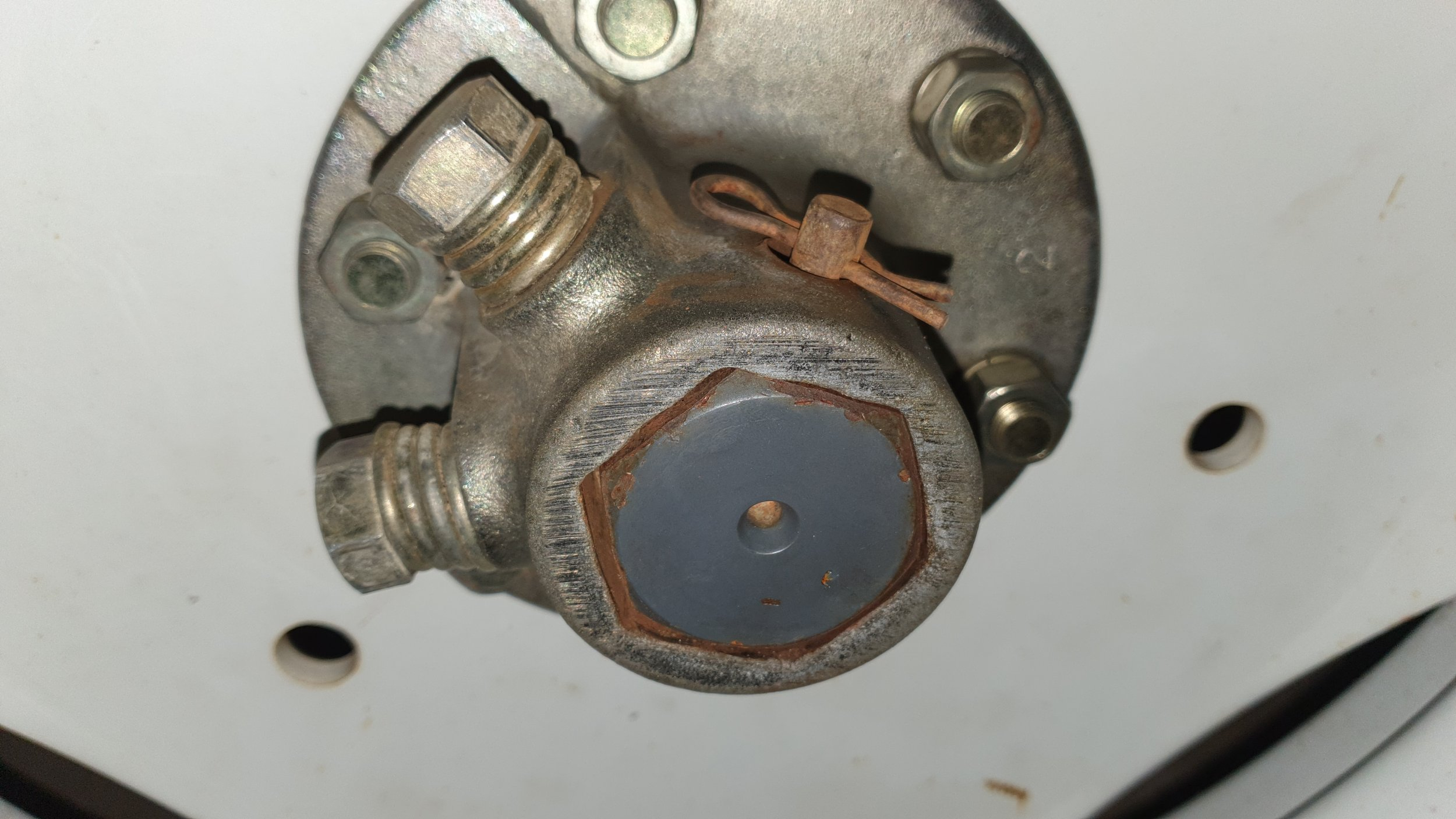

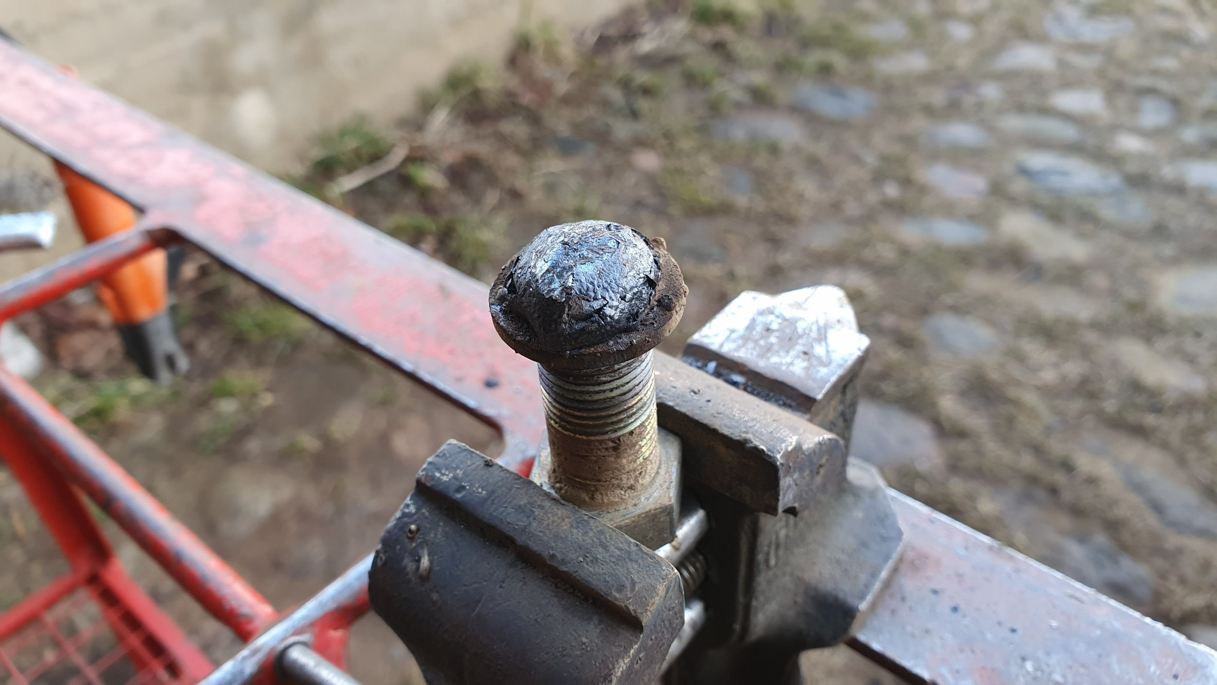

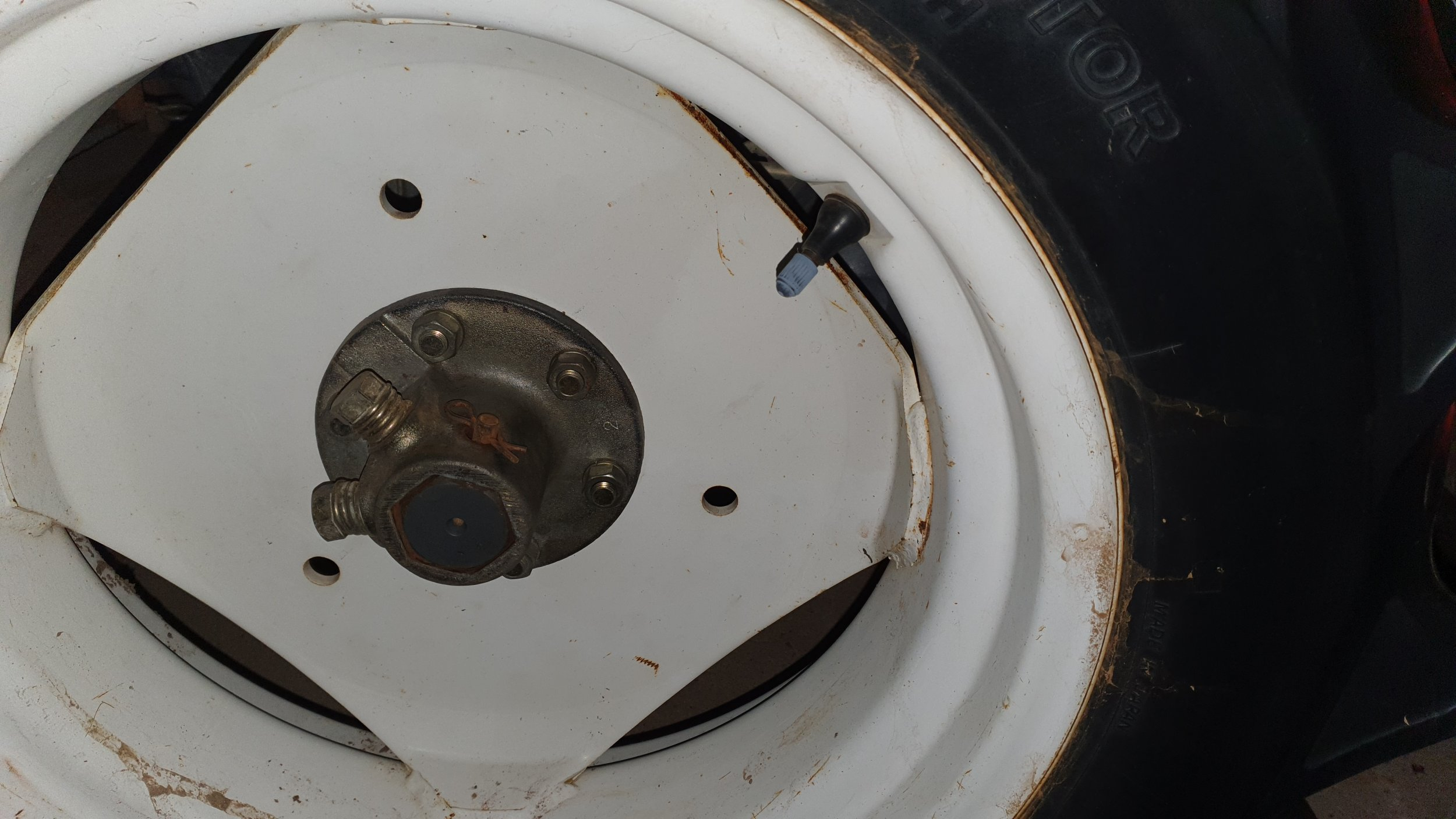

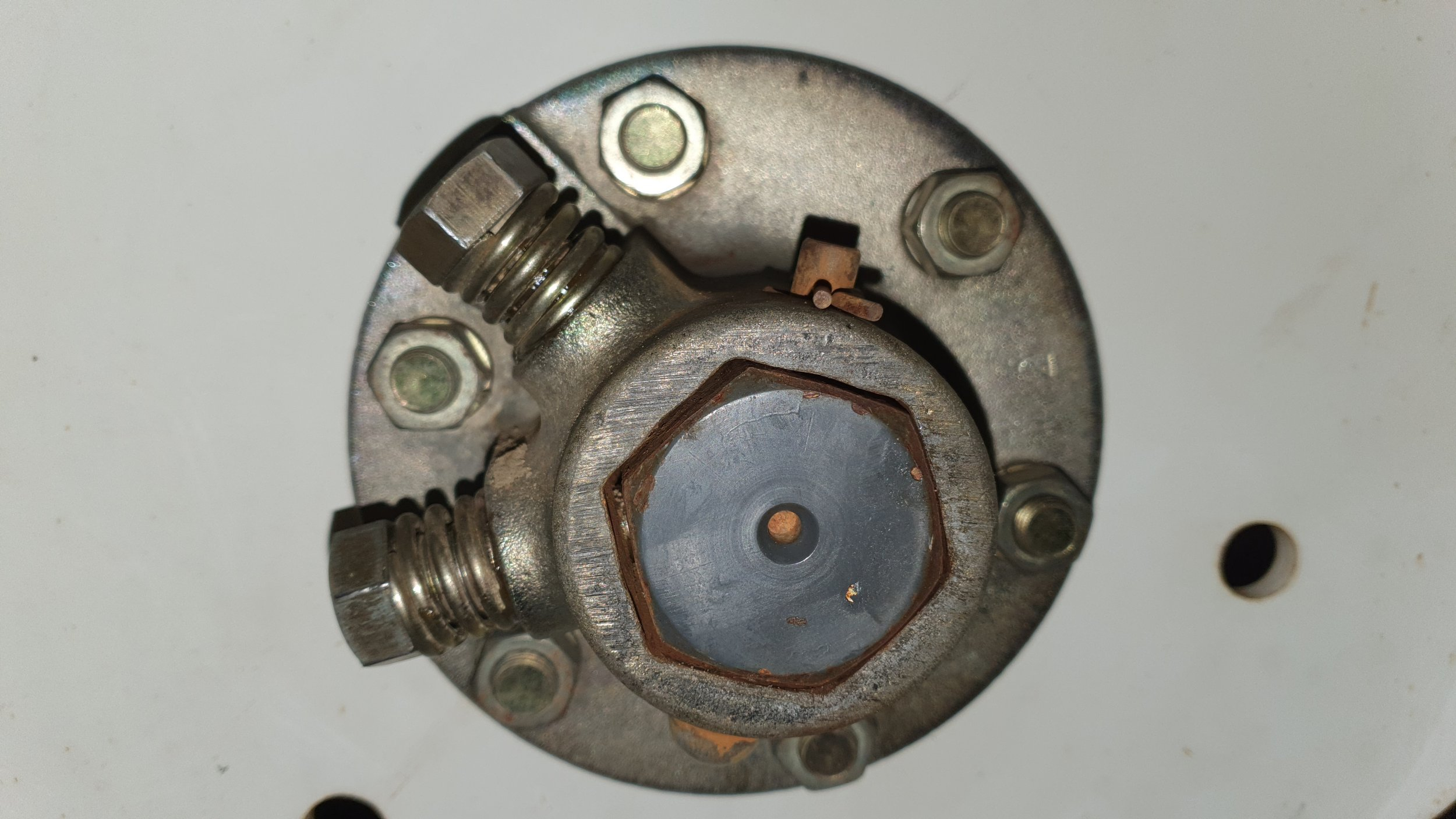

The '70s B7000 I had did too. However the set screws would come slightly use and the wheels would just wobble quite a bit. Mostly due to wear on the shaft and hub. Who knows hour many hours that thing had before I bought it 22 years ago.
I took into consideration your remark and did the job you were talking about. Yes, the springs were completely pressed down. All four bolts were sitting too deep in the hubs, so I decided to make them longer by welding up their tips.
Here's how I did it.
/ What Did I Purchase? #75
Great job! That definitely does the trick and should keep it tight for some time. The bolts do get loose over time, it's the nature of it. My tractor was like that too, probably with more wear since it was a much older tractor.
