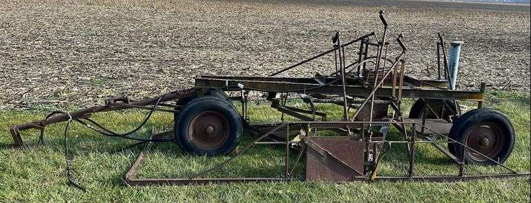

Can you attach a land plane / gravel rack / box blade to the back of one of those?
You cannot attach 3pt implements to most industrial backhoes. (not sure what a gravel rack is)
You could use something like a road maintainer if you fabricated a rear hitch. They work like a land plane.
