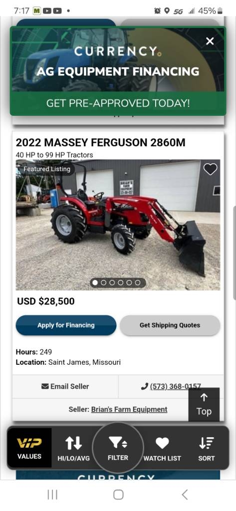

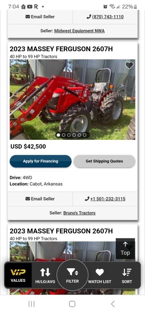

Some of the Massey 2607 models are surprisingly affordable. They are maybe a touch on the primitive side for a new production machine; no HST, no Power Shuttle, ect

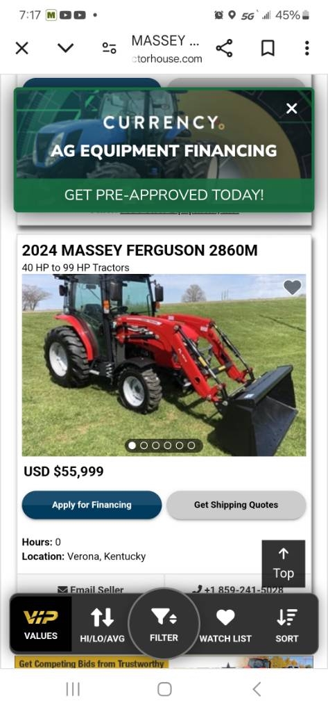

Oh, I agree. I dont know if they have a dry clutch, basic shuttle, or if it is truly an old hunt-peek shifter, just pointing out, for something like $37k for a brand new, major brand, loader, full body utility tractor, they are a Lot of machine for the price.
Note: I had to do some digging, and the 2607H is a sycro shuttle. Also, I see half a dozen or more, 4wd, with loaders at $42,500; but the only ones I'm seeing in the $29-35k range right now, are 2wd, no loader
