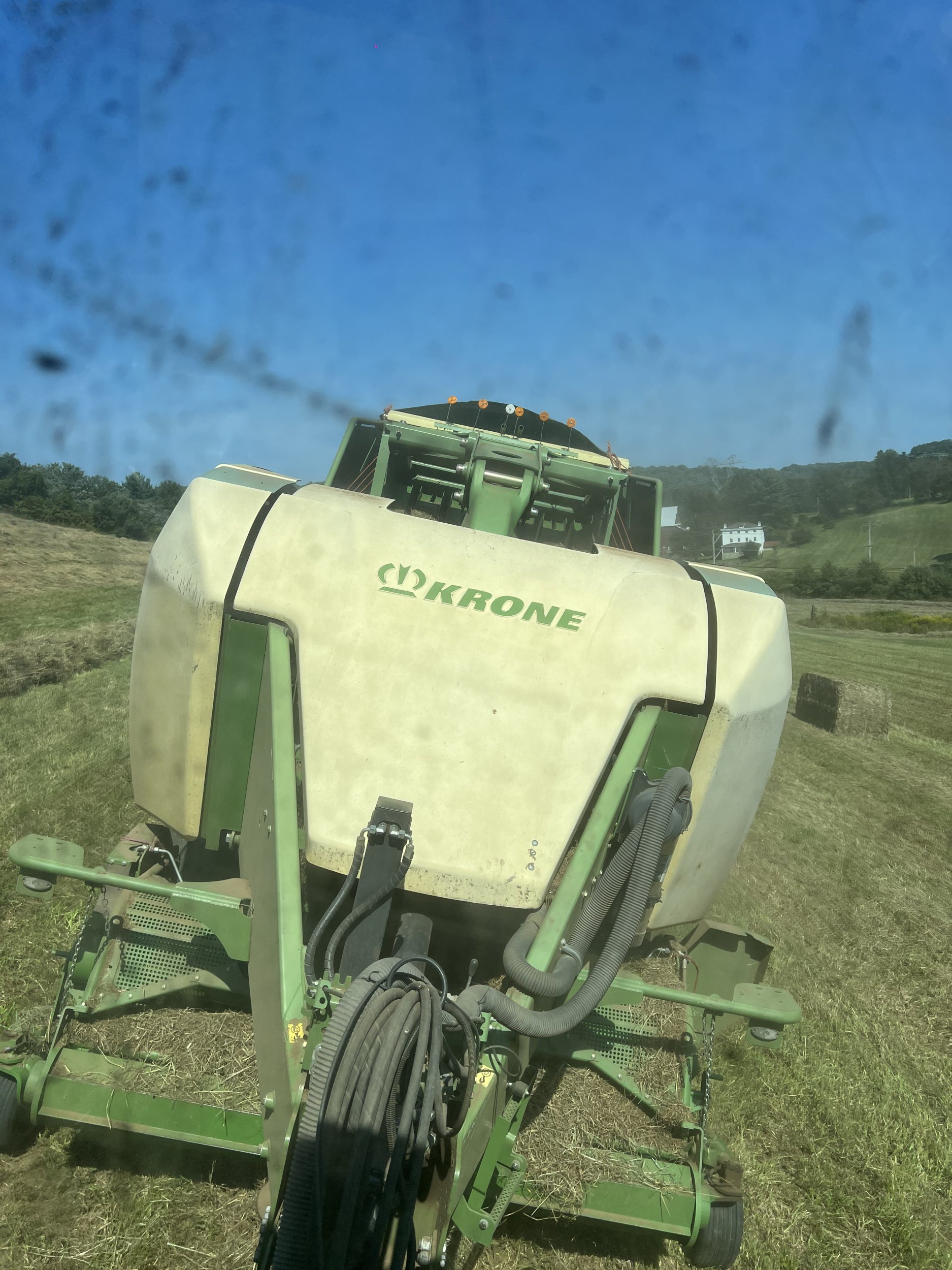

I pushed it pretty hard today.
38,000lb square baler on a 16* incline had my butt pucker factor on about a 9 out of 10.
Tandems were locked and she was still angling downhill a bit.
If it went, it was a long way down until flat ground.
My biggest fear is the baler “gator rolling” me and tractor.
