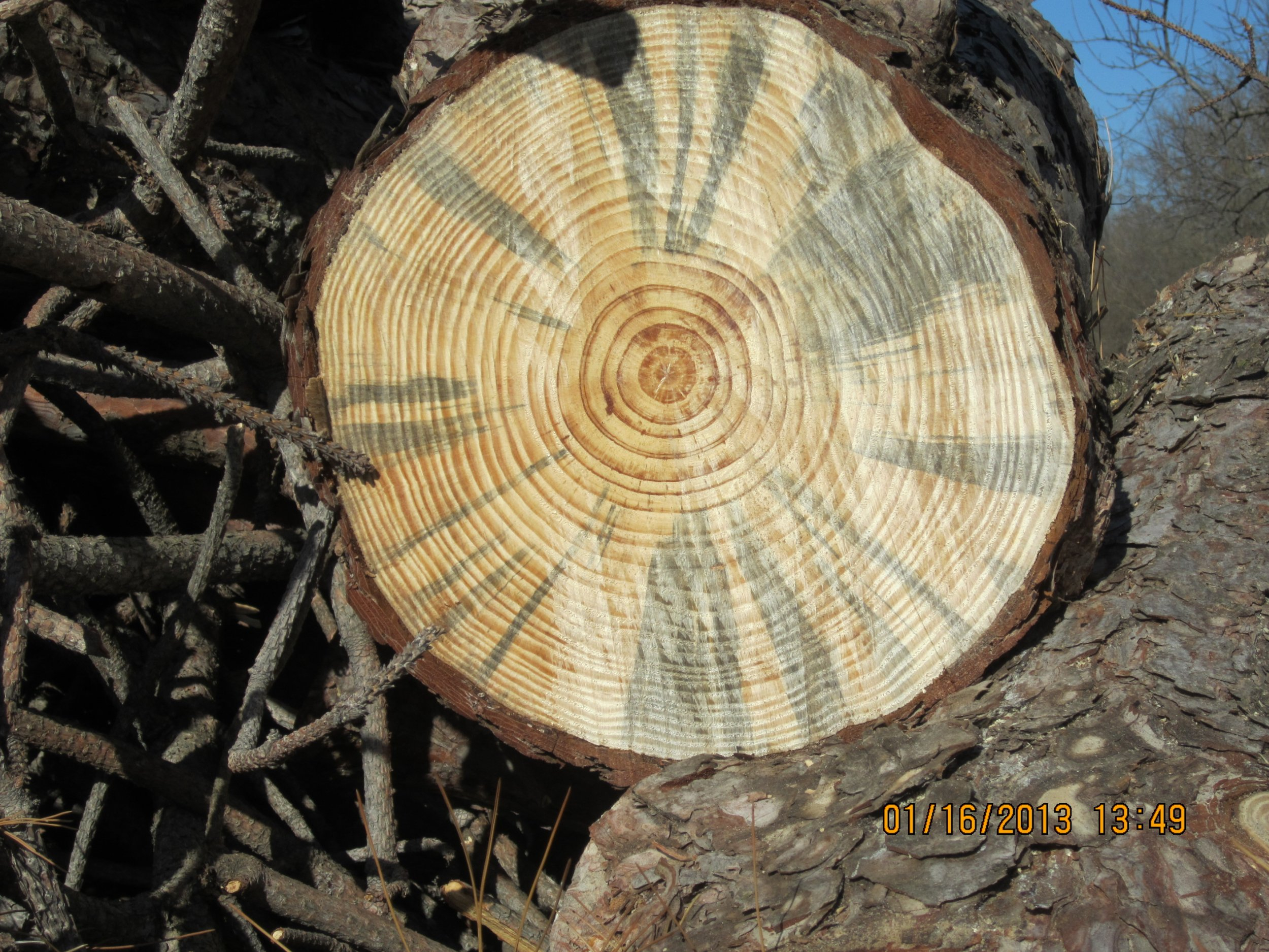

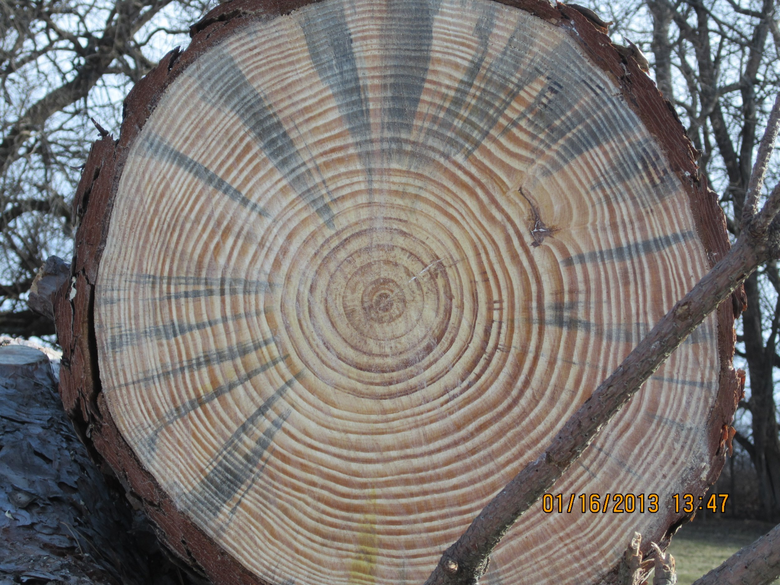

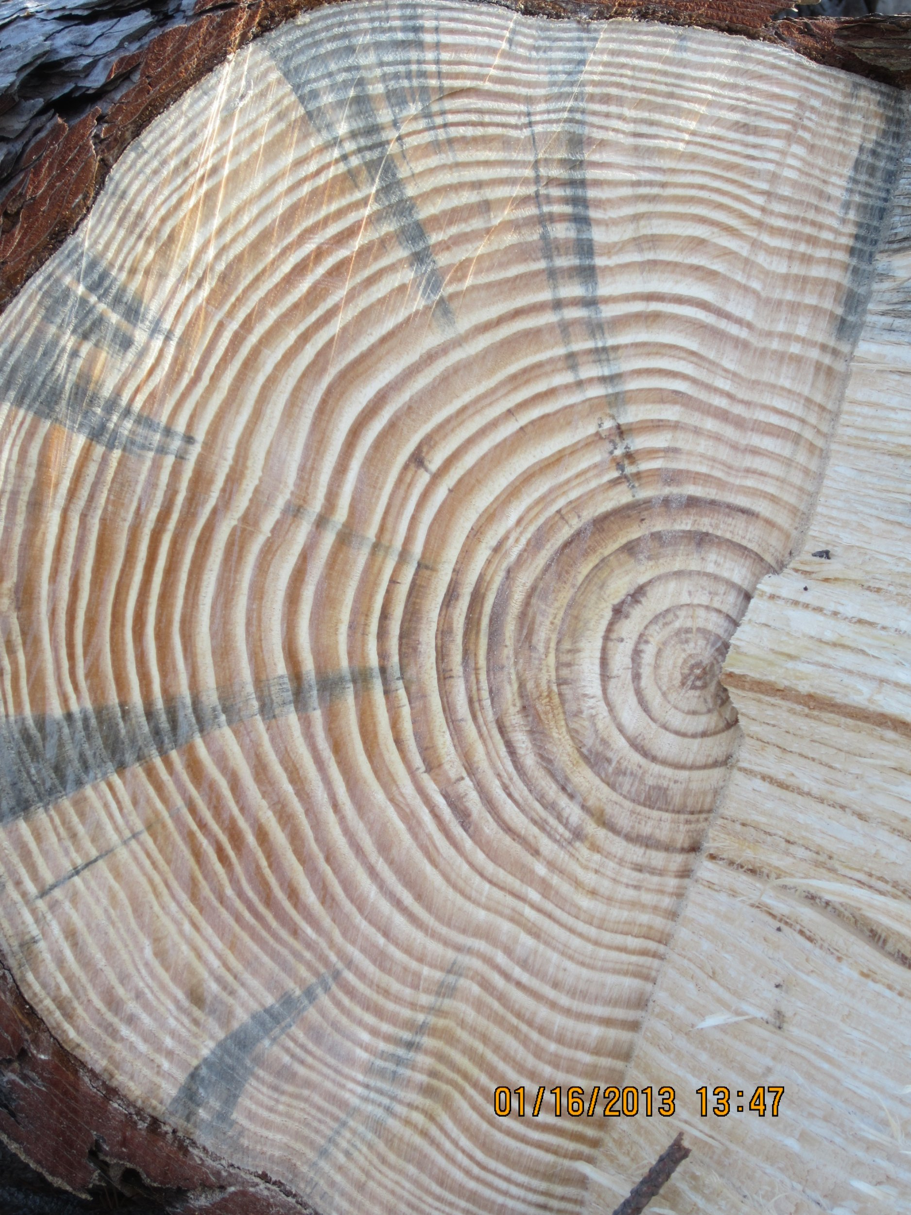

Here's what my Pine beetle disease looks like when the tree is dead........
That's Blue Stain Fungus that is found in the gut of the southern pine beetles... Blue Stain Fungus was one of the things we were studying / looking at back in the early 80's (I'm sure even way before then...) Trying to see if the fungus helped SPB get established or hinder the establishment.
Fun times, dissecting the mid gut of SPB's looking for the amount of Blue Stain Spores - did several 1000's.
