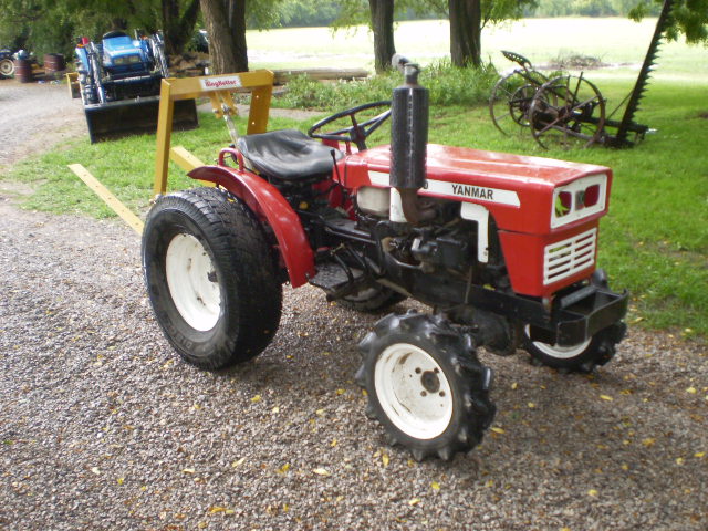

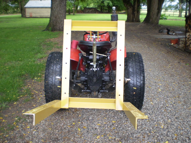

I just measured My new KK & its all made out of 1/4 inch except for the upper & lower atachment brackets , they are 3/8,s . Heres a few Pics of it on my wifes baby tractor. :D . Bob

I,ll go look BRB . OK Yes its 3 inch angle . The holes are 3/4 inch . The width at the lower hookup is 24 inches from center to center of the lower bar brackets . I hope that helps . Bob
