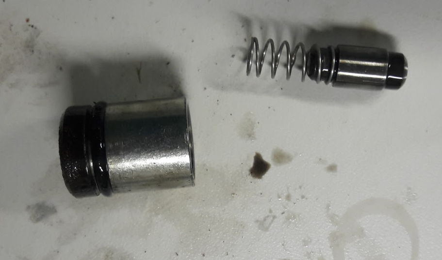

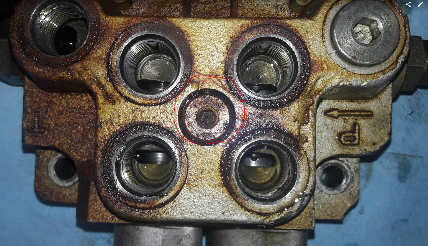

Where would that check valve be located?
Any idea what this piece is here?
Here it is removed.

steel balls = check valve. ball plugs up hole and once enough pressure from tractor is able to force ball away. to start pushing fluid towards the cylinders.
also pressure relief valve = spring, if not set correctly fluid maybe by passing directly through relief valve. you need some gauges you can hook inline so you can actually adjust and set pressure relief.
hard to tell from diagram. there is a couple springs here and there to return lever/joystick back to center. that is not pressure relief. that is just centering / netural position springs.

I believe the load check that you removed and show pictures of in post #5 is for the curl function. In looking at the parts break down I believe the load check for lift circuit is located directly beneath the relieve valve.
Attempted explanation of the Load check function:
In Open center systems the pump flow is allowed to flow freely to tank at a low pressure to illuminate heat build up and reduce power loss. A directional valve diverts flow based on how far it is moved in its bore. As an example a spool may travel 1/4" inch from center to full shift for raise. The first 1/16" is getting the spool through the spool overlap or dead band. The next 3/32" inch is the metering notches. This is where flow is starting to be directed towards the work ports and being restricted from slowly freely to tank. You have to move the spool far enough to restrict the flow enough to generate the pressure required to move the load. The load check prevents the load from falling during this transitional period. The rest of the spool stroke opens the path completely from the pressure ballet to the work port.
Unless the load check is jammed closed it would not prevent the loader from lifting.

I got it figured out. On the back side of the valve there was a second piece to the check valve. It looks like a plug from the outside, and is keyed to indicate the direction. I did not realize it was directional and did not put it back in the correct direction when I first had the valve apart looking for obstructions. It is now in correctly and the valve is completely functional.
