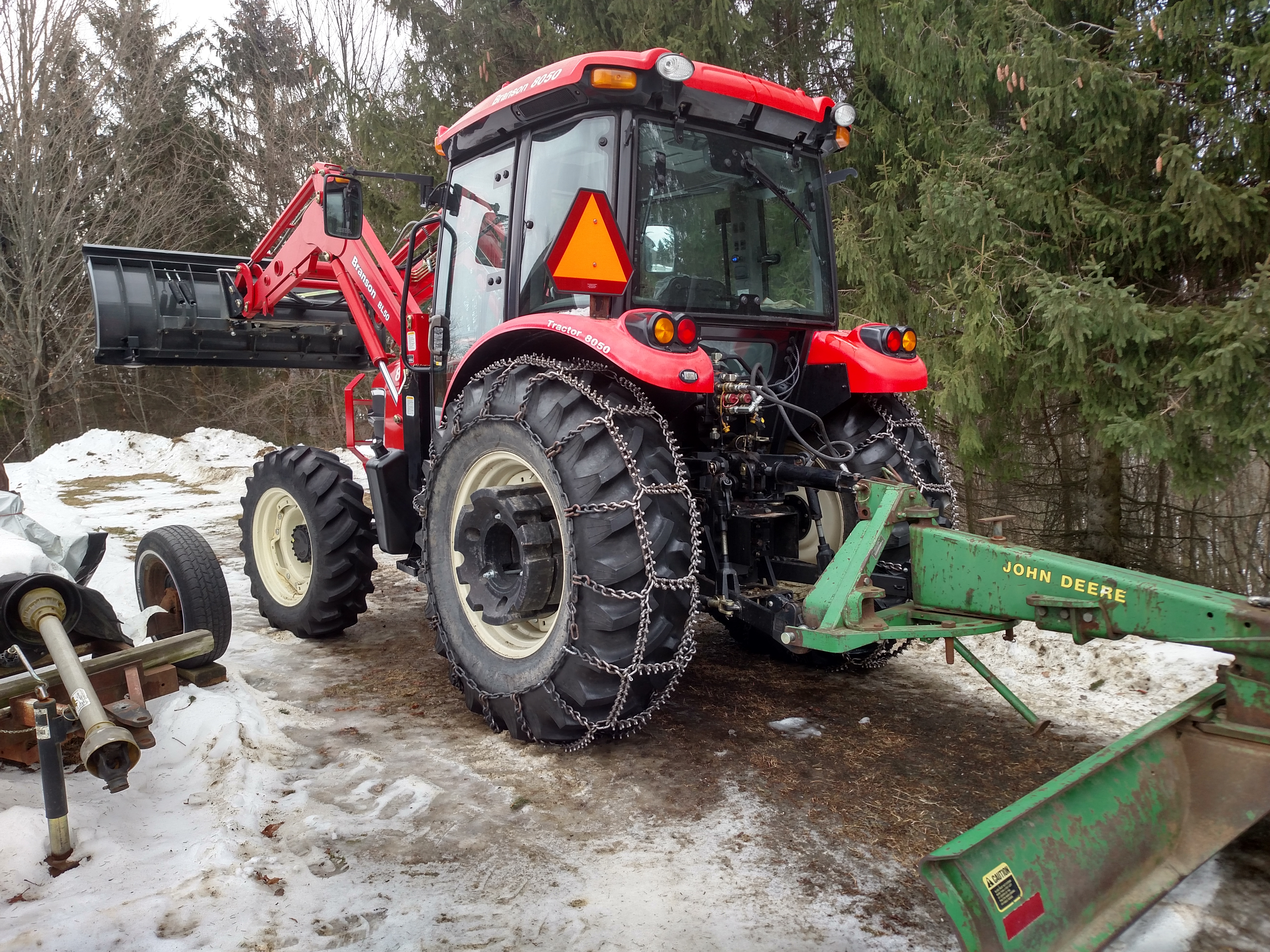

Here's the 8050 with the 10 footer;
bought it old and used.
The deere is a 9 footer.

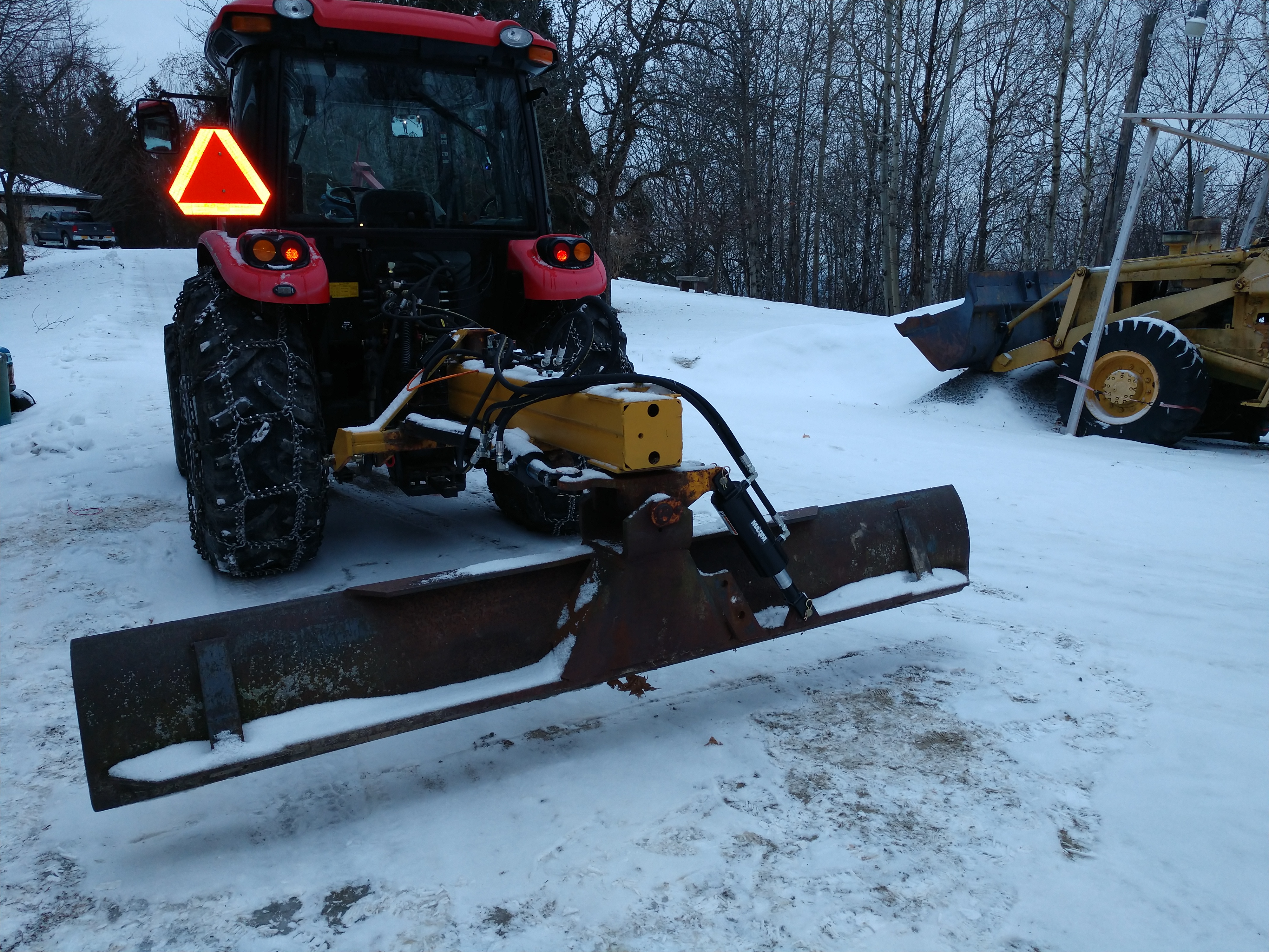

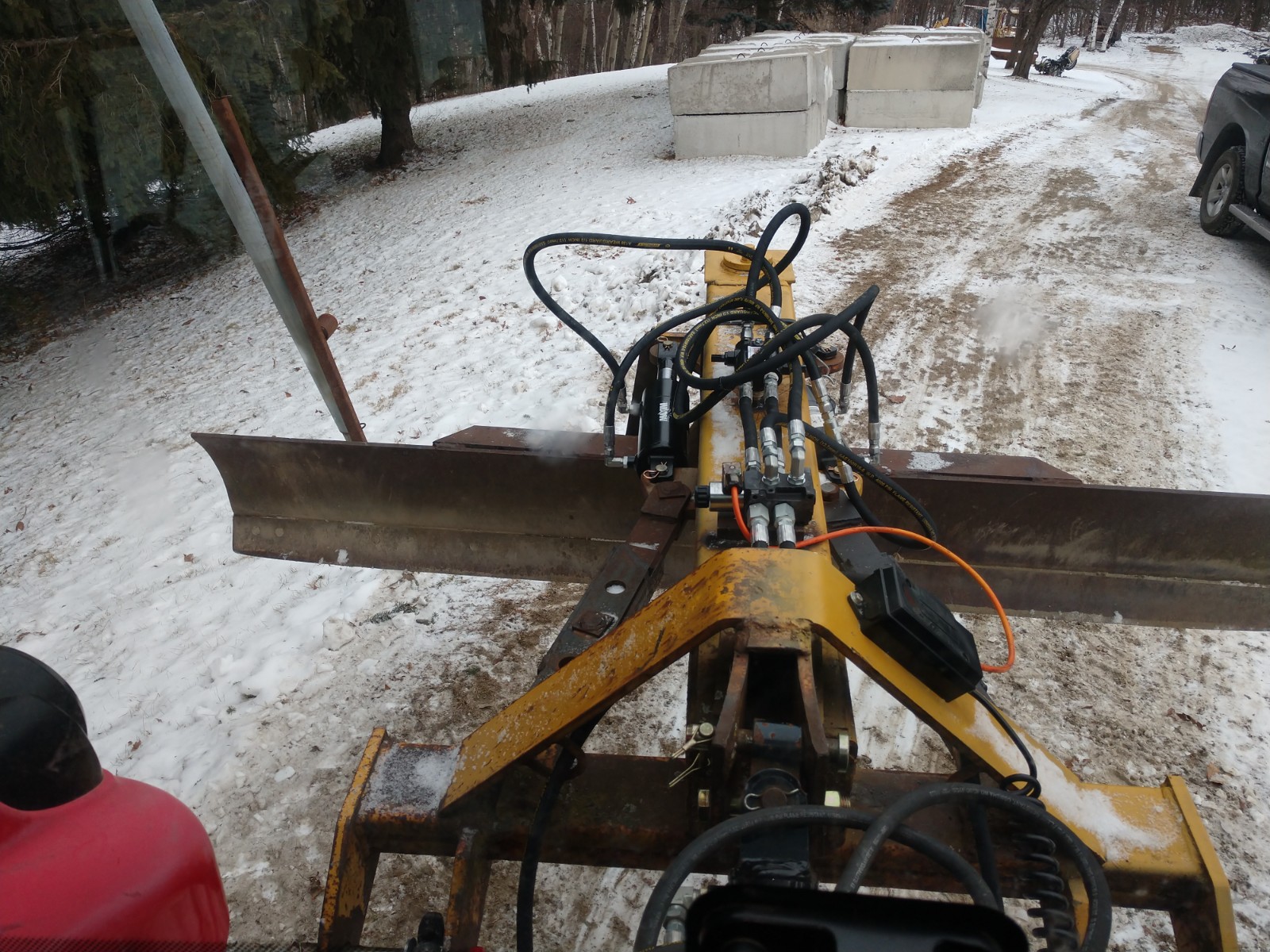

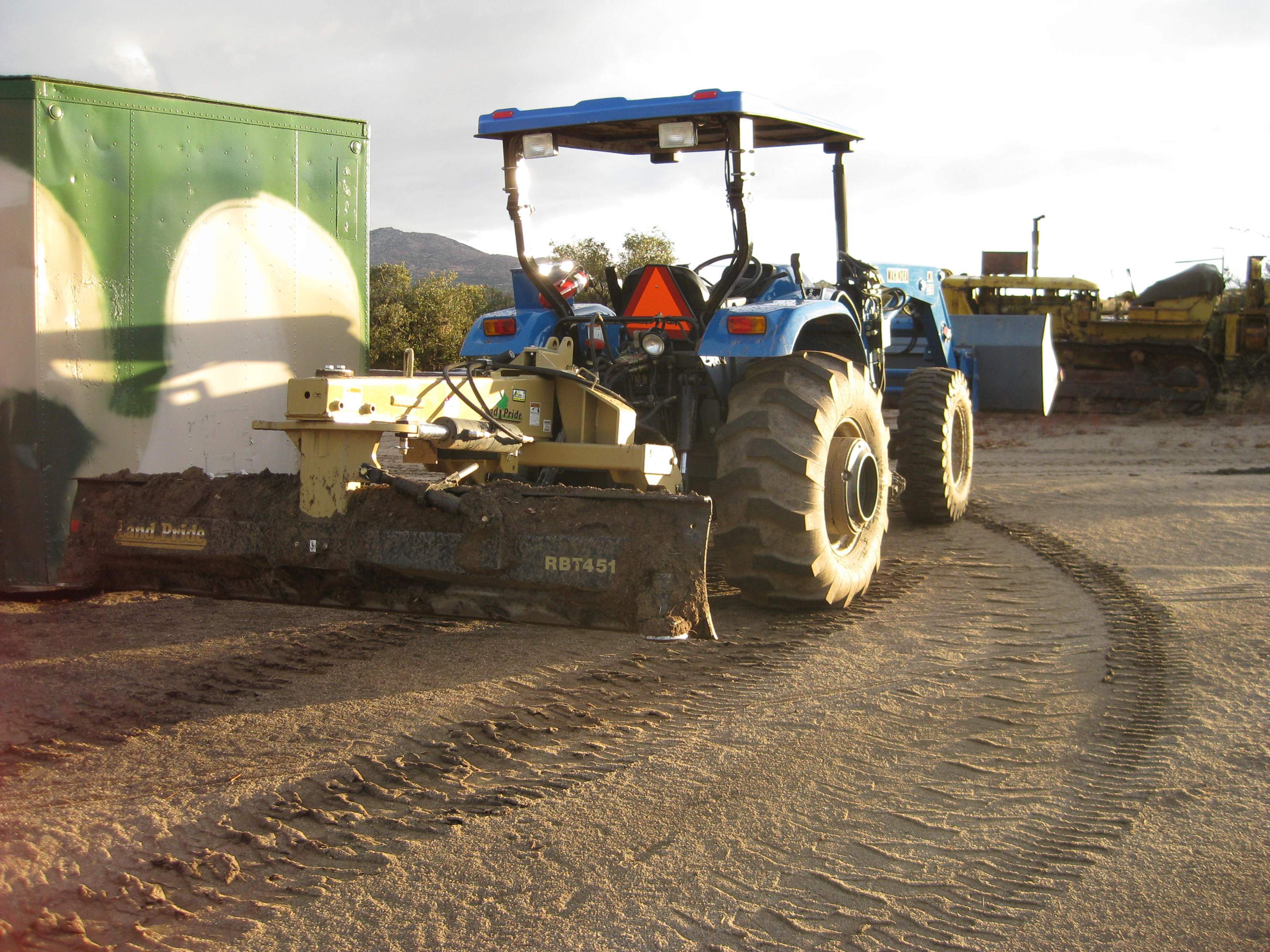

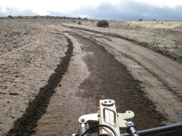

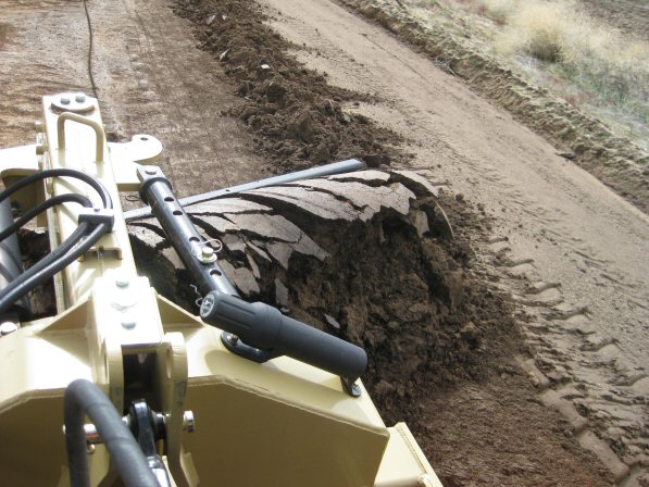

If you are going to get a rear blade for dirt work, get an 8 footer that weighs at least 100lbs per foot, or at least very close. Heavier is better. This means that you need to be looking at hydraulic actuated blades, or at least hydraulic actuated as an option to be looking at blades that are actually heavy enough to work well in about all circumstances-conditions.
You get a good heavy rear blade and learn how to use it to it's full capabilities, and your box blade usage will plummet.
You can roll some dirt with these, or take a light cut, all depends on what meets the requirements of the situation. ;)
