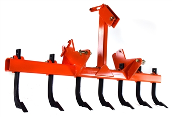

If you want a scarifier with your rear blade, get one that attaches between the tractor and blade. Here's one.
Land Shark Compact Tractor 3 point Scarifier Bar Ripper
Or find someone importing the Chinese blade that has scarifiers.
Grader Blade For Tractor With Ce - Buy Rear Mounted Grader Blade For Sale,Grader,Blade Product on Alibaba.com
