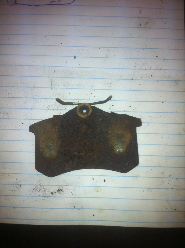

/ What blast abbrasive to use?
#11
Here are the before and after pics using TSC "K & E" brand non silica sand and gravel mix
Only a small piece but you get the idea
Yes I do have a vac attached

/ What blast abbrasive to use? #12
Looks good!
The vac sure is nice, no dust in the shop and you can always see what you are doing!
