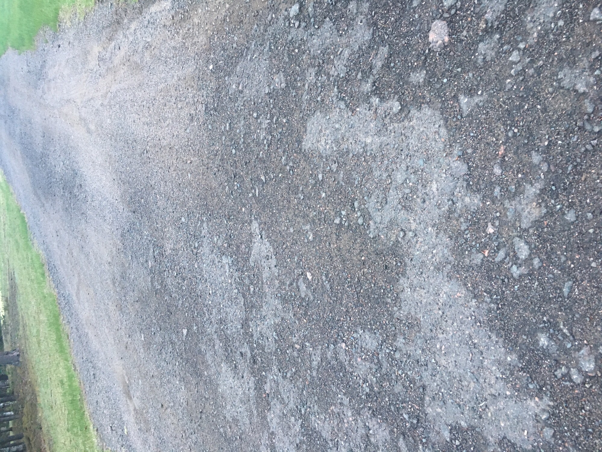

Hey, Im a newbie tractor owner and im not sure what attachment to use for a job on my driveway. I have patches of old brittle asphalt that Id like to remove. Wondering if a box blade is a proper implement for the job? Ill upload a picture and hopefully get some advice!!

I would dig them out with a shovel and put them in the FEL. If they’re really big, i’d use a backhoe.
I’m not sure what good dragging a blade over them would do except for knocking off the high spots.

A box blade might work if you can lower the scarifiers enough to rip up the patches. Are you wanting to remove all the old asphalt or just some small patches of it. If just a small area so as not to disturb the remainder, a backhoe might be best.

If it's old deteriorated asphalt box blade & rippers work with small tractor. You might also be able to get the loader cutting edge under the asphalt and peel it off.
If you have to purchase a box blade try the bucket first.

Have you been at this property long enough to know it is/was a paved drive?
To me, your pic looks like millings and not an old paved surface, and that's pretty typical of what they look like. Tight packed areas with loose, gravelly areas as well.

My FEL and Backhoe made mince meat out of my driveway and with no teeth on the FEL
Once you hook it it all breaks up pretty easy.

I use my forks to break it up, then scoop it up with FEL.

I壇 like to remove all the old asphalt chunks so that I can box blade the entire driveway and try to smooth it out. It seems brittle enough that the teeth would rip it up. Thanks!
