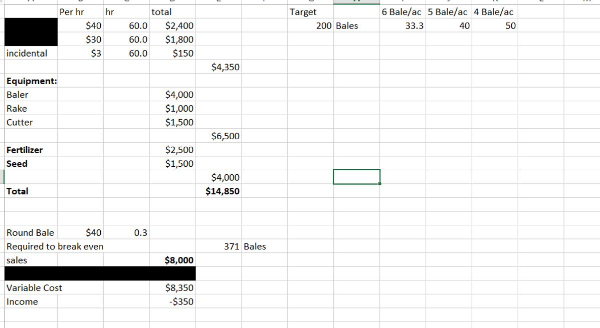

So here's my first attempt at beer math for what it would cost for folks to poke holes in (already struggling with the baler, think that would have to be $6-8K for something that will be mostly reliable and operational).
Bit of an explanation:
-Two tractors are the top left blocks and I'm billing each .3 hr/bale with the intent that the cost per hour covers operating costs .
-Incidentals are twine/wrap/pins/whatever billed at $3 per hr.
-Hrs calculated by hr/bale times the target bales just as a baseline and really a random number I figured maybe I could hit...and hopefully sale/move.
-Fertilizer is billed at $50/acre and used the worst case 4 bale an acre, or 50 acres.
-Seed is $30/acre also using worst case.
-Breakeven number is the number of bales at that price into the total cost, it obviously would require more time and associated variable costs to achieve the breakeven number of bales so it would go up it's just a data point.
Everything else is pretty self explanatory I think, at the end of the day I'm losing money baling hay just at variable cost let alone trying to pay for the hay equipment but if I keep $2k or more in hay for myself that makes a difference.
It's fun ideas to mess with over lunch breaks if nothing else
Like yourself and many others on this site - we all started down this road. Got critters to feed and been payin’ good money for sometimes lousy hay and drivin’ 100 miles round trip for half a trailer load ‘cause the field sold out!
First question to answer - what are your current livestock feeding expenses? You’ll save yourself most of those minus the operating costs of fuel, wrap/twine, repairs, etc. Not a total savings - but, likely significant.
Looking over your spreadsheet there were a couple of things that stood out: 1-baler. $4,000 is not much for any kind of round baler. You’ll probably be workin’ on that baler a lot more than balin’ hay! 2-cutter. $1,500 will get you into a decent sickle mower but not much more. They’re slow, will plug in heavy hay and require quite a bit of maintenance. IMO - look for a good, disc mower.
3-seeds. Typically, that is a one-time cost for a long term field depending upon what you’re growing. Figure to pro-rate that cost over several years, at least.
Starting out, pick the brains of the local growers and level that info with assistance from your area USDA folks. Between them, they can help you with those production variables that can be the difference between making money and losing your shirt. Good luck.
