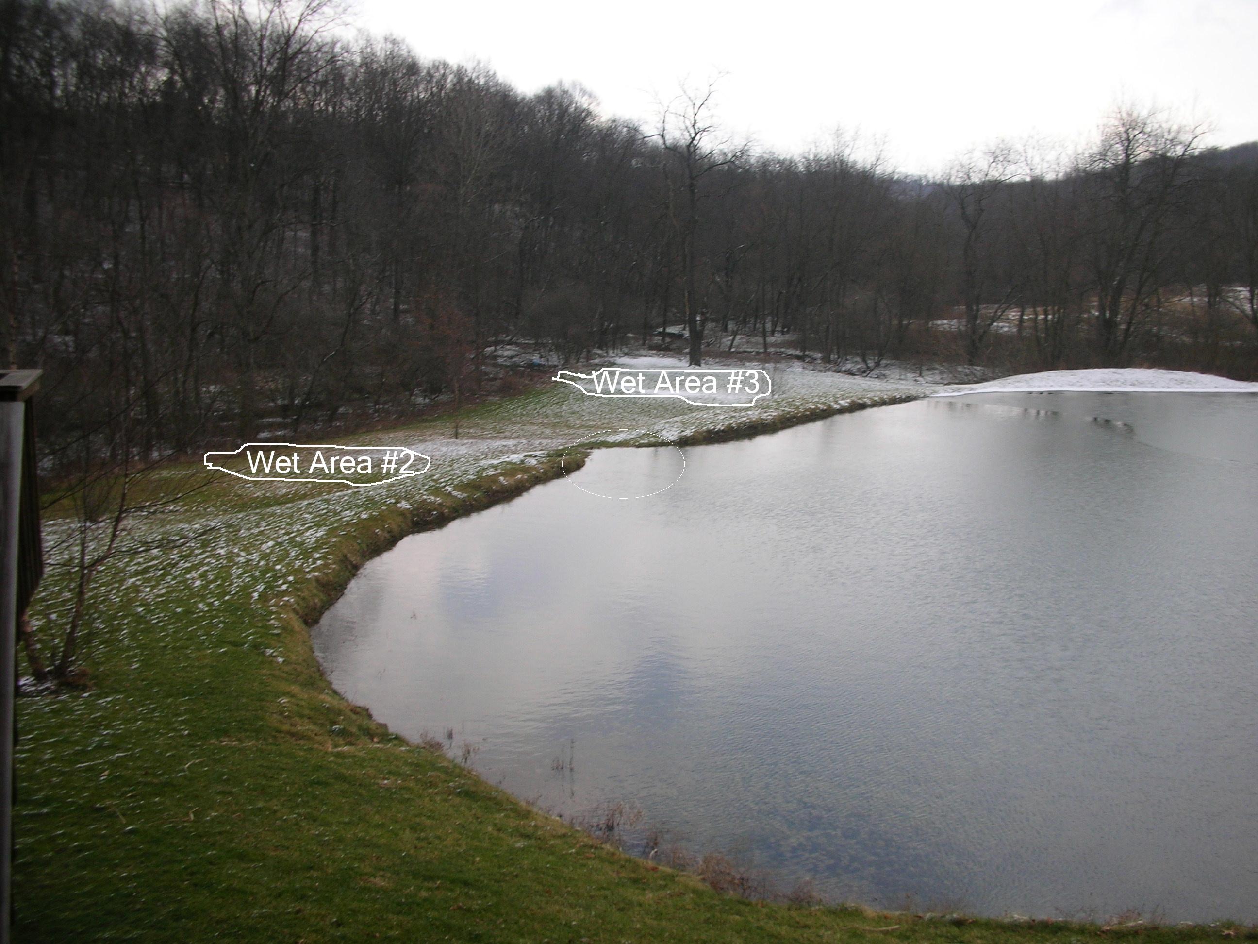

I think Eddie summed it up pretty well. Area 3 is no surprise, as that looks like it's in the floodplain and bordererd on one or two sides by stream, even if it's some distance back. Area 2 is somewhat surprising until Eddie mentioned the dam leaking. Either that or the spring? in Area 1 extends through the pond and resurfaces in Area 2 downgrade. If the dam is not leaking that's the only other cause I can think of. Frankly, Areas 1 and 3 look pretty normal to me.

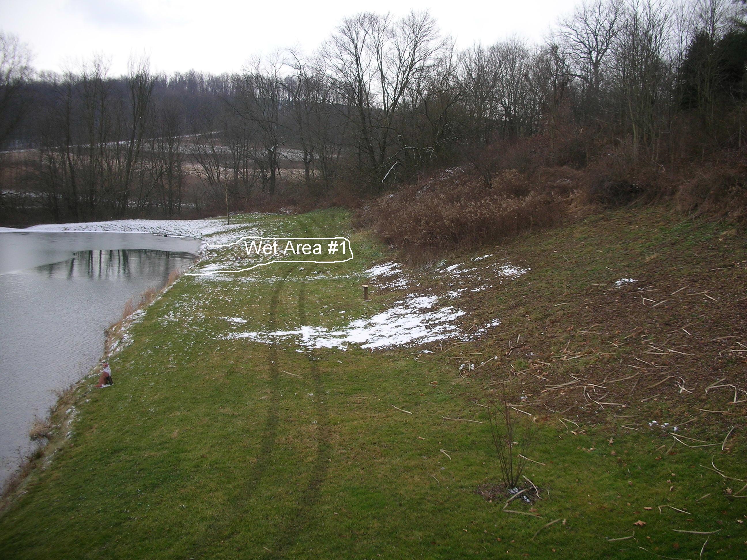

I am definitely going to wait it out through the spring into the summer to see what those wet areas do. I know for sure that the area above the pond never dries up, my uncle who used to live here told me that they never cut the grass there b/c it is always wet. The other areas that are below the pond I have no history on. MY thoughts right now are to put french drain in the area above the and then see what happens. Going to keep a close eye on what happens with the areas below the pond, could just be form the wet fall and winter that we have had in the northeast.
Next question, the low spot in the dam wall (circled area) needs to be repaired for a number of reasons. Eddie mentioned the erosion and that concerns me but also to make it look good and easy to mow. Any ideas to build that area up?
Had another idea for the area that is wet above the pond. Would it be possible to dig a holding area to collect the ground water, then build a waterfall/rockbed in that area and use a small pump to use that ground water
and water from pond to get water to the waterfall?

In my opinion; #1 can be resolved by french drains ending in pond. Other two can be resolved by french draining them off your grassy area, one to creek in backround and other off into wooded area. I noticed water level and do not see any overflow pipes. It would be wise to install an overflow to allow water to overflow through a pipe to an area off site ( stream) It seemed to be spilling over at variuos spots, which can contribute to the wet areas. This might involve raising areas around the pond to be level at all spots except where the overflow pipe is at . Overflow pipe should be buried below grade; not just laid on ground at lowest spot of pond. Example; Use transit to make pond walls all same height; then decide the height of water level below pond wall height; then plce overflow pipe below height of pond wall; say 12" down. This also makes for a nice looking pond .
/ Wet areas in yard #25
I think your getting ahead of yourself. First step and the only thing you should do right now is fix the overflow drain. Is there an area that will be lower that does not go over the dam? Was there ever a pipe drain in there?
Just building up the low area will just send the water to another area. You need to have a plan on what to do with the water comeing out of the pond.
If you have such a location, then to fix the overflow on the dam, you need to scrape off the grass and any other plant matter. Add good clean clay in layers and slowly build it up. Dump a load of dirt and spread it out. Drive over it and compact it in as much as possible. It's more important to spread it out thin and drive over it a bunch of times than moving allot of dirt ther all at once. The worse thing you coud do is get a dump truck there to dump a load of dirt that you cannot spread out and compact. That would be very bad.
Your french drain is good for surface water that doesnt drain. It might work in your situation, but I personally think it won't. I think your dam is leaking and that you have bigger issues.
How deep is the water in the pond? How tall is the dam and how side is it? What is the slope of the dam inside and out?
One very common way for dams to leak is for it to travel under the dam and then surface on the other side somewhere down hill. This happens behind the dam and will look just like what you have going on. It's a big job to fix this and not something to rush into.
Wait and see what happens. If it dries up during the heat of summer, then it's not leaking. If it's still wet, you got major issues. Right now we just don't know enough to start guessing what needs to be done.

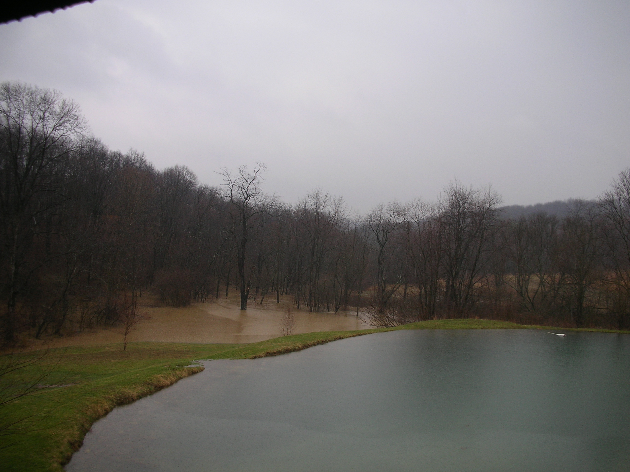

Just thought I would add a new pic. We got a lot of rain over the past day or so and I ended up with a whole new pond in the yard. Actually the two little streams that border my property jumped the banks and ended up in the back yard. Couple of hours later it almost has completely gone away. Nothing down there to get flooded, well except for the deer camera in the woods!!!

Forgot to mention, the low spot in the dam wall only seems to be getting worse with the rains that we are getting. That is going to be first project when I finally get the tractor. I think I am going to try to add to the dam wall and compact with tractor first, we'll see how that works. That low spot is starting to overflow and erode the dam wall further. Should I cut the overflow pipe shorter first to lower the level of the water???
/ Wet areas in yard #36
Dams fail by a very simple means. Water flows over them and erodes the dirt. Not much at first, but it just keeps getting worse. At some point, it will increase to the point that it will seem to happen all at once. Your pictures shows a dam that's read to fail.
You need to get the water lower. Much lower!!! Then you need to get your drain pipe fixed. These are just the first two steps. From what you have shown, the pond is toast. If you have long terms plans to keep it, I'd drain it and rebuild the dam. It will make for a tough year, but when your done, it will be good for decades.
