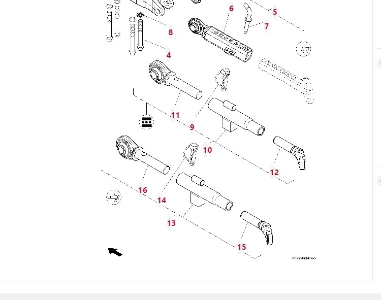

The pin is loosened to allow the half that is threaded to spin.
The pin is re-installed. It does TWO things. First....yes it keeps it from spinning and changing the adjustment. But second....that is also how it is attached. Without that pin installed, the two halves of the stabilizer can simply come apart

The original poster has both pins removed and sitting on top of the PTO shield in his first photo.
I noticed that in pic but it didn't "register", just going to walk away from this discussion....

Great call on the diagram!
Still amazed that oem doesn't have more adjustments, and op could of made this just 1 page if he would of said he pulled the pins, I thought they were just pins for the attachment 😁
