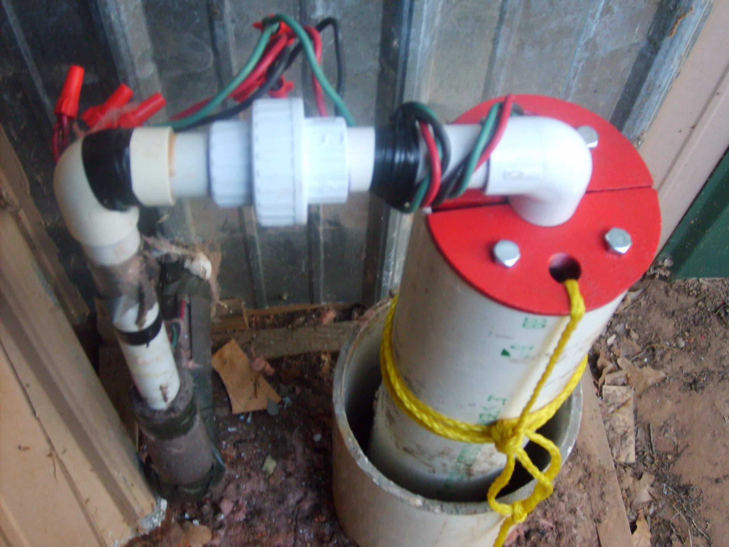

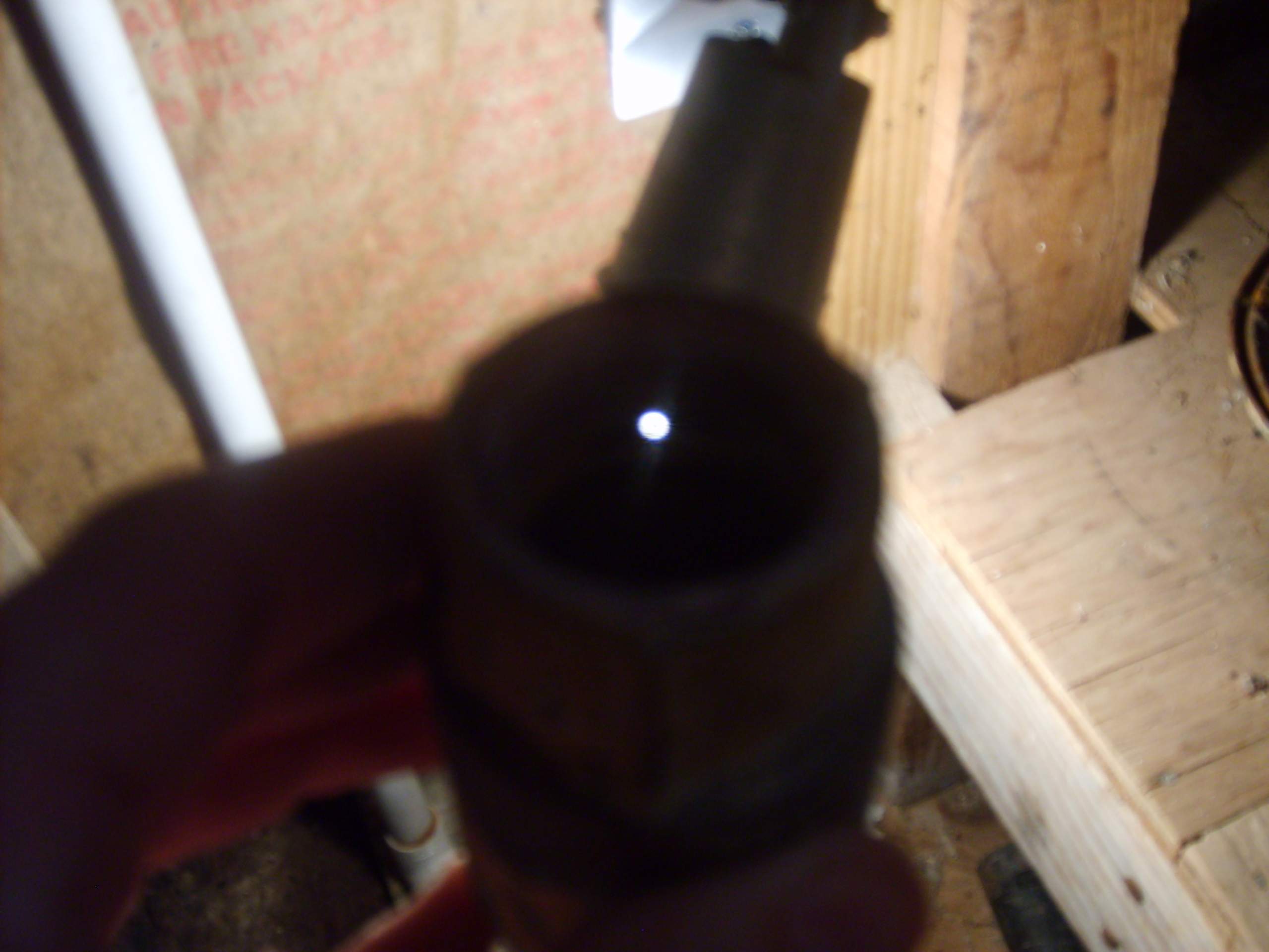

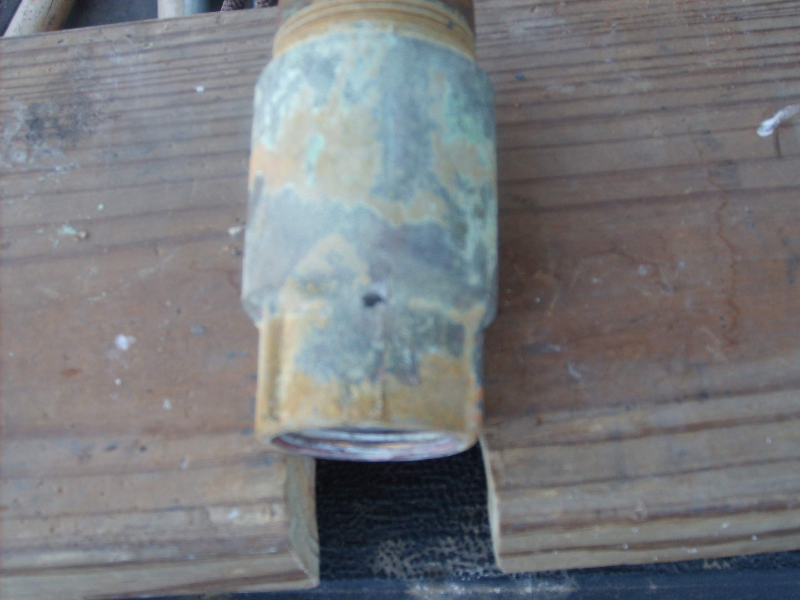

Here's a few pics after the fact. A couple of the culprit (check valve) the light showing through the hole, one of the well head before I closed it back up and one of the block (notched 2x6) to hold the pipe stand while I disconnected/connedected the joints. I put a fitting in it to give visual aid.:) Sorry, pic quality is pretty poor. Sandbur and Tom I agree on the poly. I think later workings will call for replacing the PVC like when I have to replace the pump. Al, no problem with well frac'ers around here...YET! Thank goodness.
Oh! I almost forgot...Yep! Sandbur, I rounded it off to 32#'s. That's 32lbs I'm glad I didn't have to pull from 100' below!!

   / Well, Well, Well! There's air in my water.... #14
The notched 2x6 is a terrific idea.:thumbsup::thumbsup:
Yep! It's quick and dirty and works like a charm. I think I borrowed the idea from someone?! Anyway, beats using a set of slips on the slick pipe or having to hold it and work one handed!:D:thumbsup:
