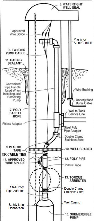

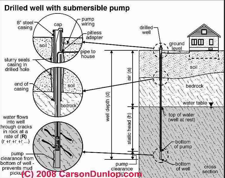

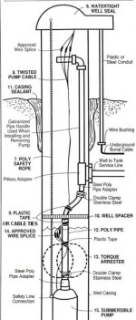

/ Well pump replaced
Wife looked up the pump and check valve prices. Pump = $300ish but check valve was more, leaving about $800 for his labor and use of his big truck.
Attached are some pics showing what ours looks like. Doesn't show the check valve. Gotta be up near that "pitless adaptor" thing.
It's a far reach past that pitless adaptor to disconnect the piping.
Ralph
Ralph
The disconnect is done using a long T- handle 1" pipe.
You could make one yourself.
/ Well pump replaced #8
The only check valve needed in the system is either built into the pump or installed just above the pump. You do not want any other check valves higher up the line like at the pitless or after the pitless. Check valves are just one of many things that are destroyed by cycling the pump on and off too many times.

#9
Guess that's where it is. Well is 350 ft deep, they say now.
