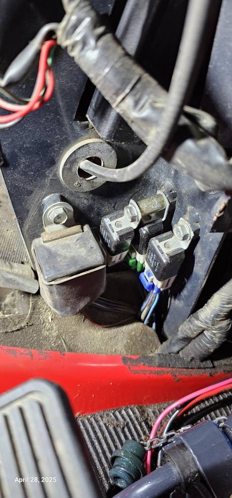

Was bored so I decided to trouble shoot why the blinkers blew the 15amp fuse every time. I checked and cleaned the switch and connecters and inspected wires. Removed the one relay closest to the engine and bam..blinkers work again. Put it back and bam, blows fuse.
So i left the relay our and out everything pack together. Works great now without the relay....but why?

Yes the flashers work, left and right blinkers work, all lights work. So when I out the relay back in as soon as i put the left or right blinker on it blows the fuse. .Thats whats confusing.

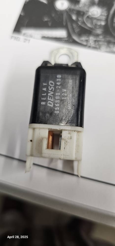

At this point would you not suspect the relay is faulty?
Using the same numbers on the old relay, check the DigiKey website for a replacement/substitute.
   / Well Im confused but happy. GC2410 blinker.
Im trying to figure out how to test it for functionaliy without putting it back on the other side. I do suspect it is bad.
