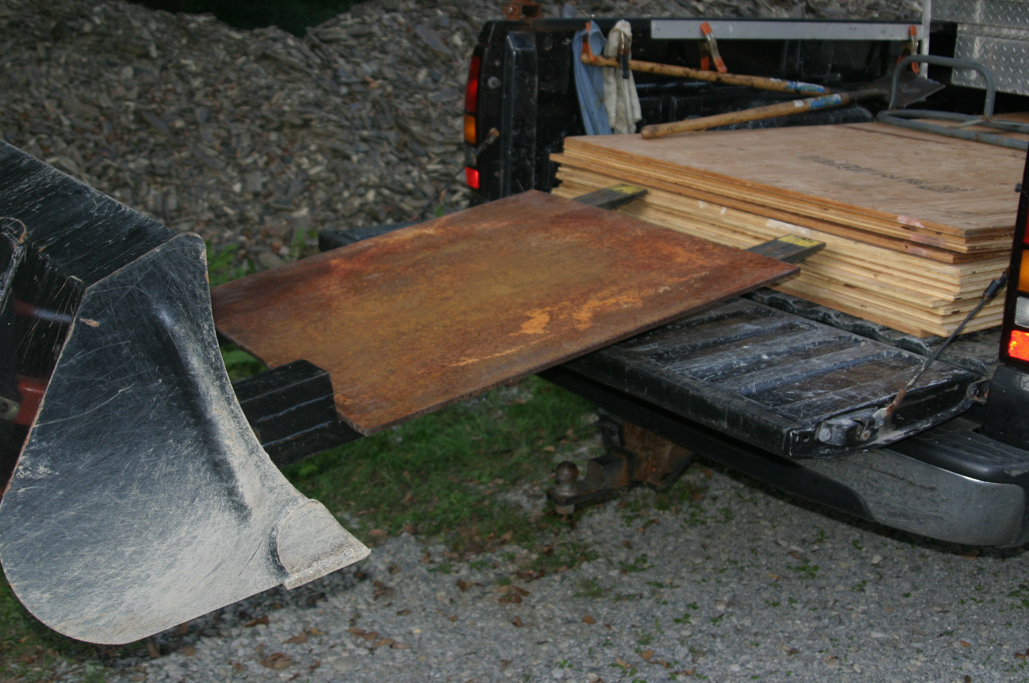

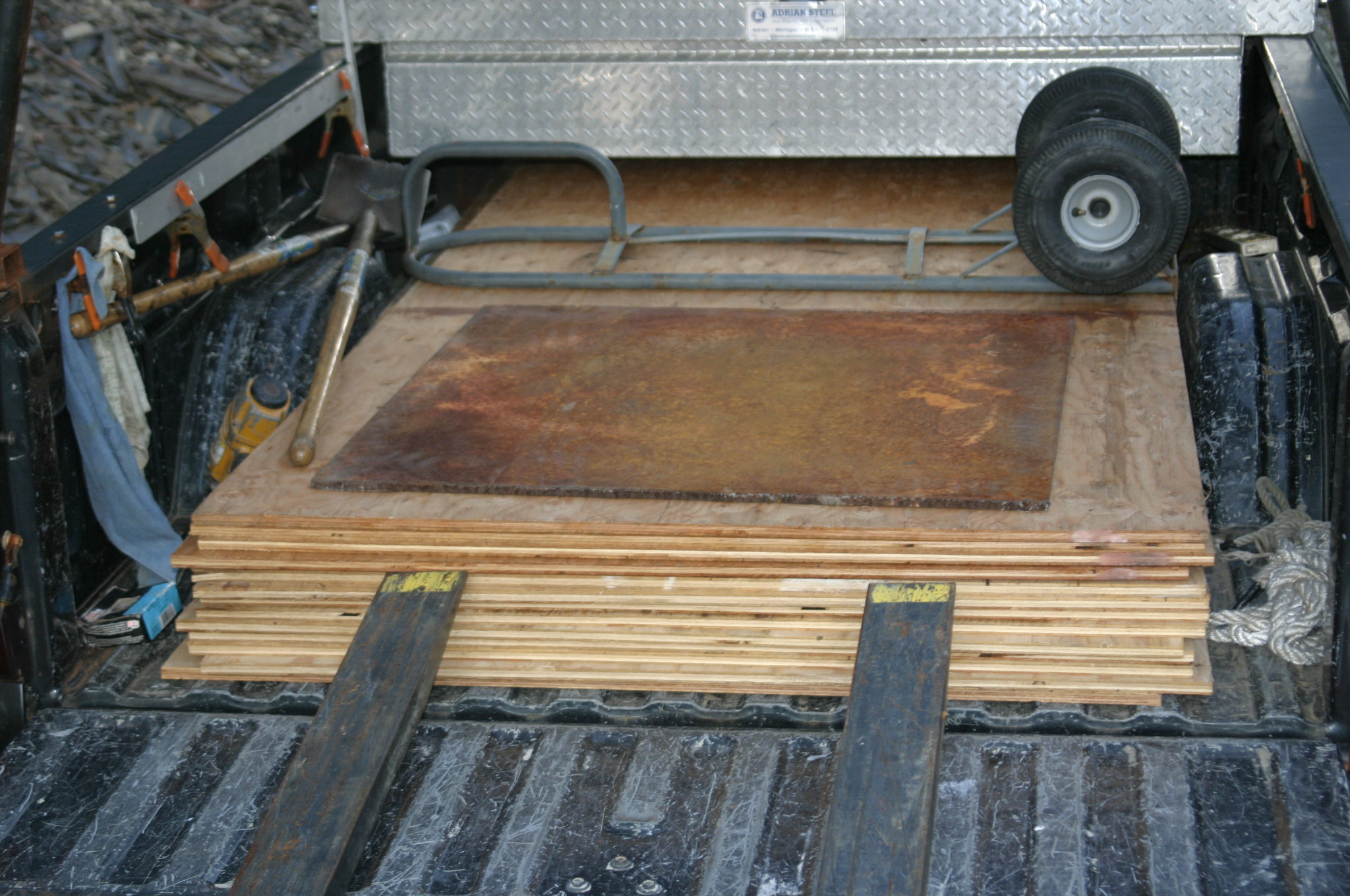

/ Welding Table #54
Got this beauty today. I was talking to a buddy about my new mig machine and needing a table top, he said, 'I just saw a piece on the job in Newark!, I'll get it for you..' I met him on the way home. I love it when a plan comes together.. :)

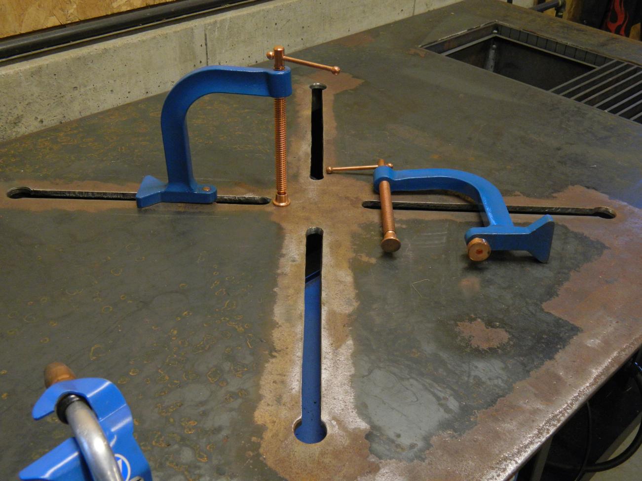

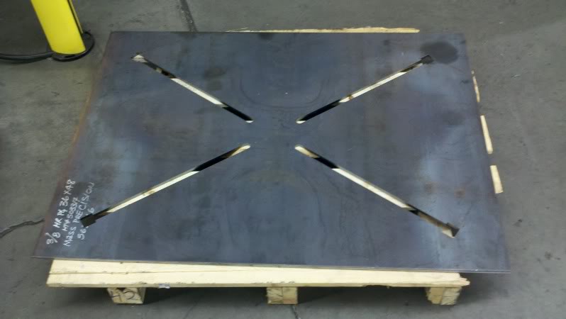

/ Welding Table #55
Add a few of these laser cuts and you're in.
