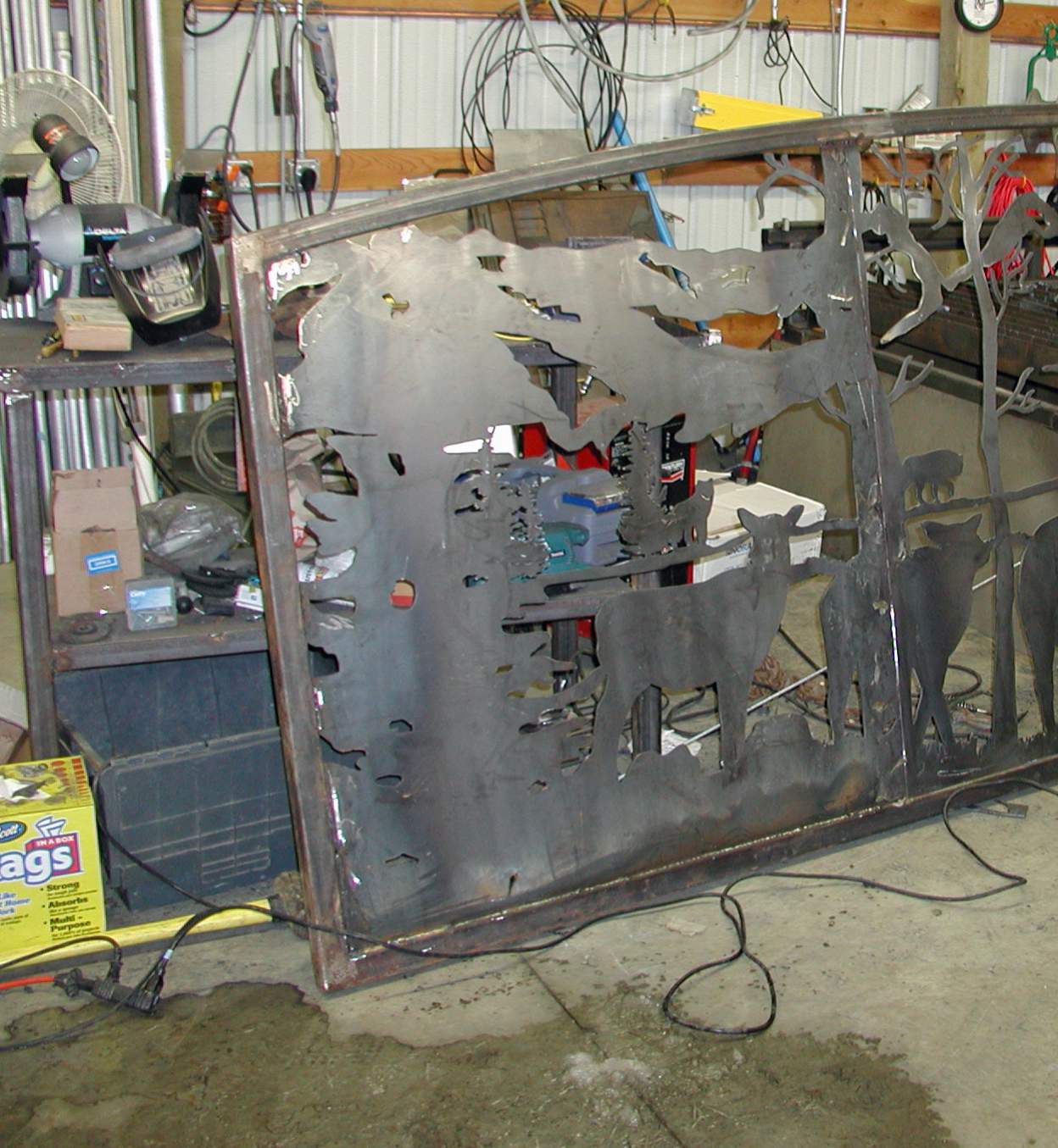

amazing this is, with the 1000's of pictures i have on this puter...none of my welding bench. go figure. heres a partial view with a gate leaning on it

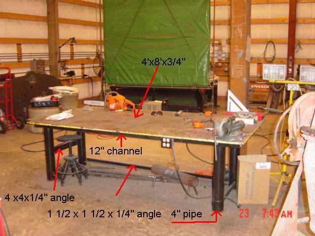

Remember guys, size matters! :laughing::laughing::laughing::laughing:
