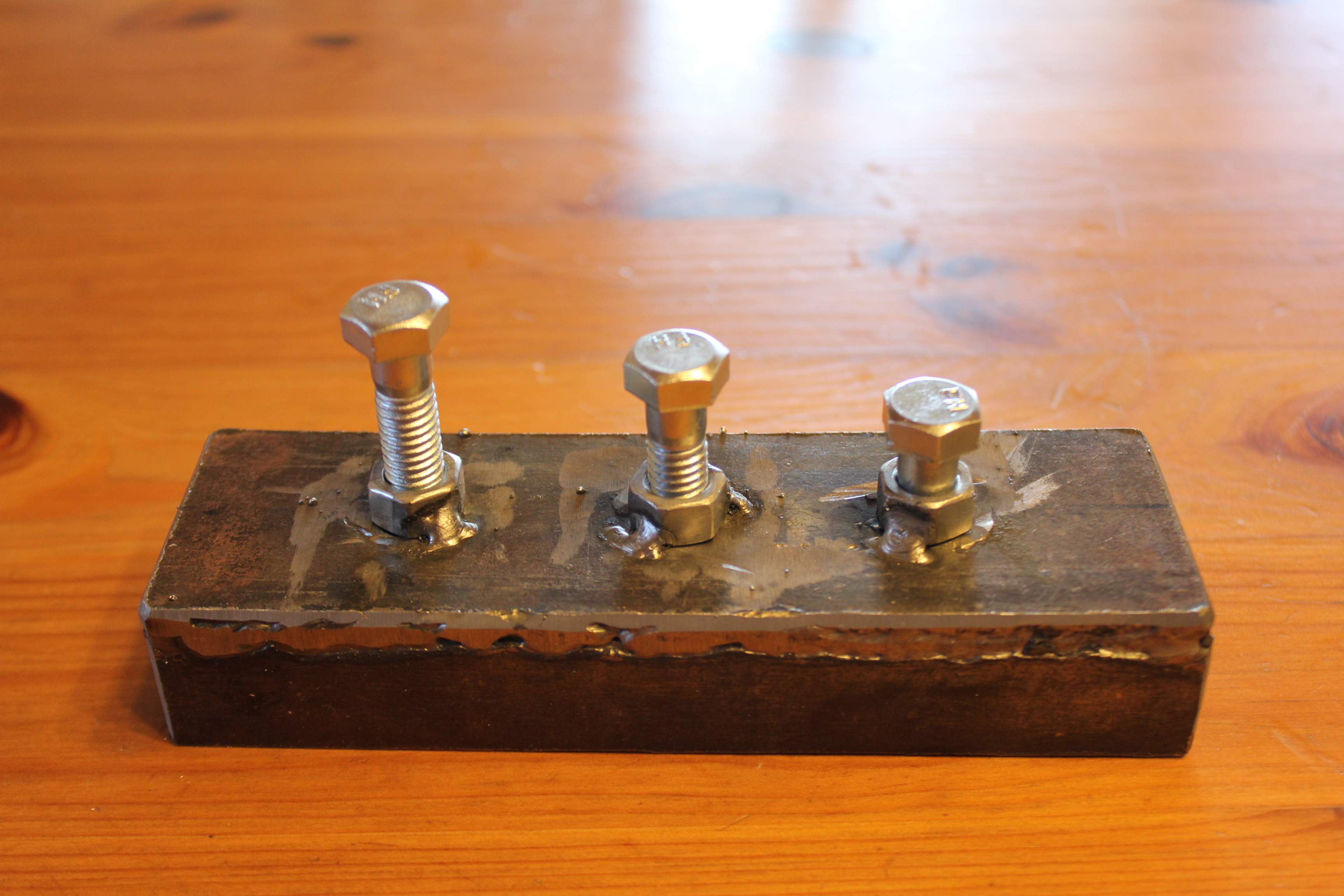

I generally use most of the previous suggestions, plus I center the bolt in the hole and put another nut on the opposite side from the welded one BEFORE welding. That way the welded nut won't pull, and the bolt should stay perpendicular to the plate. This increases the "heat sink" mass - another plus.
I'd use a TIG too, but don't have one (yet) so use wire feed. Seems to help keep warpage down compared to stick... Steve
Oops, jumped the gun after reading the first page - sorry for staying on topic :=)
