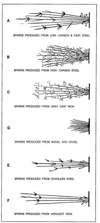

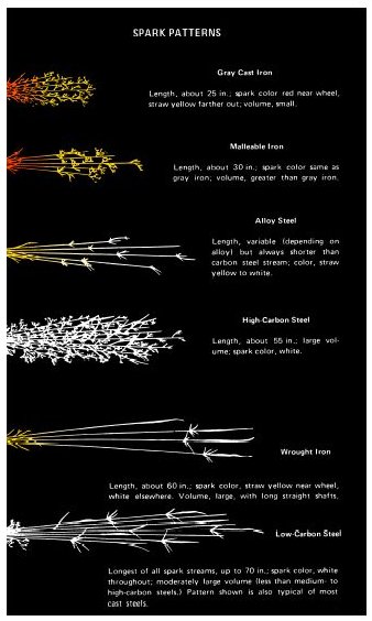

Do a spark test to confirm if the hub is in deed cast iron, or cast steel. If it is cast iron built a plate to bolt on using the lug bolts.
If it's cast steel, preheat the hub to a couple hundred degrees. Use 7018, 312 stainless steel, or Super Missie weld. When you're done welding wrap in house insulation, and let set over night.

Axle should be forged steel. Basically hot pounded into rough shape then machined where needed.
Bolting a plate on with the studs makes a lot more sense, you won't compromise the temper of the steel.
Welding can soften it or make it brittle depending on your handling post welding.

Hubs, shafts are generally 4140 HT and cast would be 4142, not very common. Commonly refer to as "Shafting". Rc about 30. Can be purchased annealed at 10 to 20. Can be heat treated to the upper 40's to low 50's Hammer hard. Not having a hardness tester you can use a file and get an approx. on the hardness. Suspect it is only in the 30's Google that and see what is recommended for welding. This is from my hard drive which is starting to fill up and give me bad info once in a while. LOL Later

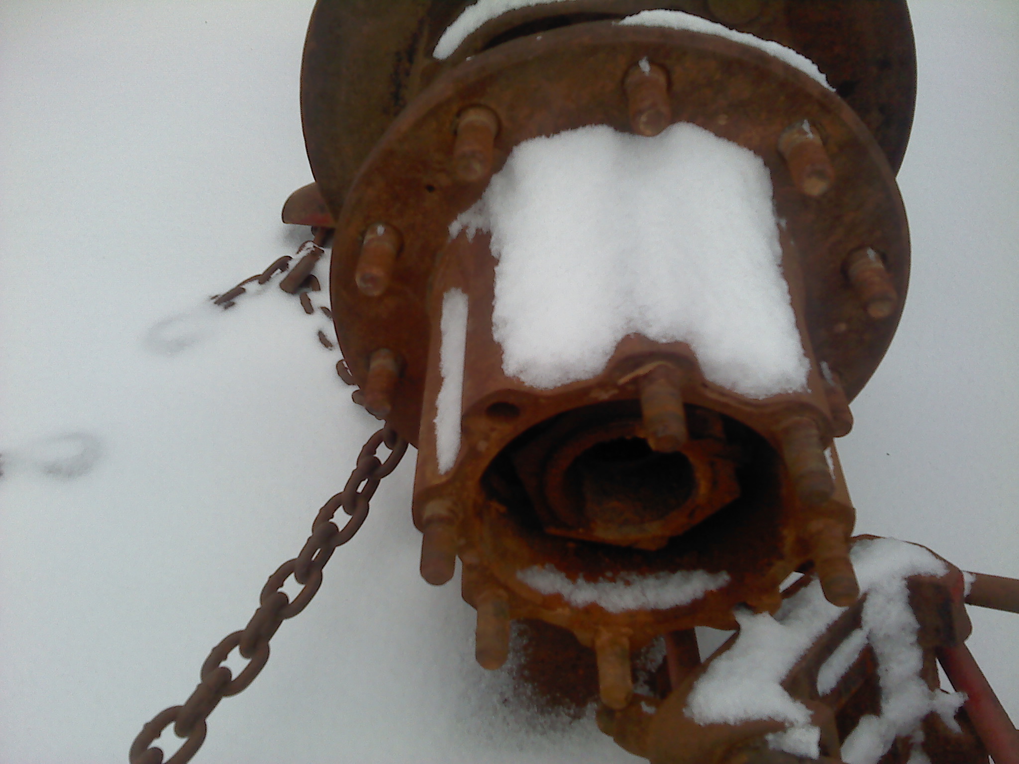

This is the hub I plan on using. The weld area would be around the lug bolts on the flat flange. I took a file to the flange and it cut pretty easily. I also used the file on a cast iron pot which seemed to be harder. Havent done the spark test, to far to run a extension cord for the grinder, and I dont feel like moving the housing to the shop today. Cold, blowing snow, metal I have to work with is outside, no fire in the shop stove, and give me a minute and I can make up some more excuses.

Your not dealing with an axle you are dealing with a wheel hub. That's a totally different animal.
It will be soft and welding on them is very tricky. I have had to weld stripped out wheel studs and most of them were cast iron.

Even though I said i would be welding to a axle hub, I thought a few folks where confused and thinking axle or axle flange. I figured the pic would clear that up. Being as its cold i have been sitting around (knapping), pondering the situation and think just making a flat plate to bolt to the hub might be my best option. It would also allow me to simply unbolt the boom for mounting and dismounting, making thinks a lot lighter to handle and easier to work on in the event the bearings or something needs worked on. I'll just use a old wheel to get the centerhole and lug pattern right and see what I can find for flat plate.
   / Welding on a rear axle hub #10
I think that is your safest route! A mechanical connection is a lot safer than an unknown welded connection.
